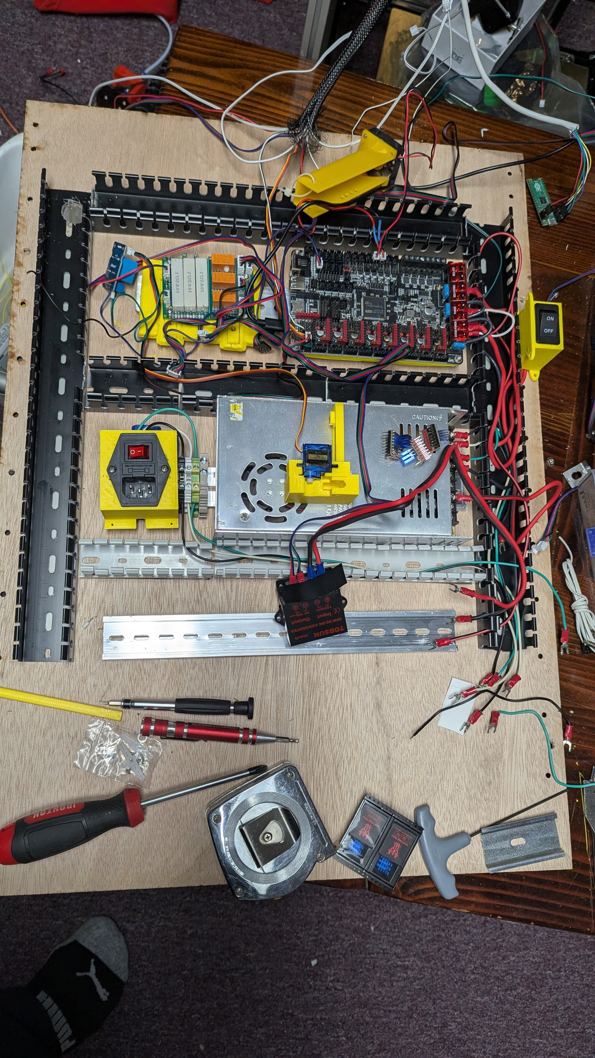

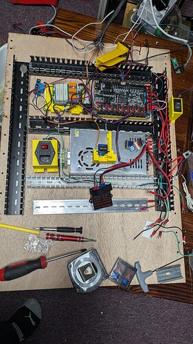

Been slowly reworking the electrical on this printer:

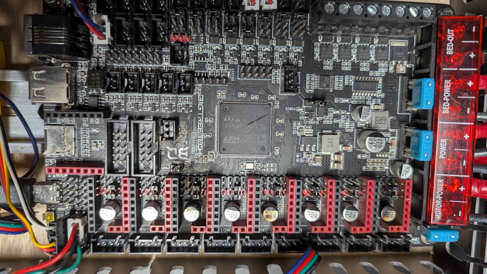

Turns out that channel 1 blew as well, so 3 of 6 channels flamed out. No obvious reason why.
Power supply is steady at 24.22V output. I had a second 24v power supply, but it is bad. The plan was to put the motors and board on a smaller amperage supply and the bed on the larger one… Octopus is bad too it appears. That is 2 boards on this printer. The first one was totally my fault. This one ran for about 2 years and then it fried the 2209 boards… Im tempted to just buy a printer. Anybody want to buy most of the parts to a v5? 300x300x400…
When the 2209s pop, what fails? Just the 2209, the 3v3 regulator on the octopus is still ok?
Printer had been unused and off for a couple weeks because I was doing home remodel and automotive stuff. On power up, the extruder 2209 (channel 5 / 6th one on 0 base board) lit up with lights and smoke. pic above in post 160. It seemed odd, so I pulled that one that was burned off and turned it on again and the 4th one (channel 3) popped the same way. I had not powered it since and ordered a couple new 2209’s. Just yesterday after removing all connections to the board including the 2209’s I noticed the channel 0 was also cooked and tried powering the board and it doesn’t respond: lights come on, but there is no USB communication. whether 24V powered or USB powered with the jumper change.

Could have been humidity. The printer lives in the basement and sometimes the dehumidifier gets shut off for noise issues.
:poop:. Sorry for your loss. Been watching and am curious what root cause(s) you discover.
Am not heavily printing, but am happily using my mp3dp v4 + Octopus, I know v5 is way faster, but my v4 has been great. Lives in conditioned space, not unconditioned Minnesota climate (capacitors affected)? Doesn’t sound like you have mains voltage Heater Bed. Got 24V Bed heater using same PSU, what PSU, a nice MeanWell with lots of wattage headroom? Been angle grinding car parts near your printer? Any suspicions about Z brake boards being a factor (my bed is smaller/lighter 250x250 1/4" alu bed + 1/4"? Not using silly high Driver current right? Did XY or Z channels blow first (i.e. gpio stopped working)? Good luck figuring out!
Great questions.
  1. 24 v heated bed. Power supply is 15 amp and is a possible suspect. It will not heat the bed reliably over 75c, so i run it at 55c for pla and 70c for petg and tpu. Prints have been fine with that, but it is probably near 90% output fully operational with tpu/petg. I built the smaller enclosed one for asa/abs. I had a smaller supply that i was going to run everything but the bed from. 15 amps should be enough to heat the bed to 100 if no other draw is on that supply.
  2. The cnc cutting aluminum is about 4 feet away and lower. Dont thing it was a shard. But you never know. Usually during metal cutting i stand between them.
  3. Basement has a single heat /cool vent in the room, but we run a humidifier year round in the basement to keep moisture content below 50%
  4. Brake board was my first suspicion, but the first driver board to fry was the B channel (channel 0 back xy motor) or the extruder channel. Im not sure which because i didnt notice the B was cooked until later. The second power on fried the z1 channel after i removing the extruder driver to see if it was just the driver went for some reason. I dont suspect the brake circuit itself. wire connections to it though are suspect.
