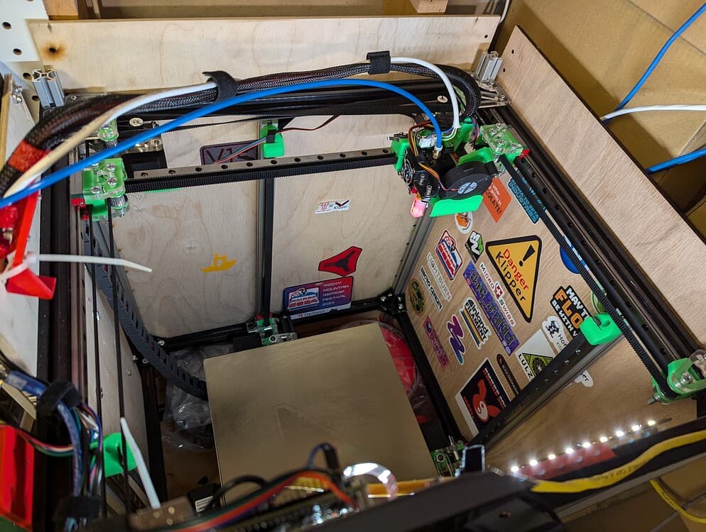

I took this photo for another answer in a different thread, but it illustrates this machine so it gets a double post:
x rail is 375 mm, Y rails are 350 mm, and z rails are 450 mm for a 295x295x400 mm print volume.
