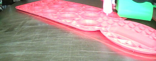

oh and that fan shroud for the part cooling is not great if PLA. It is close to the surface and it sags and then it drags and then it plows stuff up… had to “farmer” it so it doesn’t do that anymore until I can get one printed out of ABS or ASA. Need to find the right color now for the fan and the core reprint. Let the bootstrapping begin.

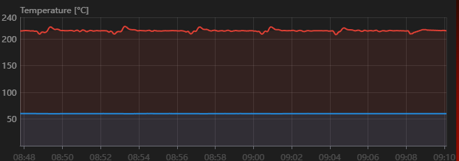

Klipper question or PID question perhaps: this hot end trend is troubling to me. what do you do to make the red trace look like the blue trace?

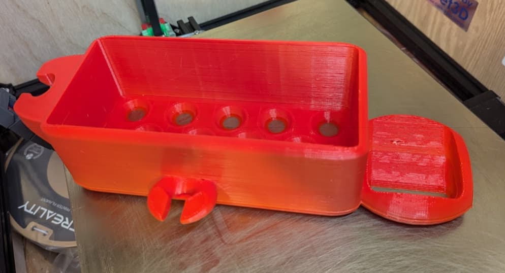

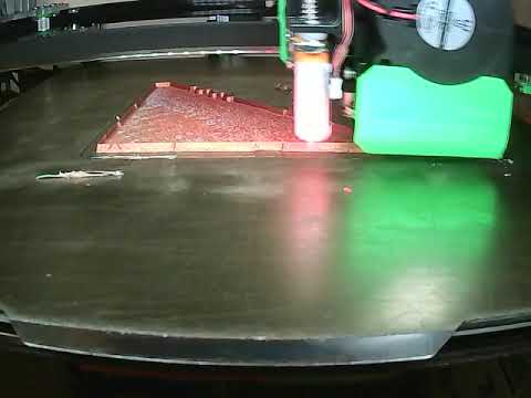

It is printing this:

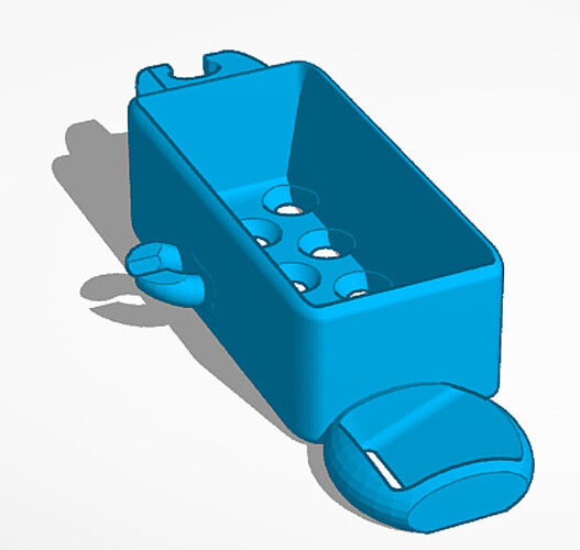

it is a shower soap, shampoo, razor, and brush holder… that I made in tinkercad to share goodwill with the printing capabilities with the family (read that however you want).
Since I have a near endless supply of adhesive we will stick the back side to the shower wall and it will hold 4 bottles of stuff. hopefully it is strong enough to take the weight and the use. Time will tell.
Did you run a pid tune on the hot end and bed?
I’ll google it and do it when this print finishes… if it does. I thought I had done it when it was a v4 and I’m using the same electronics and printer.cfg file.
Are you using KlipperScreen? If you are, you type in the target temperature and I think there is a “Calitbrate PID” button that will be on the screen.
Otherwise, from Mainsail, you execute
PID_CALIBRATE HEATER=<config_name> TARGET=<temperature>
I think you will also have to run SAVE_CONFIG to make sure it saves it.
I’m not sure if KlipperScreen will prompt you or not
I am lazy and use the web from the laptop and the screen when I’m standing in front of it.
I’ll run that command. THANKS!
the print failed. I think the core umbilical wire bundle got mangled somehow… will try again in a couple minutes.

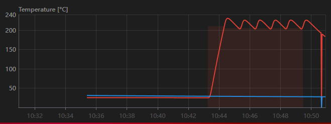

This was the command I used:
PID_CALIBRATE HEATER=extruder TARGET=210

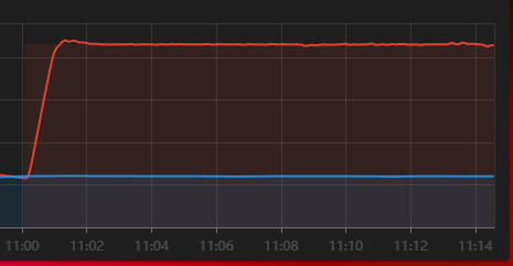

looks like this:
and I do remember doing that before. And the “save calibration” button appears at the top of the screen when on the web page next to “upload and print” button so you just click and it is done.
much better:
So not ideal:
But I’ll glue it together
in looking at the side of this thing, there are a couple large artifacts on the wall and a few gaps or zits. I’m wondering if its speed is overrunning the extruder? Not sure I can get a good pic of it. Also this cheap red filament I’m using is more like candyapple red/orange, so not great, but it should work.
so ignore the superglue seam on the right and the dirty window and road grader in the background. the “horizontal” bumps (in the picture) could be infill artifacts with 2 skin layers. The random holes are what I’m talking about.
Have you run a flow test? What extruder?
How much volumetric flow is right there in the slicer preview?
The best thing I learned when I was having problems with my Ender 3 extruder skipping steps was to limit the volumetric flow rate in the slicer to make sure it never moves too fast for what the extruder can handle.
A 0.6 nozzle with a 0.3+ layer height can run the volumetric flow rates up pretty quickly
My extruder test showed 6 mm/s with the nozzle and flow setup, which equates to about 16 mm3/s. It is an H2V2S and I ran the test with a heated extruder and a piece of tape, so I set the max flow to 15.

My question is more about characterizing those defects. Assuming the measurements are right, does that defect look like an overrun situation where it is under extruding because it can’t flow enough, or is it something else?
It is possible all the settings may not be right to fully constrain the system. If this is a flow defect, the first check is the extrusion temperature, then the slicer flow limit, the klipper config settings, and then run the racetrack test to verify.
best bet to see if it’s a max flow issue, would be to check the sliced model and see if there is, for some reason, an increase in flow at those points.
Which slicer do you use?
If you have random seams turned on and retraction at layer change, those could be underextrusion/seam artifacts.
