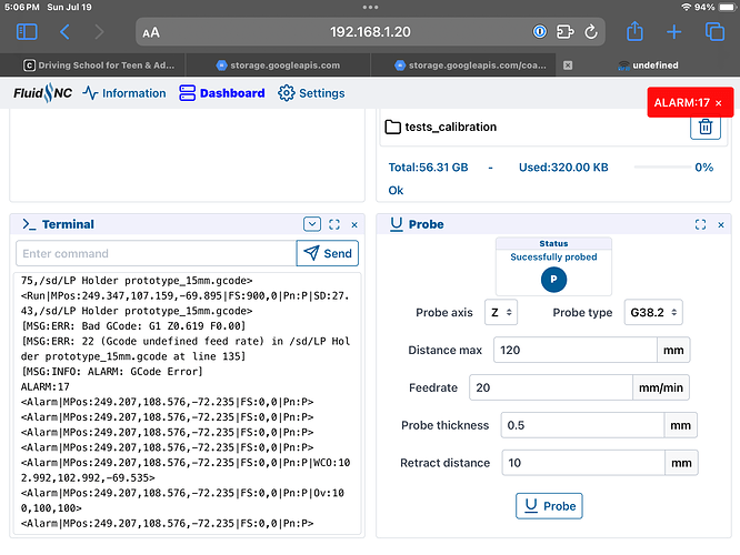

Job consistently fails with Alarm:17
Hi,
I’m having issues running a job. Every time I run it, it fails after the sixth helix cut with an Alarm:17 error. I searched the error online and I get conflicting descriptions. one source says it’s "Laser mode requires PWM output”, and another says "ExecAlarm::GCodeError” (which seems the more likely candidate since I have not lasers).
I created the gcode in FreeCAD’s CAM workbench using the same postprocessor that I have used successfully on other jobs.

I have attached the actual gcode file. It’s right around line 123 where the Alarm is triggered each time. I opened the gcode on ncviewer.com and it displays and runs as expected. I also attached the FreeCAD file and a screenshot of the terminal output shortly after the Alarm was triggered.
anyone have any ideas?

I think it might be that I didn’t define a feedrate for the drill operations (it helps to actually read the error messages :roll_eyes:). I can’t test right now, but I’ll reply whether I have success later tonight.
Missing feedrate was the problem :man_facepalming:
Looks like it’s time to create a template for Mr. Forgetful
