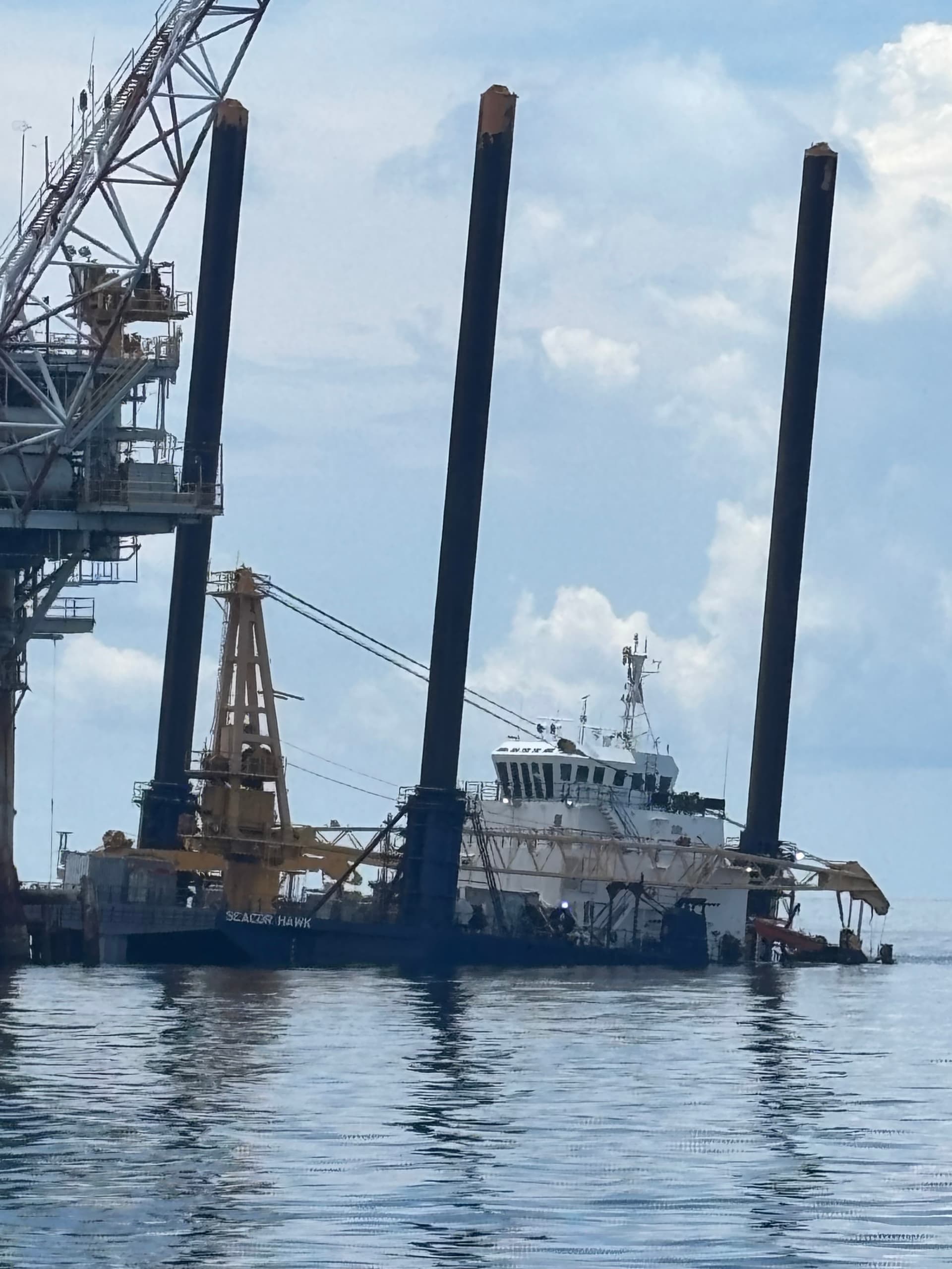

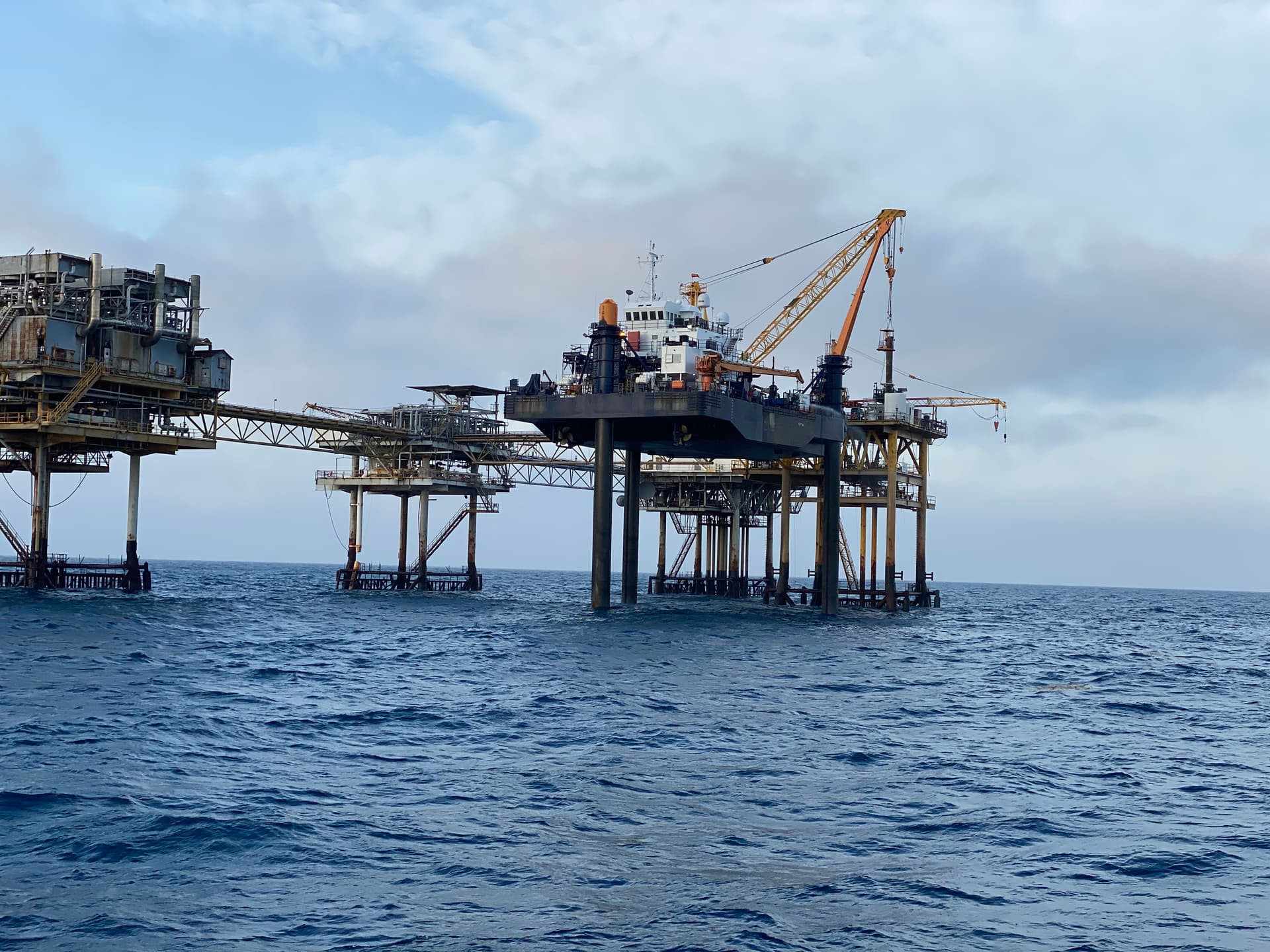

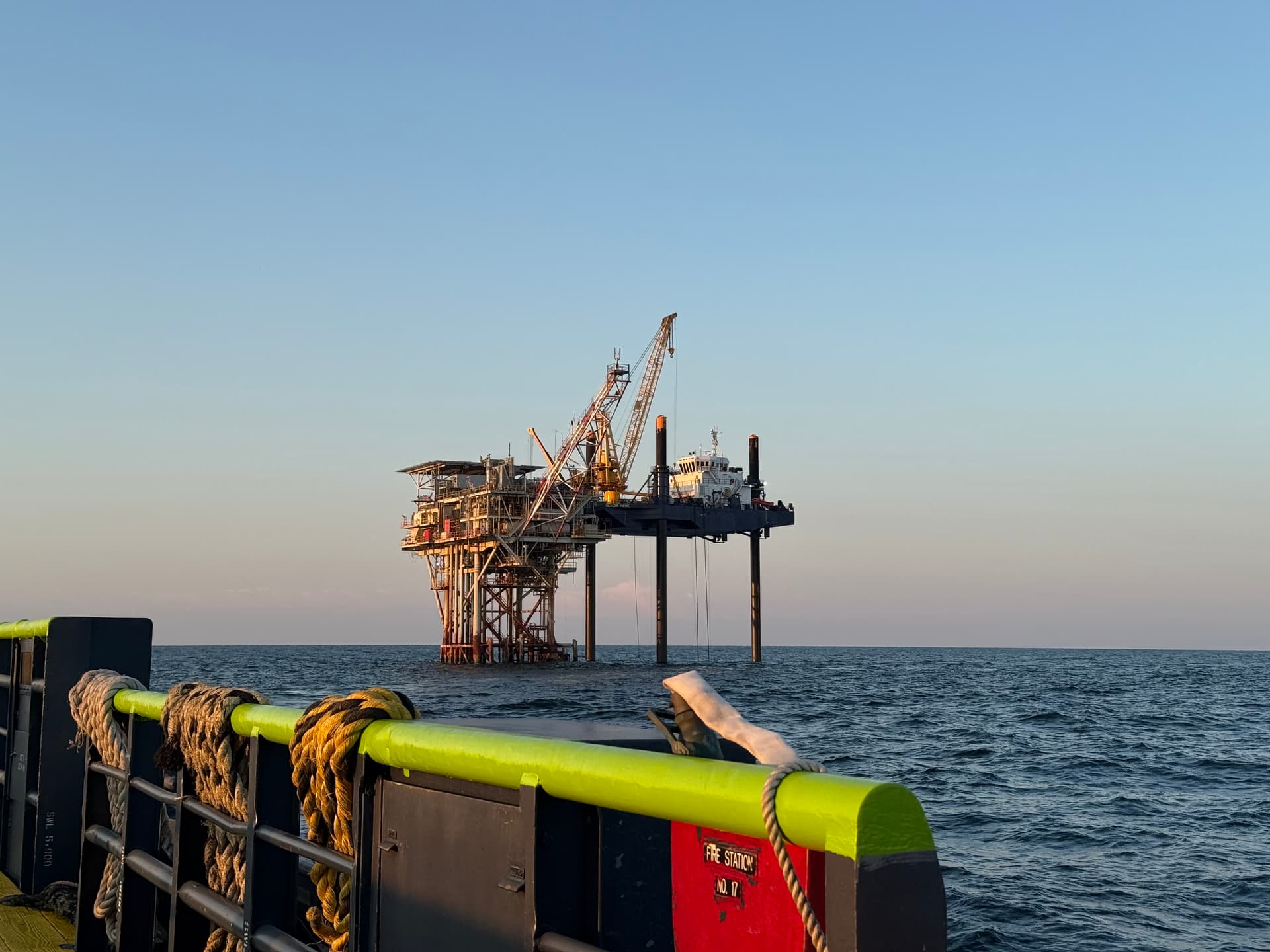

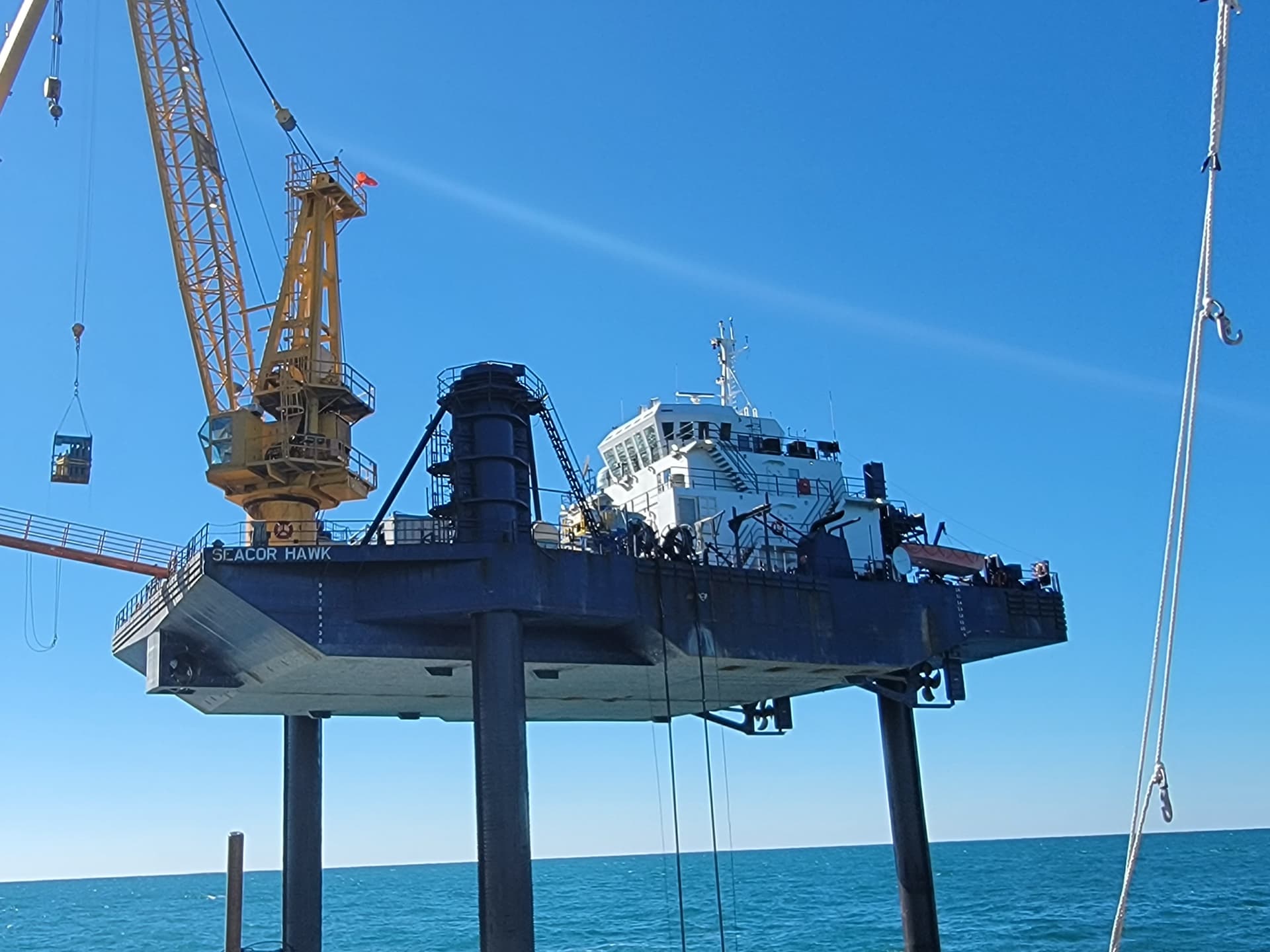

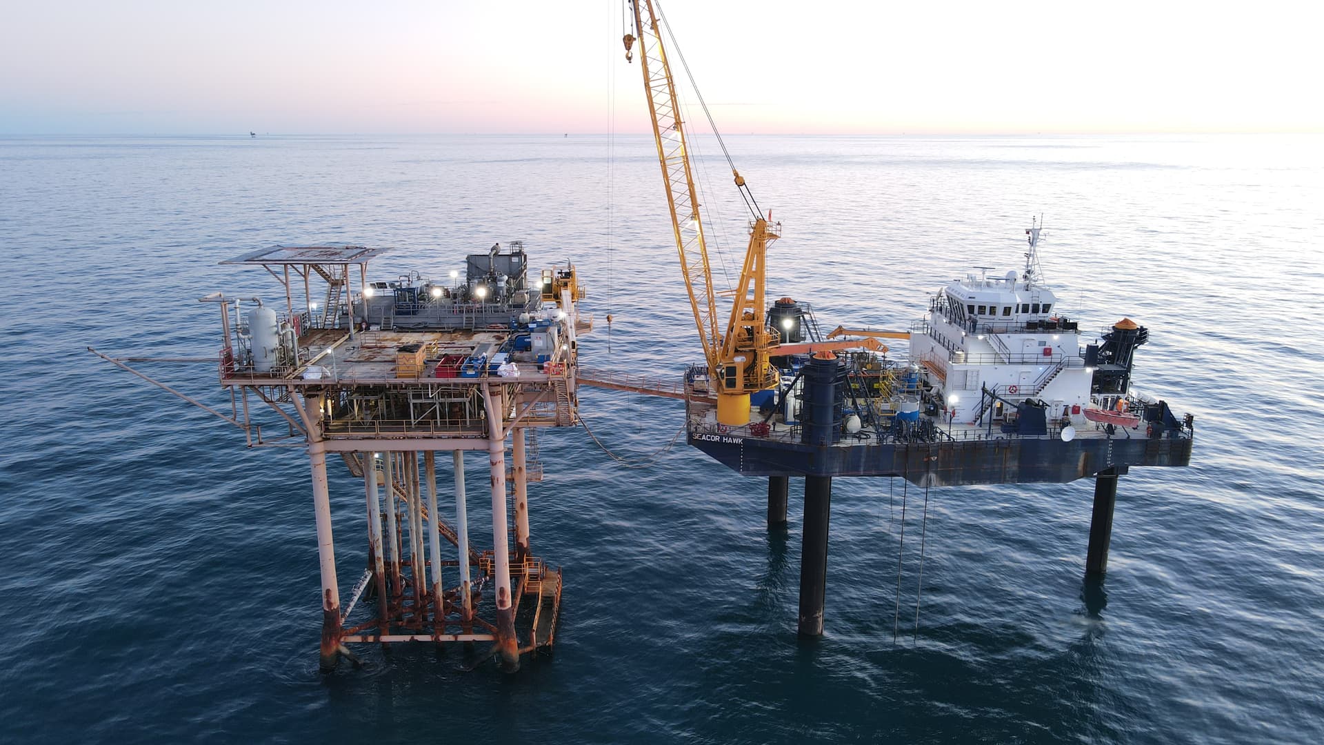

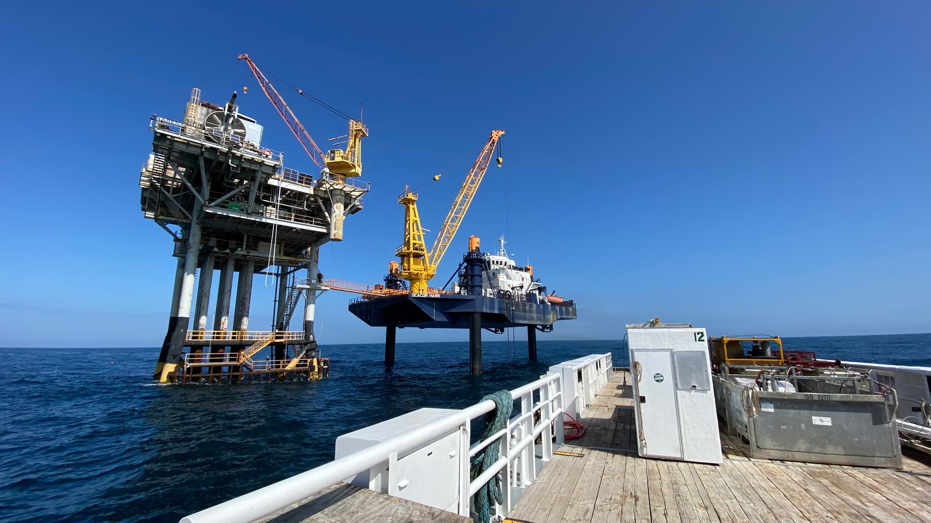

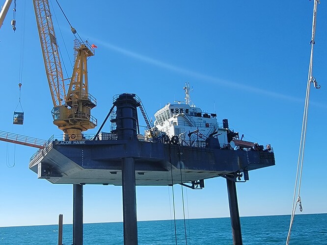

Realized its been a while since I have added anything here. Just a few random pics from the last few years…
that is just insane! glad it is you and not me, bahahahahha! My dad wanted me to join the navy like him, I told him, you know I do not do WATER!
So what happens when the pads stick in the ocean floor??? You just wait until they release?
That’s what I am doing in this photo here, pulling on the pads. I can lean the boat side to side while pulling the hull down to (or under) the water to get the max buoyancy to pull on them. We usually ride with about 4-5’ of freeboard (hull above the water) so when you pull that much more down it adds a lot of pull against the pads. Sometimes it takes a while. This boat is usually not too bad. 1-2 hrs average. But I have been on some where 5 days later they were bringing out a dive boat to jet us out. Some areas are better than others as well. Bottom type has a lot to do with it. I think in this particular pic at that location we only had about 10’ of penetration. Sometimes we can get 20-30’ or more.
That machine blows my mind.
For being 95’ wide, 145’ long and weighs around 2100LT (4.7 million pounds) and we park it within feet of things all the time without any kind of Dynamic Positioning in all kinds of different winds/seas/currents. I will say that having brakes (Legs/pads) helps a ton :rofl: but still takes a fair amount of skill as well.
