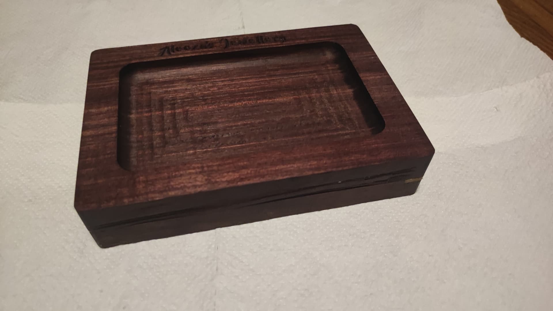

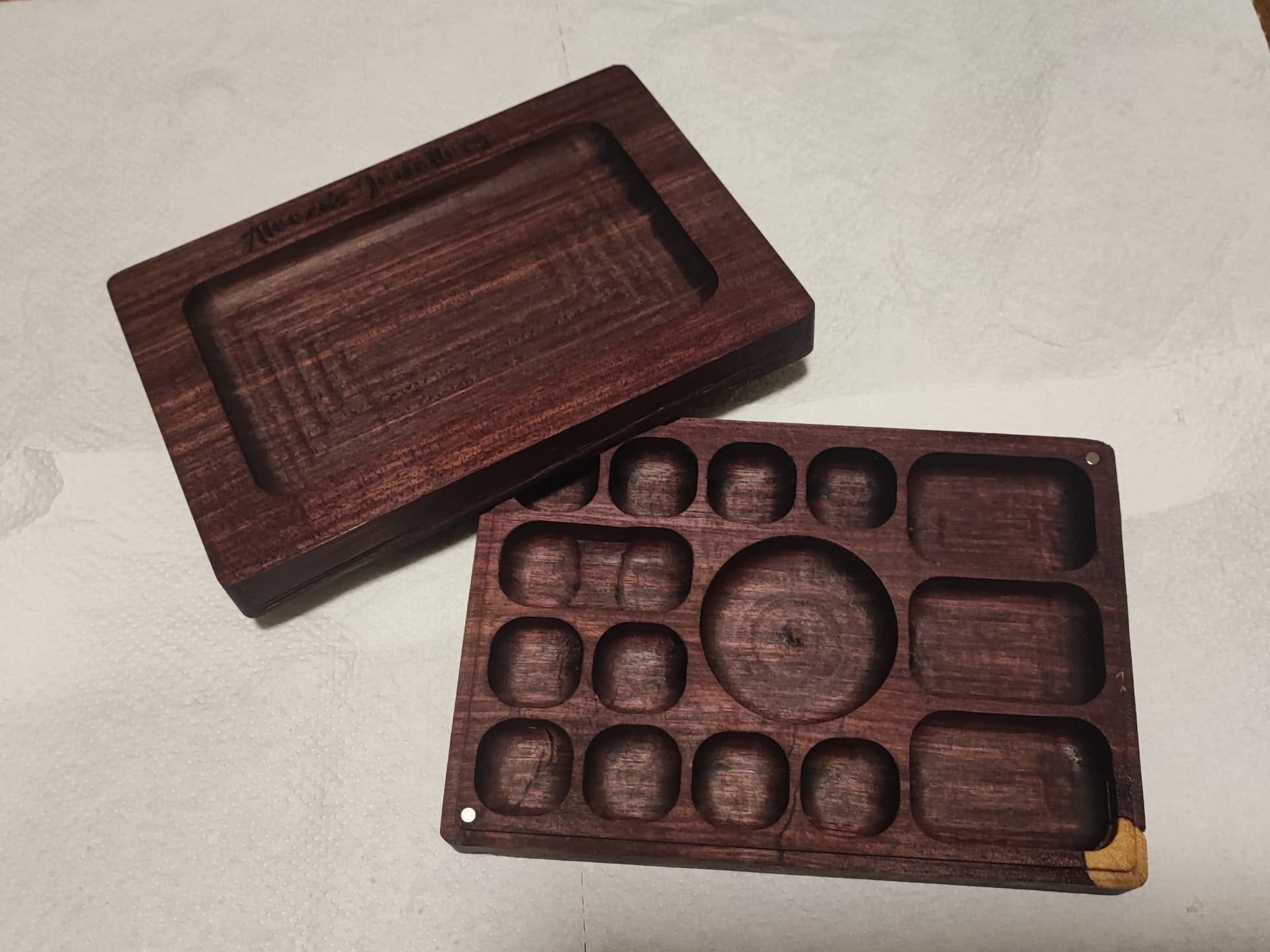

The box for this year’s secret Santa was a jewellery box with two tiers. Top tier is for storing the jewellery that’s in high rotation or you want to show off, bottom tier is held by magnets and is for storing rings, necklaces and other trinkets.

Slick, I like the show-off lid area. Really cool.
Nice! :slight_smile:
Small suggestion: I would have used the magnets to make the top lid reversible, this way you can either fully close the box, or have a display area

Anyway, how one rid of those marks on wood? I know they are not there, but how to change this optical illusion?
Doesn’t work, it’s recessed so it doesn’t move. :slightly_smiling_face:
No, those are actually there. It’s the bowl endmill that has a pretty large radius. Would need to set lower stepover but like the look.
The PNC is so straight there aren’t any markings at all if I don’t want them to be there.
