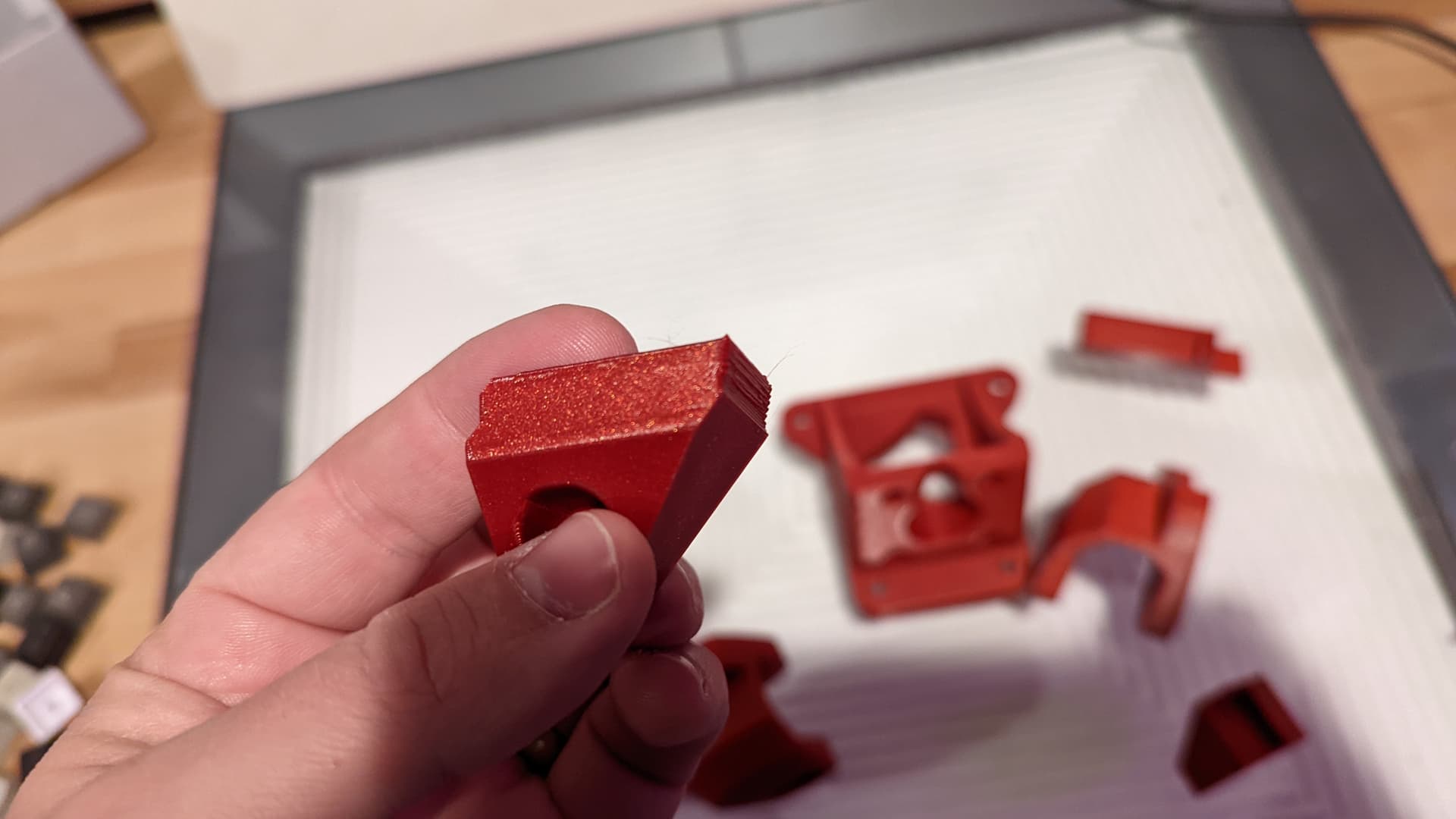

I have a lot of the little parts printed. I just started the left plate.
These all printed great. There is some trouble on overhangs where the layers are small, but totally functional.
I can change the angle of that endstop holder for sure.
