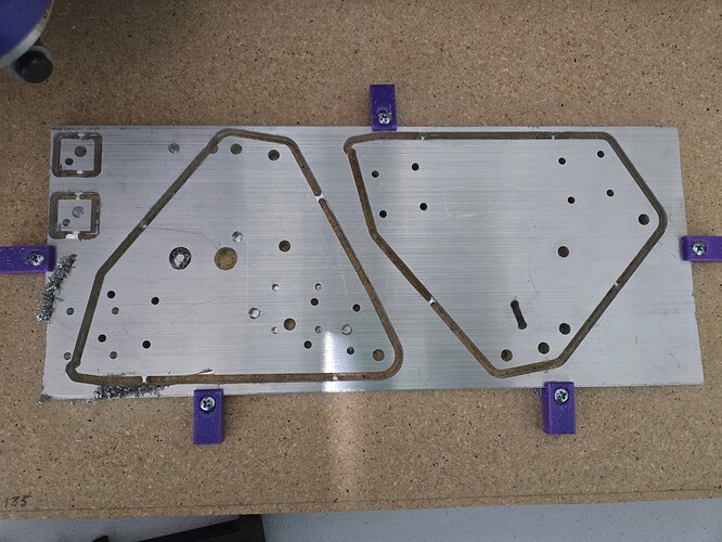

I haven’t yet cut any wood or MDF so I thought why not just jump into aluminum and cut some XZ plates? It can’t be that bad, right?
Oh, by the way, this is also the first time I’m using the Kobalt.
Well… (warning: loud)

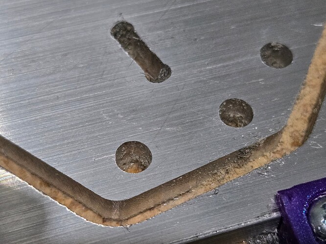

Ultimately the workpiece shifted on me, which is what made me stop the job, but it was making what seemed to be “unhappy” noises. The M5 holes are not large enough for an M5 bolt to fit. The M3 holes are large enough for a M3 screw, but that’s not saying much since the endmill is 1/8".
The bit I was using was a random old bit that I found on my workbench. After this unsuccessful result, I decided to take a look under the microscope:
Yikes!
Also the workpiece was hotter than I expected, so I think a combination of spindle too fast, feed too slow, and most of all a dull endmill is the reason for the outcome. A sharp endmill may have been able to succeed with sub-optimal parameters in other areas but this endmill is toast.

You really need to make sure that you are getting good chip clearing when working with aluminum, otherwise the re-cutting of the chips will end up welding the aluminum to your end mill (which I’m pretty sure has happened to your used endmill, based on the photo).
Air/IPA Mist system and Trochoidal make aluminum cutting much easier IMO…
In my projects I insert a pause in g-code at the end of cutting the screw holes, put some wood screws through those holes to secure it to the spoil board, then hit Resume. No chance of the work piece shifting…

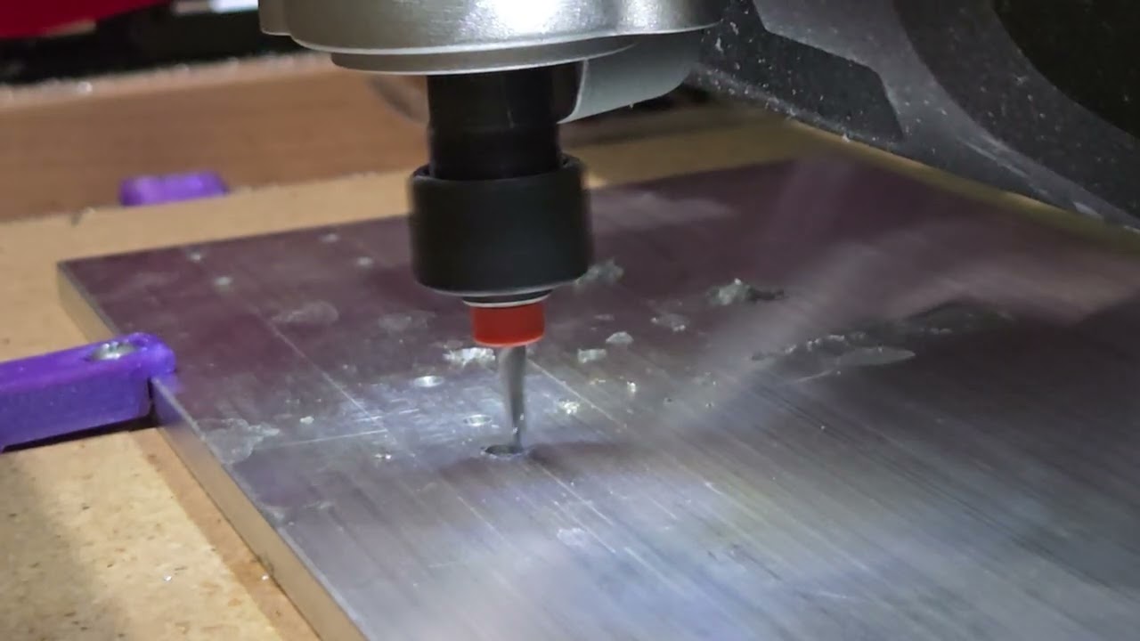

Second try, test piece.
Much better, and M5 bolt clears the 5.3 mm hole (previously didn’t).

I thought I had some 1/16" 1/8" shank endmills, but I broke the one in the V1 variety pack. I bought one with a 1/4" shank though, I just need to change the collet, and I need a new spray bottle for IPA before I cut the aluminium.
Kind of tempted to just cut the XZ with a 1/8" endmill, maybe leave the belt slot for later.
