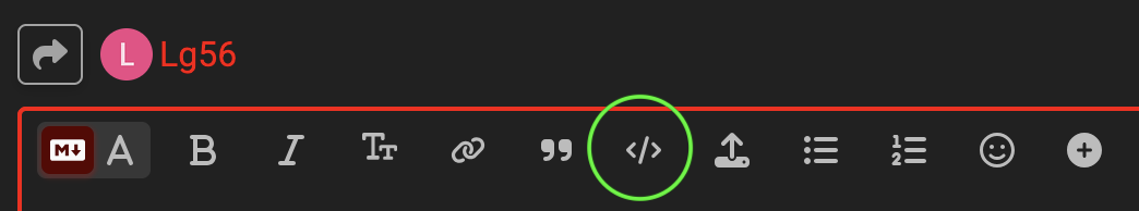

When. you are pasting it into the reply, you should highlight all of the text and change it to be preformatted text. It’s the icon on the forum topic editor that looks like this: </>
I use dark mode, but your toolbar should look something like that below:
