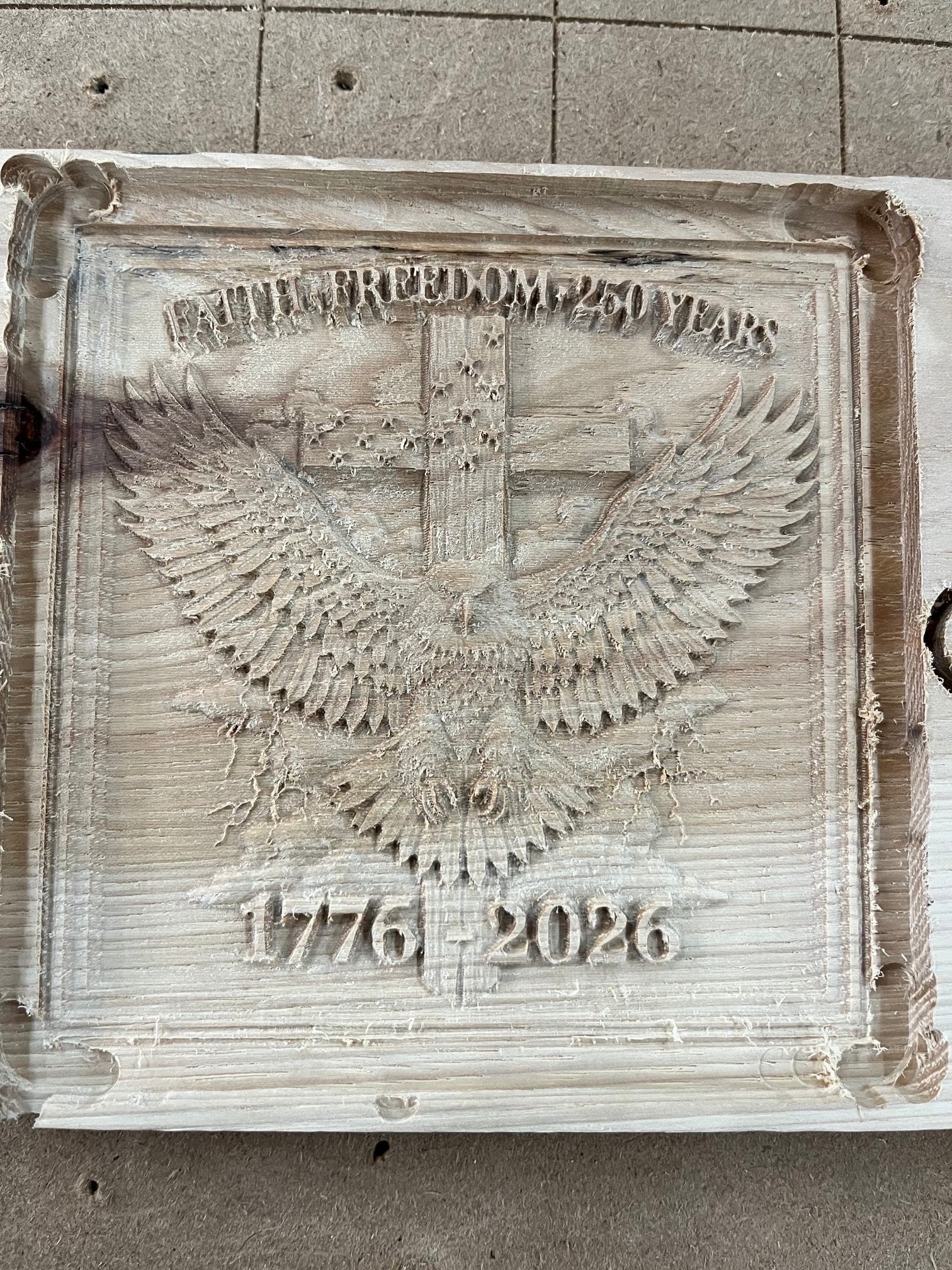

Everything is working today! No having to reprogram everything on day 2.
Even did a few test cuts with no issues.
Now to finish and cleanup this eagle and make a few…
