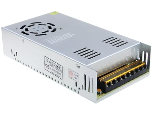

Thinking about a Laser Tree 80W/10W module. Do y’all power it from the Jackpot’s power supply and run the power through the board, or do you use a separate power supply for the laser and just do PWM from the Jackpot?
I have this power supply. I connect both the laser and Jackpot to it.
I connect the PWM to the Jackpot.
powersupply
You can use separate power supplies but you must connect the grounds of both together.
