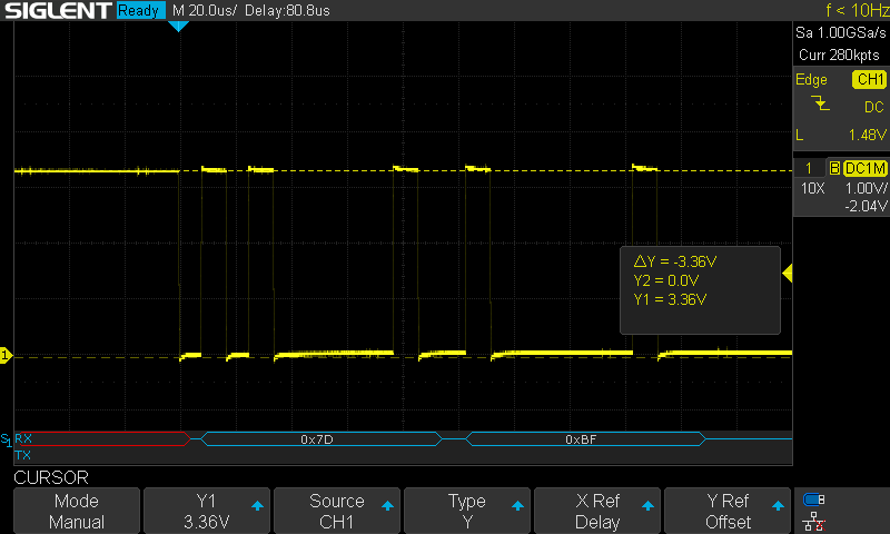

More debugging. I just soldered in a 1k ohm pull up from 3v3 to GPIO_0. This seems to have solved the issue. I also just scoped the GPIO_0 and it looks like the UART data is still clean goes from 3v3 to 0v with clean edges.
I think this solves the problem for me…

@The_Digital_1 - would you mind sharing the scope shots of the GPIO_0 on your fixed board?
If you’re feeling really ambitious and are good at soldering, could you pull your added pullup, and get a “before” scope shot?
Sure thing. Just a sec.

(No pull up scope shot attached.)
OK so the scope just revealed another clue.
The GPIO is nicely sitting high at 3.3v even without the pull up. I can hit the reset button and its still at 3v3. It’s not until I actively open the com port, does it go down to 0.43v. With the 1k PU to 3v3. It comes up to 2.9V in that case where the com port is opened.
(1k pull up to 3v3 attached)

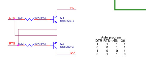

Another clue. There seems to be some interaction with RTS and DTR. If i use realterm app where i can set and clear those. I can cause or clear repro. However those settings are not available in Universal Gcode Sender as far as i can tell.
With ESP32 unplugged from Jackpot:
No repro (Boot pin high) RTS =1, DTR =1
No repro (Boot pin high) RTS =0, DTR =0
Boot low, board held in reset RTS =1, DTR =0
Repro (Boot pin low) RTS =0, DTR =1
I believe that is all normal and to be expected. That’s how flashing tools reset and put the ESP32 into bootloader mode.
Here is where it gets weird though. With the ESP32 plugged into the Jackpot board:
Repro (Boot pin low) RTS =1, DTR =1
DTR_RTS_ESP32_Circuit
I did some more digging. Yeah if you look at the dev it schematic for the ESP32. You see DTR&RTS=1, and DTR&RTS=0 should both result in EN & IO0 = 1.
However what happens on the Jackpot board is because IO0 is loaded down with IO4, and the “ST_UART” net. The IO0 falls under the threshold to be considered high, and the device goes into bootloader when reset.
Funny enough this does not happen when RTS =0, DTR =0. This can be explained because keep in mind RTS or DTR when set e.g =1, that actually sets the DTR or RTS line low respectively. i.e. its active low. Thus when RTS and DTR are “cleared” i.e. =0 their actual nets are high. So what happens on the Jackpot board is when IO_0 starts to fall lower than threshold of Q2 BJT, the BJT starts to turn on which pulls the IO0 net up never allowing it to fall below the “Boot” threshold for the ESP32.
Anyways… that’s just my analysis. Let me know if you think this is wrong.

The diagram you printed is not actually complete, as shown it is not possible to get a situation where both RTS and DTR nets are both low, what is not shown is a capacitor and resistor network that introduces a time constant to the switching allowing for the correct sequence to signal the uP to enter bootloader mode. see usb - ESP32 Dev Board DTR/RTS - Electrical Engineering Stack Exchange
The DTR/RTS interaction has historically been a problem for CLONE boards manifesting itself in having to manually control RTS and DTS to force bootloader mode. It was never a problem (AFAIK) for genuine espressif boards.
The DTS/RTS interaction only happens at the instant of power up (or very close to it)… why is there comms over the UART at that time? Perhaps the easiest ‘cure’ would be to delay comms for a second or two.
