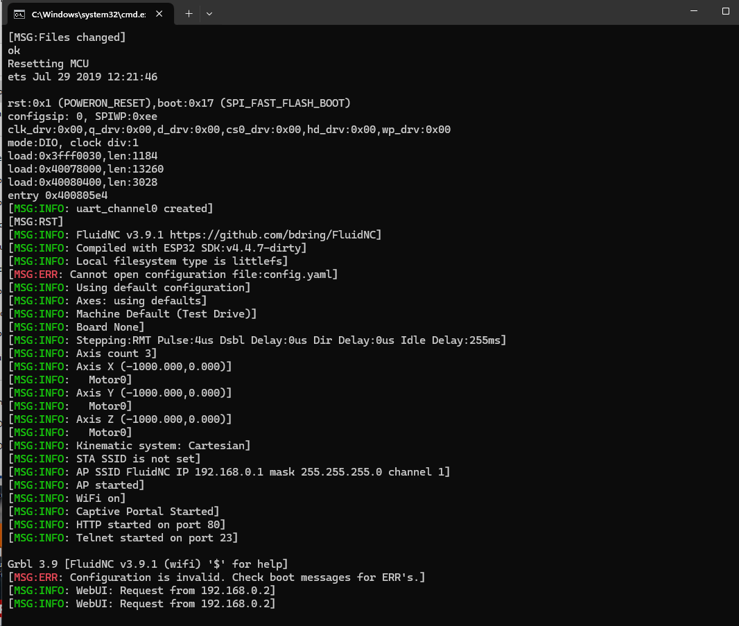

I poked this a bit and the page you are seeing means that the index.html.gz file is not loaded on the flash (local) filesystem. You also can’t use that page to upload the file.
The easiest way for you do this is probably to connect via installer.fluidnc.com. Alternatively, you can use FluidTerm. The Ctrl + U keyboard shortcut will allow you to upload files.

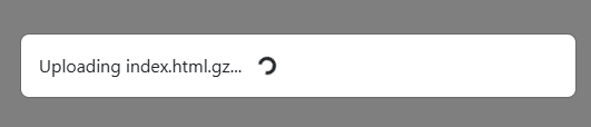

There you can click the “Upload” button to upload files. Upload the index.html.gz file linked above.
I will note that the first time I tried to upload it, it hung on the screenshot above and was then a 0 byte file. If that happens, reconnect and try again.

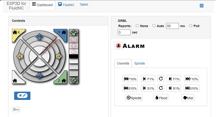

Once that is uploaded, you should be able to connect to the FluidNC network and see the WebUI. (Mine is showing an alarm because I don’t have a config.yaml file uploaded to this test ESP32).

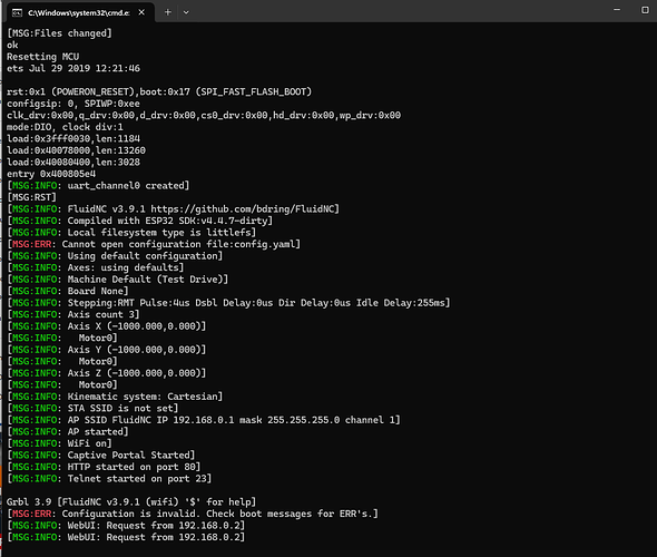

I loaded the v3.9.1 back on as suggested
Yep, did as you said, i have the controller back but i have the same error.
have no controls.
tried loading the Conf.yaml as you suggested in the first post but didnt fix the issue.
Config.yaml uploaded and error has gone, but no movement on cnc. commands are being sent without errors just no action?

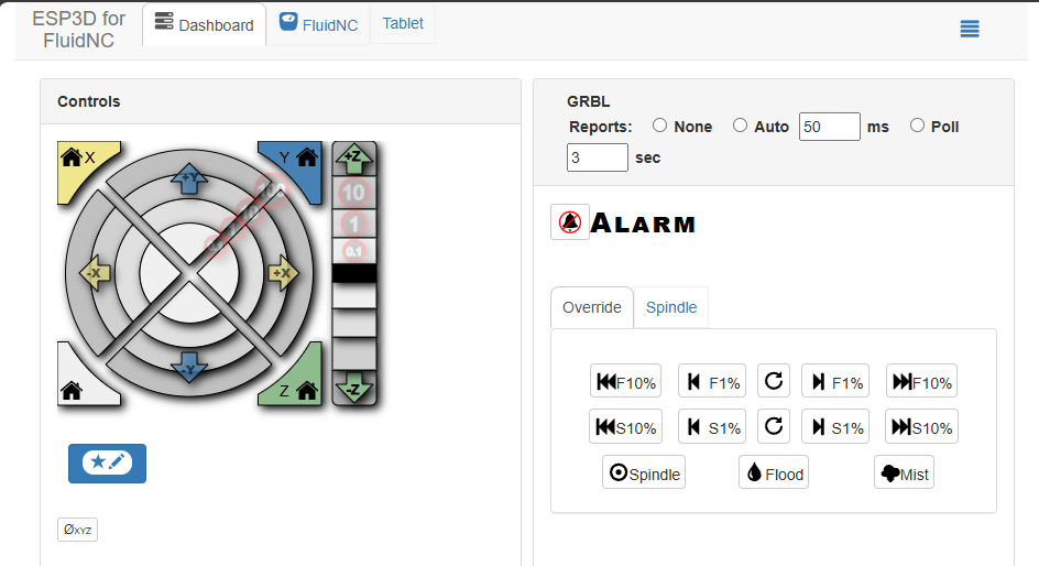

How are you sending commands? Did you get the WebUI loaded?
I also want to note that just because it shows the driver tests pass doesn’t necessarily mean your wiring is correct. It’s just that the Jackpot can communicate with the drivers. It can show that even if the stepper motors are not connected at all.
Yes the WebUI is loaded and im sending them through it. i have checked the wiring before i had all these issues and it is correct, no signal is getting to the steppers
What exactly are you sending?
I’m still not confident your wiring is correct.
Do you have the USB cable plugged in? If so, unplug it and restart the Jackpot. The drivers won’t load if the USB cable is plugged in before you power up the Jackpot.
I reloaded the FLuidNC through the web installer and its working. FINALLY.
