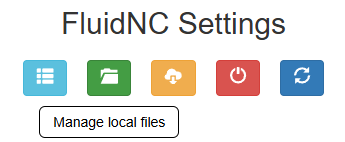

Go to the FluidNC tab:

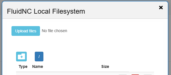

Click the green “Manage local files” button:
Upload the files here:
It will overwrite the existing file.

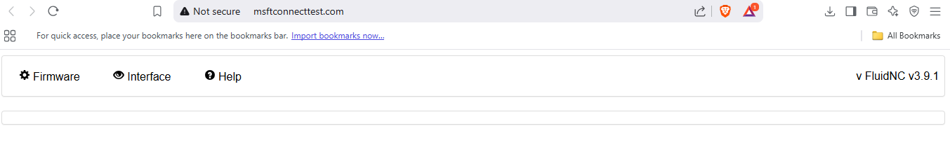

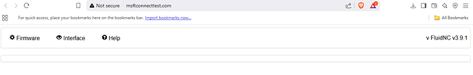

I think i stuffed up. I cant get access to my controller at all now. when i try i get this
then if i press firmware or interface i get
Site cannot be reached
please help

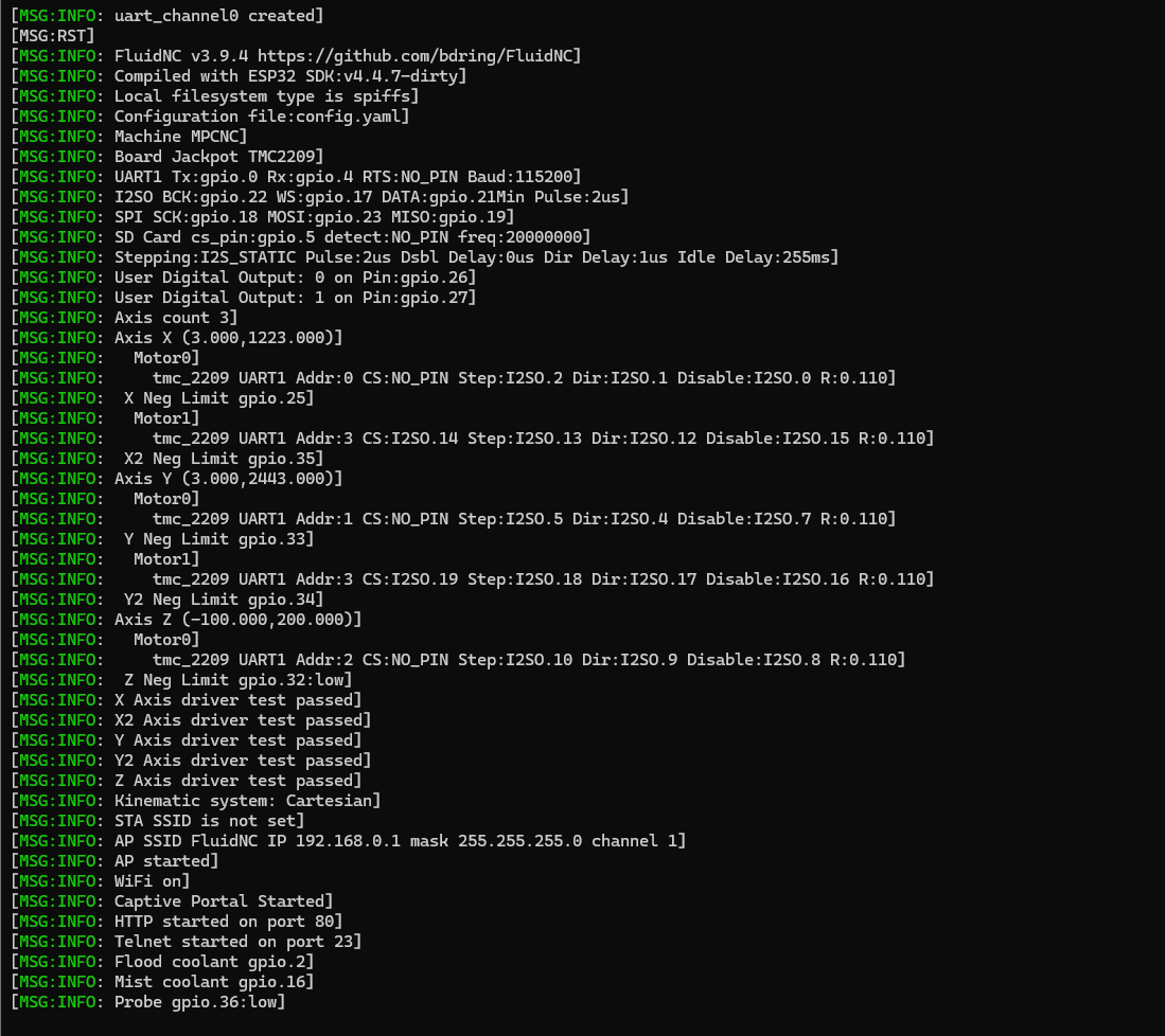

Can you attach a USB cable and connect with FluidTerm? We want to see the log of messages from boot up.

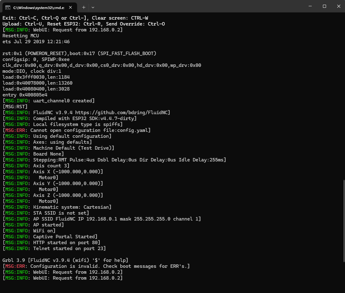

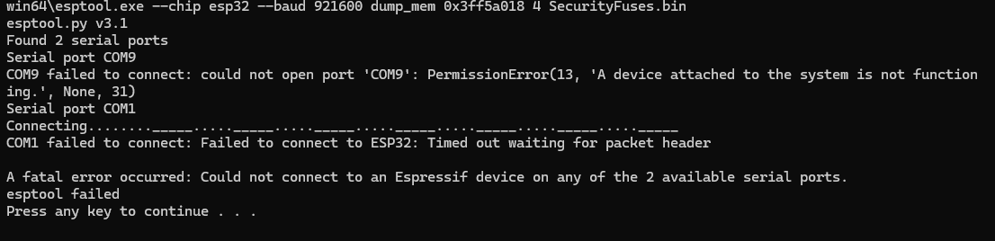

Tried running Fluidterm.
my com port is comport 9 and it come with this message
That looks more like the installer output than FluidTerm to me.

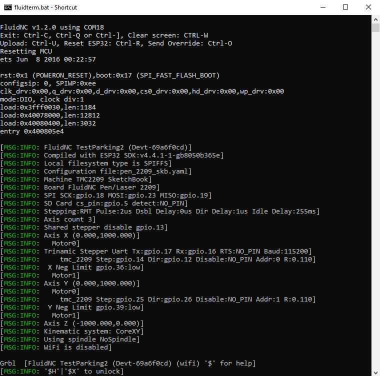

Are you launching fluidterm.bat?
It should look something like this:

Looking at your FluidTerm output, I see FluidNC v3.9.4 which implies you also updated the FluidNC firmware? This should work but the current V1 recommended version is 3.9.1.
If you did update the firmware, did you do a clean install or an upgrade?
Again unsure what i did. Just followed the links and clicked away. Sorry im most probably your worse nightmare.
