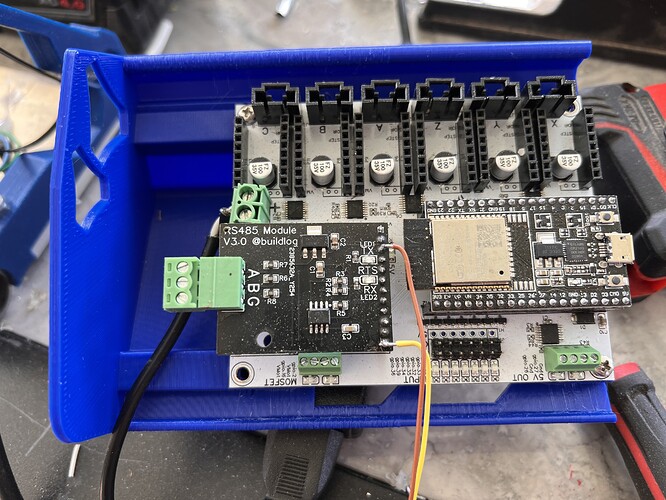

Another thing to think about here (at least in my use case) is on my full sheet machine im already using the expansion port for a RS45 (i think thats it) card to hopefully set up spindle control once i get it all put back together. I also have another card like that to put on my smaller machine for its VFD as well. So Im not sure that having the second ESP32 in the expansion slot would work out for my use case. But I will for sure help in any way with the testing or info that i can. It will be a while before i mess with spindle control on the smaller machine. It will be running the Kobalt (If it ever shows up) for a while i think.
Pic of where im getting power on the jackpot for the full sheet machine. I’m using the same spot on the small machine but no card in it yet. So its just DuPont wires into the correct ports on the header

So the ESP32 WLED expansion card should also provide for something like RS485 out to a spindle. Probably still possible because it looks like there are two available UARTs on GPIO 12-15. I guess it’s time to take a peek at the design of that RS485 module to see how it’s designed.

If you could get both in one card that would be AWESOME for my use case. Not sure how many others would make use of the RS485 since the majority run routers.
