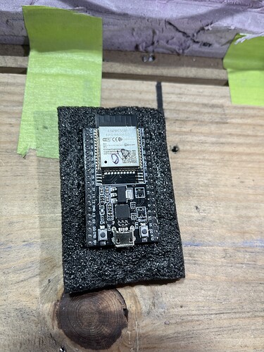

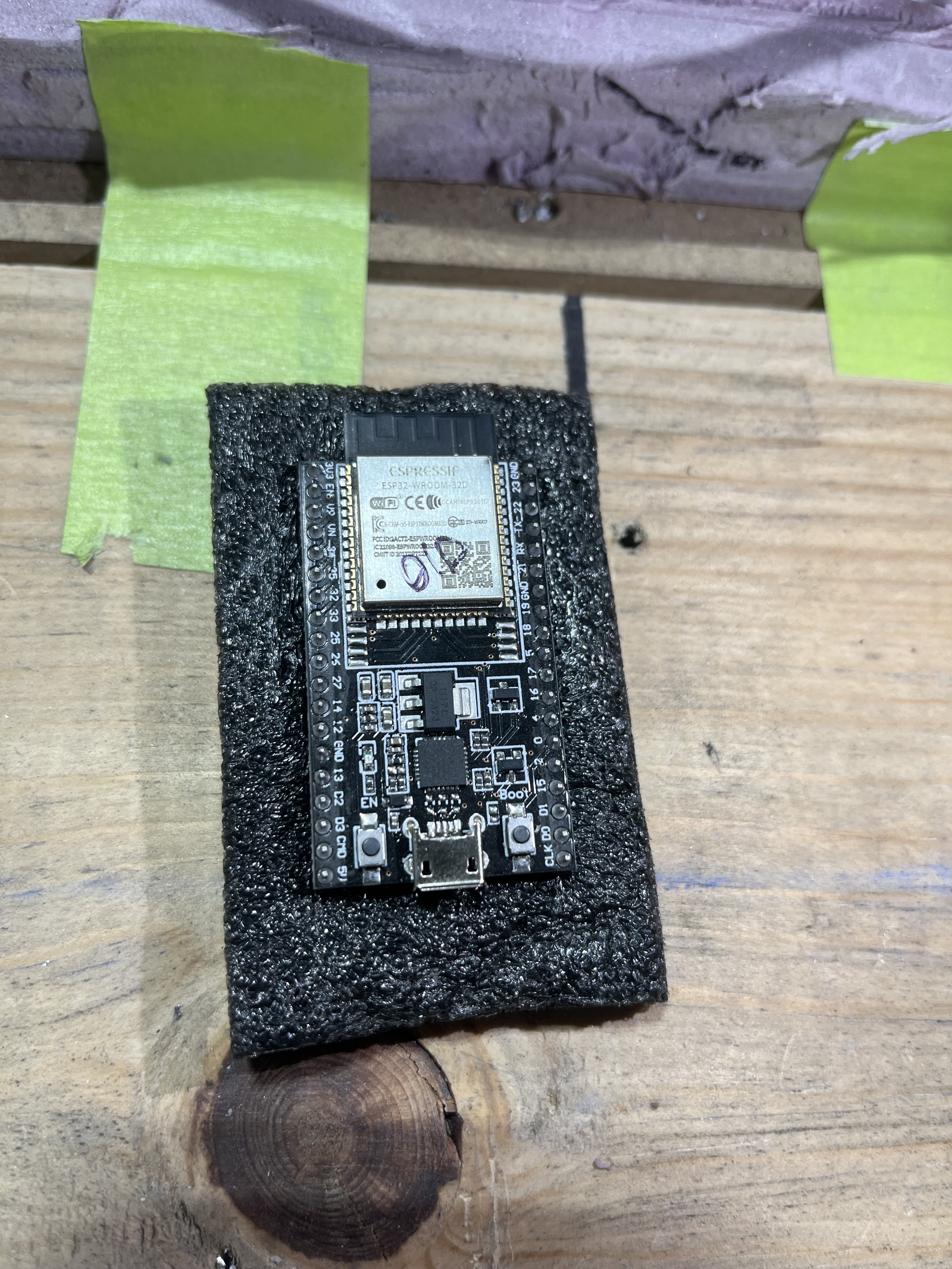

Can you post a high resolution picture of this ESP32?

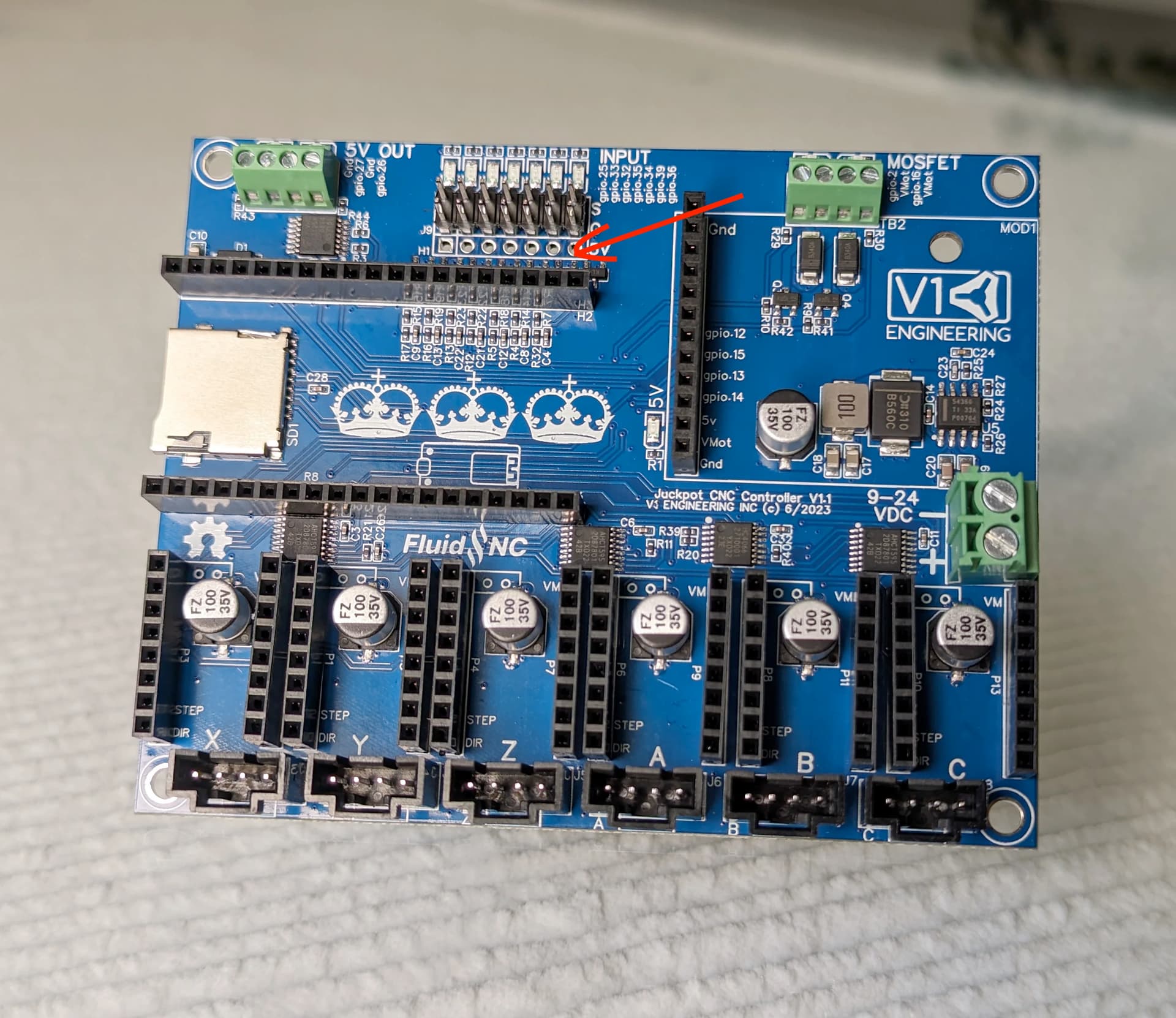

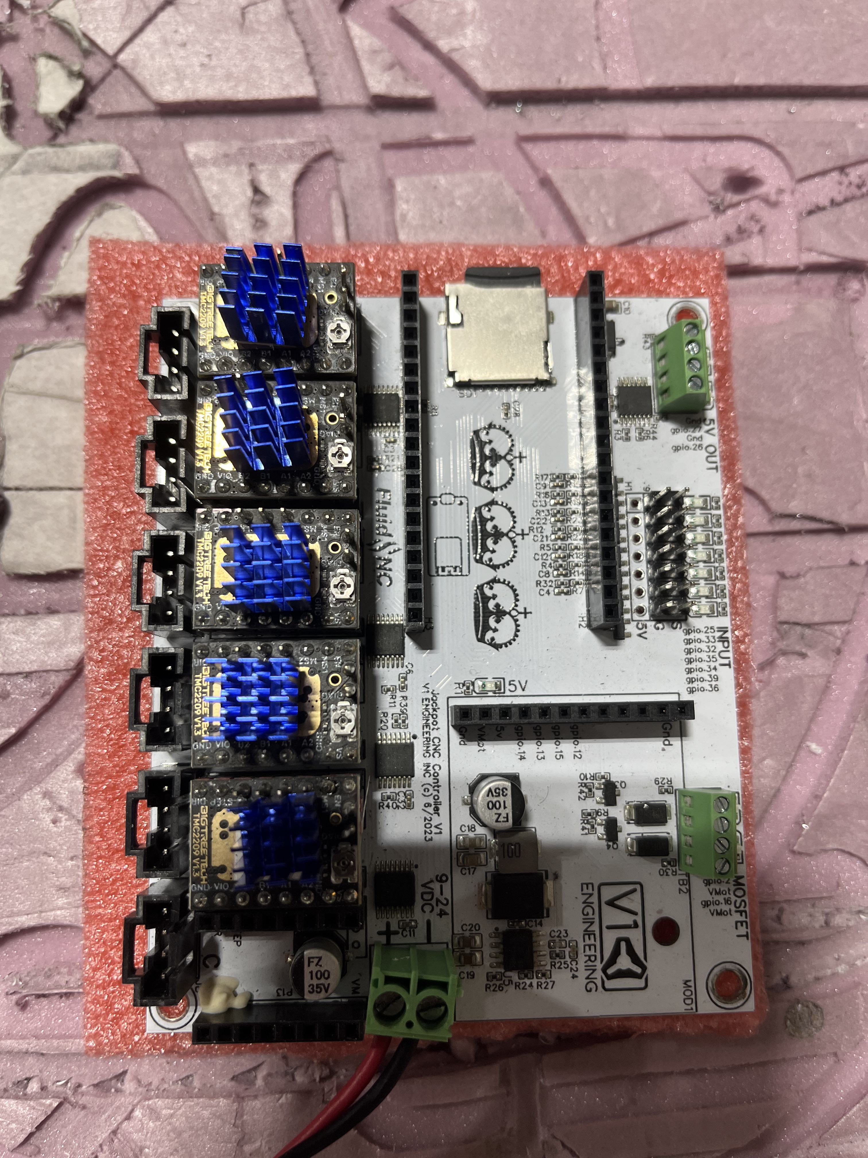

For the jackpot that doesn’t work with the known good ESP-32, can you post a high resolution picture of the board (with the ESP-32 not installed in it)?

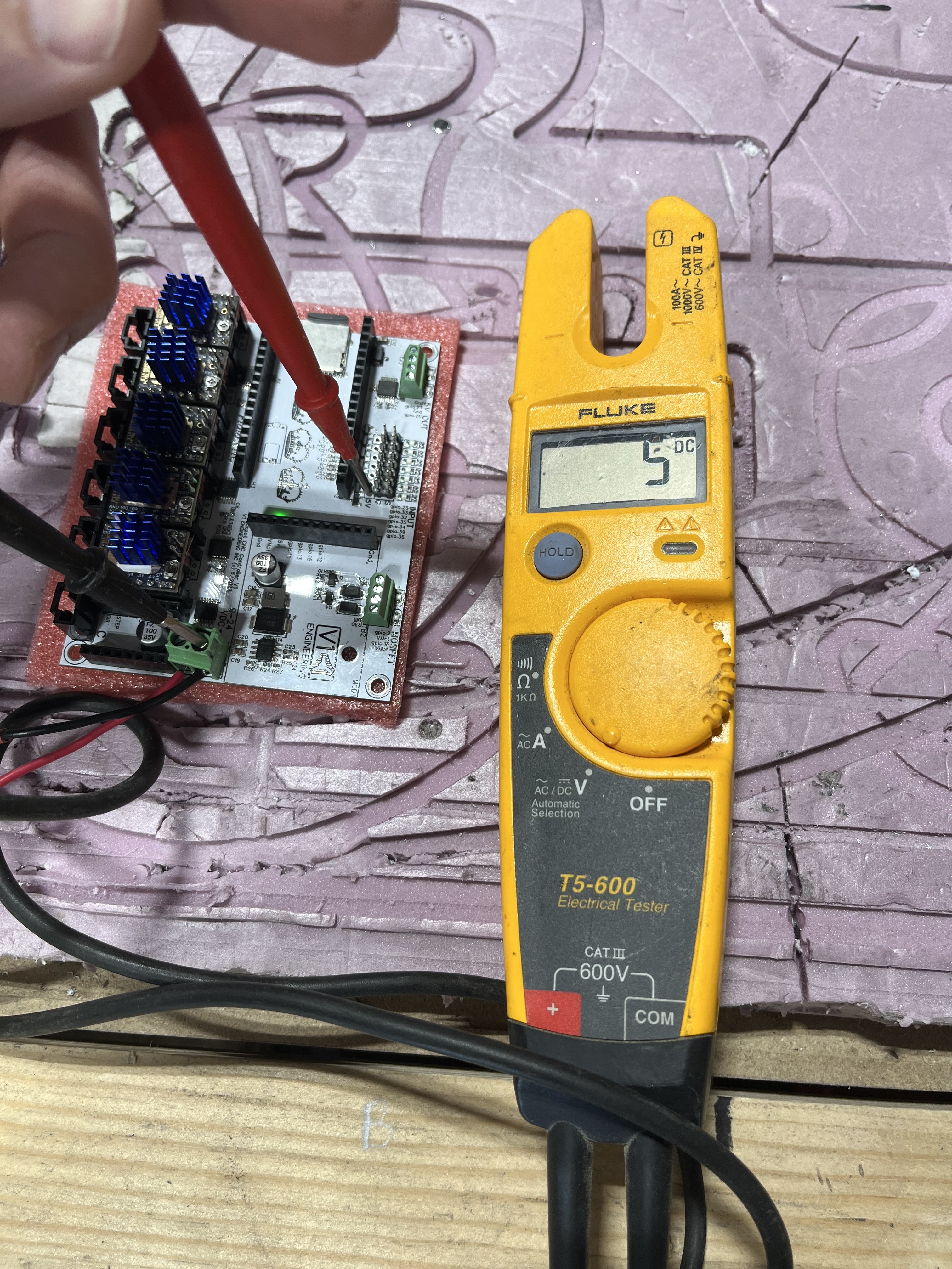

ON the jackpot board that isn’t working, leave the ESP-32 out, plug in VMOT power and turn it on. Measure the 5V rail with a DMM. Put the DMM (-) lead on the VMOT (-) connector, and there’s a convenient probe location along the row of unpopulated 5V header through holes.
Sounds like your ESP32 board died. I’ve had a few do that in other projects. I know one was for a lack of cooling.
Just finished cutting with new Jackpot board and new ESP32.Did retesting with Known good parts to old parts still Device not found. Attched are the photos you requested.
This is the non working ESP32
This is nonworking Jackpot board.
This is nonworking Jackpot with 24 volts applied and shows +5volts at rail.
