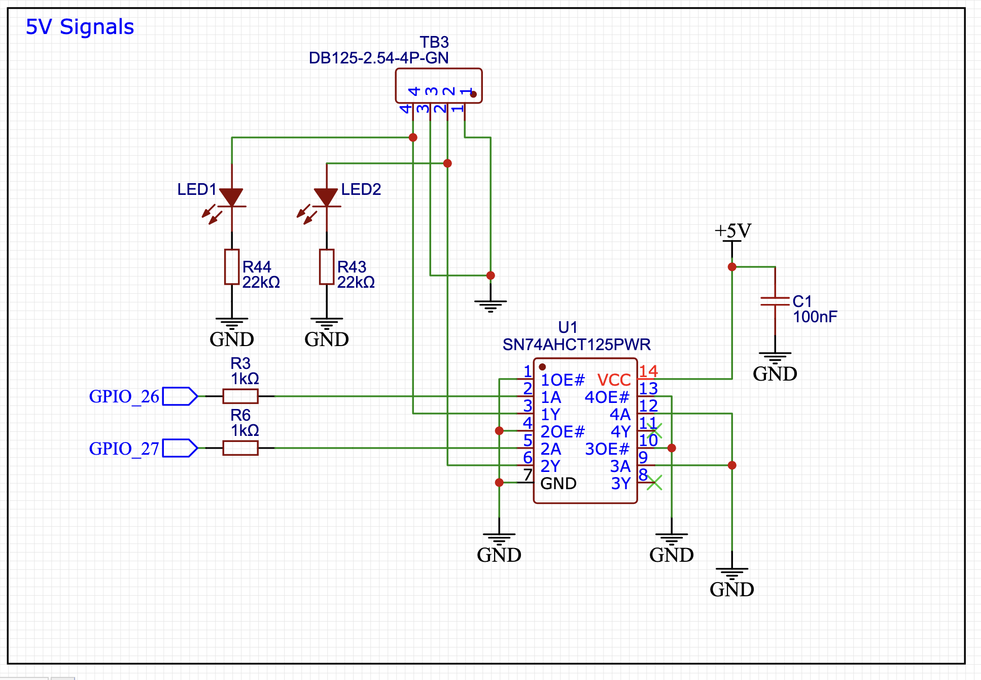

I converted my LR3 from an SKR pro 1.2 to a Jackpot control board.
To give myself a little more wire to play with while I was at it I extended my laser cable.
After trying to figure out why I couldn’t get it to fire on command I deduced that I managed to flip the polarity of the laser connector. This created a short when the Neje test module was powered. Polarity has been fixed, but gpio.27 now appears to be inoperative - almost certainly due to my error.
Fortunately gpio.26 works and the laser fires fine using it.
However gpio.26 is not advised for the laser due to a startup pulse.
I am rather cautious about the laser and very diligent about make sure it is un-powered unless truly intended, so the startup blip is probably non consequential, but I would like to explore other options:

It might just be the esp32…that is a couple dollars to replace. Having an extra one around is not a horrible idea for that price.

You could have your son try to replace U1 (See below from schematic) as it’s an inexpensive part and should be straightforward if he’s good at SMT soldering.

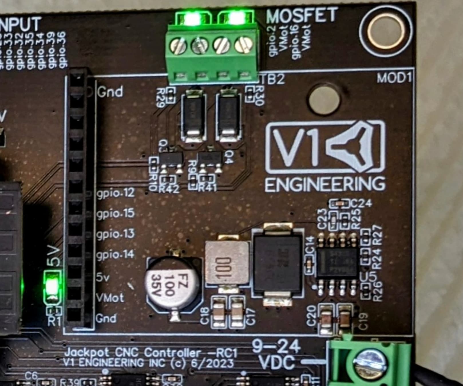

You could look into finding a module for the expansion slot, where there are more GPIOs available.
U1 on schematic (GPIO 27)
Jackpot “Mod1” expansion connector
Bart Dring expansion module on Tindie (You said you needed 5V PWM, right?)
Oh, that is a good idea as well! Pop on a 5v module!
Spare ESP32 is a good idea, but probably not whats wrong here. U1 plus those series resistors are there specifically to protect the ESP32 from this exact problem.

Thanks all, I hadn’t thought of getting a 5V module - that sounds like a great idea. Will probably be the most expensive option since I’ll bundle a bunch of stuff with my Tindie order, but that makes all the other things free, right?
