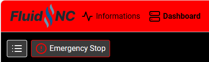

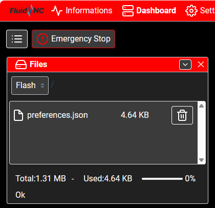

Black text on red background is rough on my eyes.
Makes things hard to read. Needs more contrast. The white text on red reads better
I agree about red being tough on the eyes. Red is tough to put in a color scheme. The V1 logo is using the reddest of reds (#ff0000). It’s especially odd when red has functional meaning like for emergency and stop.
I do think it would help to make the header not as tall. That’s a lot of red. And maybe make the panel headers a different color.

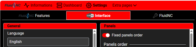

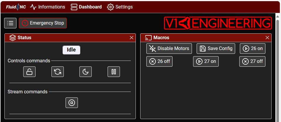

Currently:

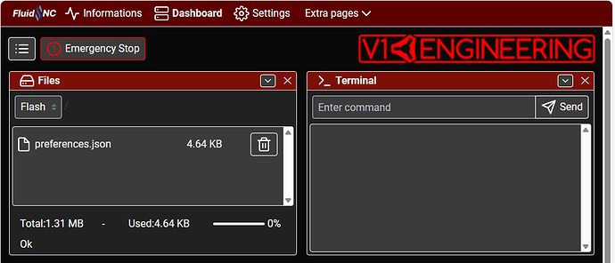

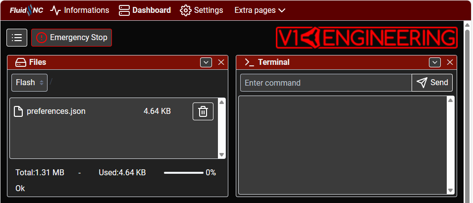

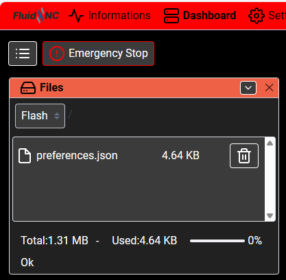

Smaller header and different color panel headers (not sure about that particular color):
The hardest part is done. Modifying colors now is easy. I think I’ll end up putting some kind of key at the top so people can modify the colors themselves. Like right now, if you want to change red to another color, just do a bulk replace of “#ff0000” to the hex color of your choice. I could probably expand on that concept. It might be fun to do that to make the theme match the color of your CNC as an alternative to using a custom logo.
This took 2 seconds and changed a lot more than is visible here:

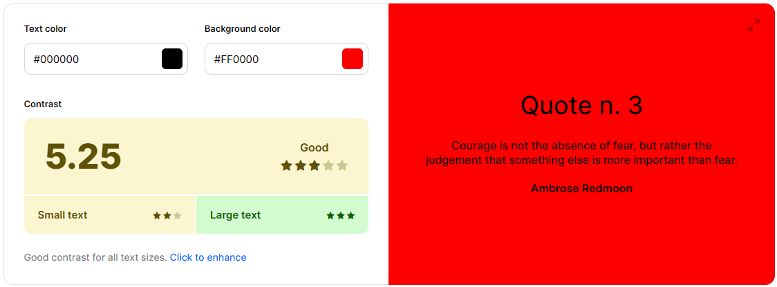

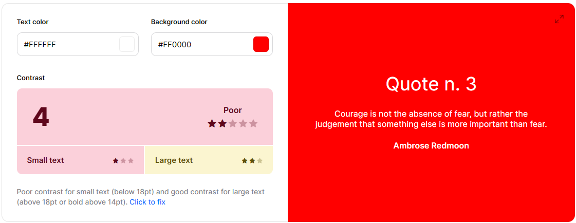

Interesting, I find white on red to be worse.
According to this color contrast checker, black on red has better contrast than white on red.

To Doug’s point about too much red, I think I’ll probably change the tabs on the settings page to not be red.

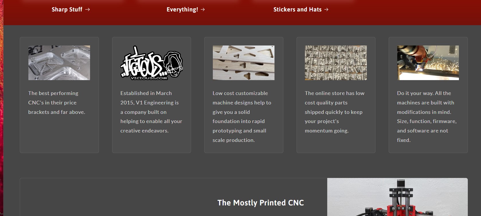

It is hard the main site took a long time to get something I didn’t hate.
Red, black, white, and a couple grays.

Yes, that darker red is better for both contrast and aesthetics
Many grays is very modern feeling (to me). I like it. A soft gradient of grays gives it a more 3D feel too.

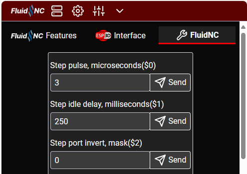

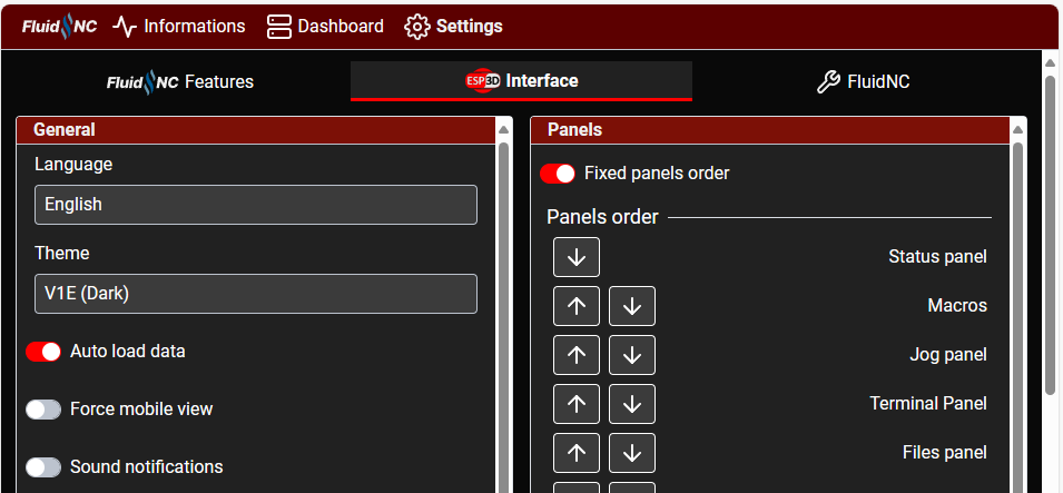

Still messing around but this feels a lot better. Since there’s a lot more contrast, I toned the white text down a bit too. I also made the background a really dark gray instead of black.
I went down a few rabbit trails.
  1. I had to figure out how to use CSS to change the text color in the FluidNC logo since the grey was too dark against the dark red.
  2. Apparently CSS variables are a thing now. That could make manually customizing the theme a lot easier.
  3. I was poking at the extension abilities. There’s a lot of potential there.
  4. With an extension, it’s probably possible to make it so you can adjust theme colors within the UI. That’s more work than I care to tackle right now.

Here’s the updated dark theme. I should get around to updating the light version this weekend but I keep tweaking things.
theme-V1E-Dark.zip (12.6 KB)
Updated the tabs on the settings page.

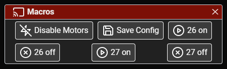

Updated it so the macro labels are still displayed in mobile mode. Otherwise, only the icons display.
Other random things, like if you have the “Informations” page displayed, the status box didn’t line up.

…I cannot thank you enough for doing this. I truly could not identify the macro’s from “icons” alone!

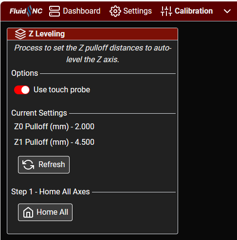

Current work in progress as a means to learn the extension capabilities:
It can currently read the pulloff settings and home the axes. I know how to manually send gcode and retrieve values. The plan is to have it probe the left and right sides a few times, perform the math, and auto-update and save the pulloff values. You can certainly Z level without this, but it would semi-automate and guide you through the process. I think similar could be done for the auto-squaring. I know this is targeting the LowRider, but if there’s something similar that makes sense for the MPCNC, that may be possible as well.

Also, not sure if it makes sense to show the machine settings by default. Not sure I’d ever change any of those settings except maybe if I was going to setup soft/hard X/Y limits.
   "showmachinesettings": false,
That enables this tab:
