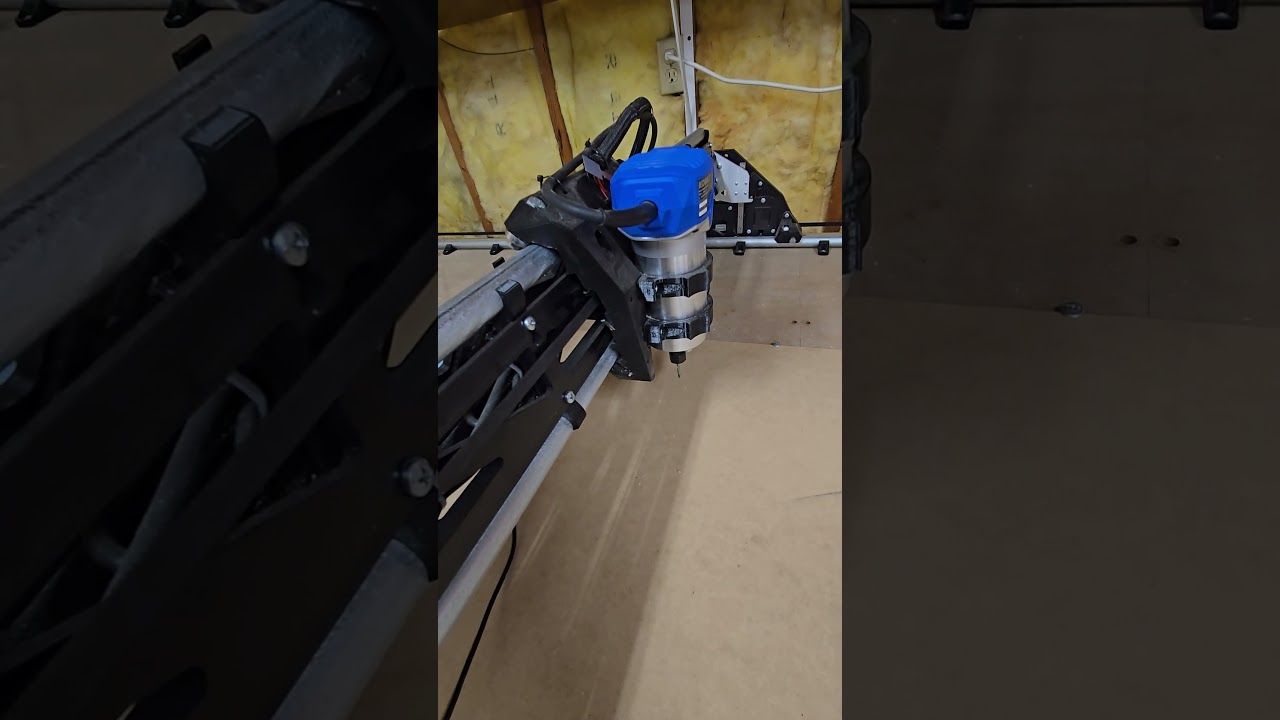

Here’s what it did a couple versions ago while jogging X+50. I about :poop: myself.
