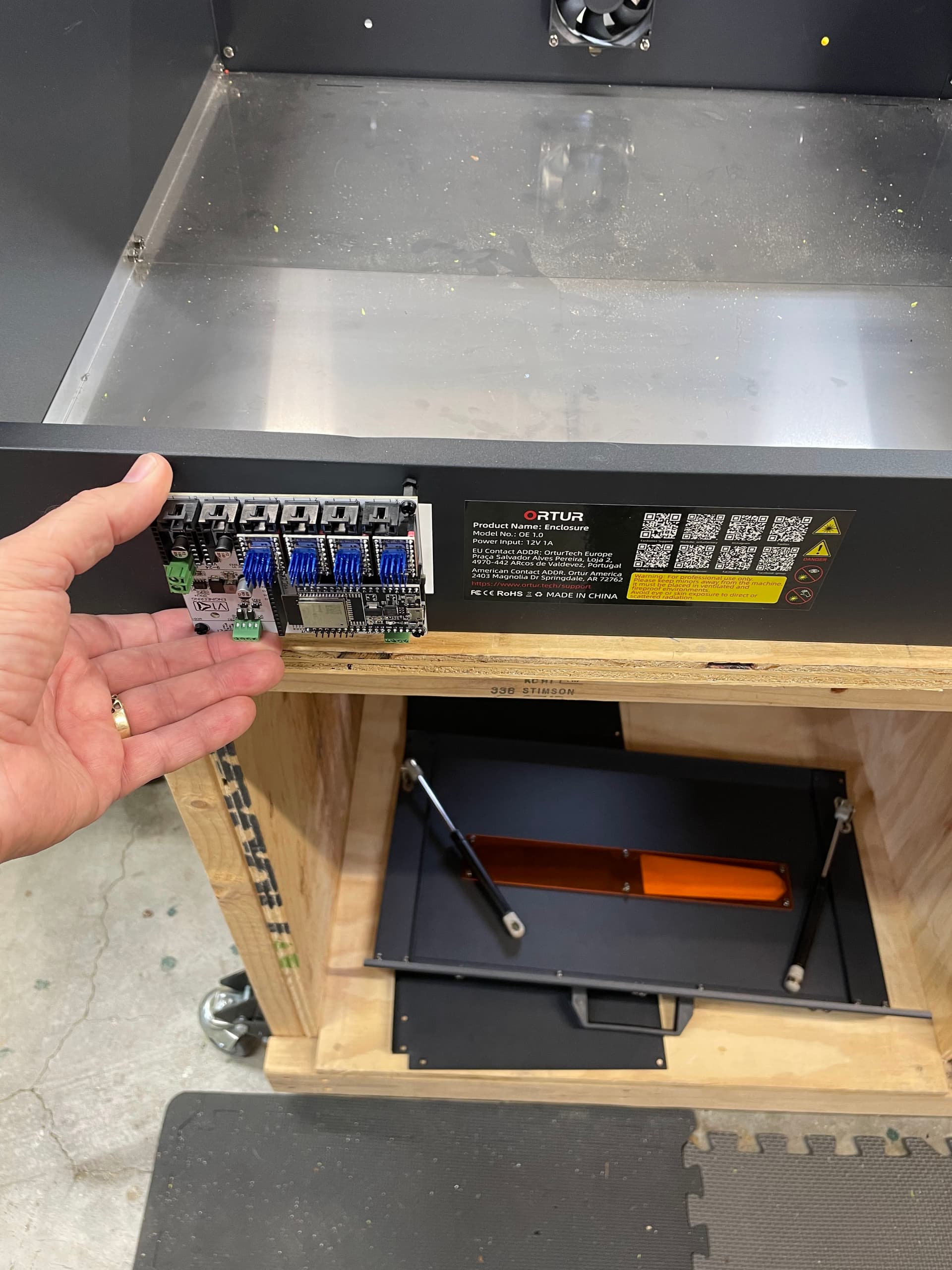

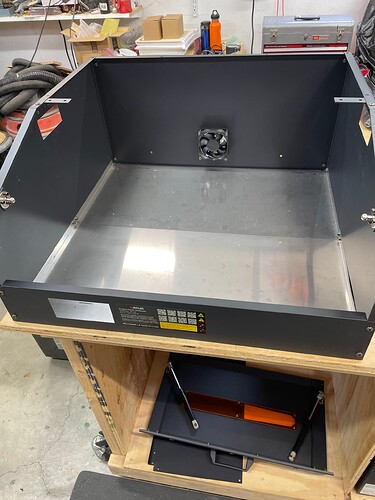

Here are pictures of the enclosure with the top and door off.
Note the position of the Jackpot board in the second picture: I’m thinking of placing it here in a box with two small fans on the front that blow air over the Jackpot and then into the enclosure. With the existing fan in the back that should really help the airflow through the enclosure while keeping the Jackpot cool and clean. It will also let me route all the cabling to the Jackpot without any additional hold or cutting in the sides of the enclosure.
There is an existing hole in the top of the enclosure that is a good place to have the air-assist feed into the system.
Onward and upward!!
Mike

As for the fans, it might be needed for your mods. I was going to remove Ortur’s fan, and put a larger inline duct fan, to make sure I clear the chamber of smoke. I’m also assuming the larger draw, is going to need some ‘intake’ ports. If you feel their fan might be undersized for your application, you might not need fans on the controller box, but a larger fan might pull fresh air through your controller box, as the intake?
I don’t know the length of duct you need to vent outside, in my case it’s not short, and a seriously doubt what looks to be a computer fan is going to push the distance I need. I fully acknowledge that fan is probably more than adequate for anyone setting the enclosure near a window less than 6 feet from the vent point. Maybe more once my enclosure arrives and I can have actual knowledge instead of speculation. I can’t seem to find good specs on the stock fan, like CFM, or pressure.
Here’s what I’m buying my son-in-law for Christmas (I’m going to use standard dust collection flex and PVC pipe)
I have two 10" ones in my shop to speedily extract fumes and fine dust - so I have some experience with them. Here’s what I know.
Don’t buy the really cheap versions - they are a lot noisier and have half the airflow.
Do add lots of inlet - perhaps 150% of the area of the fan. Even though the specs say the fan makes 37db, it sounds like 137, so put the fan as far from the box as you can, bearing in mind that every metre of ducting reduces the flow somewhat - and the outlet should be downwind of any openings in your house! ![]()
