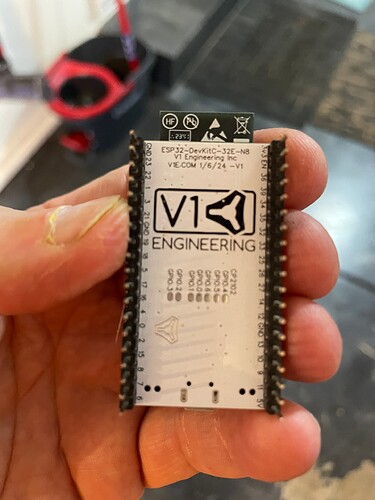

Hey Ryanā€¦Thank you again for a great board. I have thoroughly enjoyed the MPCNC and LR2 for about the past 8 years. I am having the exact same problem. When I power up the MPCNC Jackpot with a 12V Power supply, the lights all flash on and off until I disconnect the X2 and Y2 motors. After that, I re-power the board and plug in X2 and Y2 one at a time and the board and machine work great.
I have a micro-usb ESP from the shop. Do I need to install the resistor or is there a better fix?

I canā€™t tell if that version has the integrated pull up resistor (Ryan will know), but yes itā€™s possible you need the pull up added.
Please donā€™t plug or unplug the stepper connectors (or the drivers for that matter) while the board is powered, that is a way to blow up the TMC2209 drivers.

Not sure what board that is. What rev is that? There is a change log, fairly sure 1.1 started the fix.

Another solution could just be a delete and reflash all the board files.

I intend to add the resistor as you described above. I have to admit it was hard to grab the diagnostics from the terminalā€¦while it was in the flashing condition. WiFi didnā€™t work at all and the USB terminal didnā€™t cause all of the lights (end stop status) to blink until I plugged in the 12V PS. For more detail, if I had all 5 steppers connected AND THEN powered the board via the terminals on the Jackpot with a 12V 5A power supply, the lights on the Jackpot blink.

Once the pull up resistor is on the ESP32 then weā€™ll want to get another look at what these do.
You shouldnā€™t have LEDs blinking away if the board is just sitting there not doing anything.
you have a V1.2 board it is not needed.
