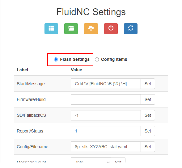

Are the wifi settings under “Flash settings”?
Those should be saved to non-volatile storage immediately

Only things stored in the config file don’t persist on reboot, and have this running mode that requires a config dump to persist.
Any of the settings labeled as “Flash” settings, are stored immediately on disk.
