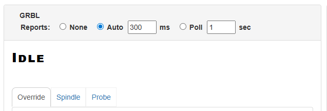

The biggest issue with the jackpot board is the lag. It seems like every action requires a 5 or 10 second software lag after the movement is done. Perhaps the improved location of the wifi makes the v3 faster? Although the problem doesnt seem to be the wifi, it seems like its the proccessor or other computing bottleneck. The old v1pi setup was way faster.

Can you describe this on more detail? Are you running gcode files via the WebUI or a sender? This has not been my experience.
I am using the web ui in sta mode. I have really good wifi in the shop. When I press the homing button it will run the homing routine but there is a lag after its done, and i wait for the green start job button to be available. It is really very tolerable but just not snappy. Kind of the same lag while zeroing out the surface with the probe . The attach probe message come up immediately but the resume button before and after the probing takes a second to be available.
Oh, this might be a super simple fix. I’m guessing you’re using WebUI v2? I don’t have access to get a screenshot at the moment but what is your reporting set to? There are auto-reporting and poll options.

Well, that’s rather old but if everything else is working ok, you don’t need to upgrade. Current version is 3.9.9.
You are on WebUI v2. I was referring to this:
That setting defines how quickly it gets updates.
  • Auto: This sets up auto-reporting where it will receive updates as soon as they are triggered, but not more frequently than the defined milliseconds. This is what I would recommend.
  • Poll: This sends a “?” command to get updated status/position on the defined frequency. I’m guessing you have it set to this and is the source of the lag.
OMG I was on poll 10 seconds. Will be upgrading the firmware as well. Much thanks!
