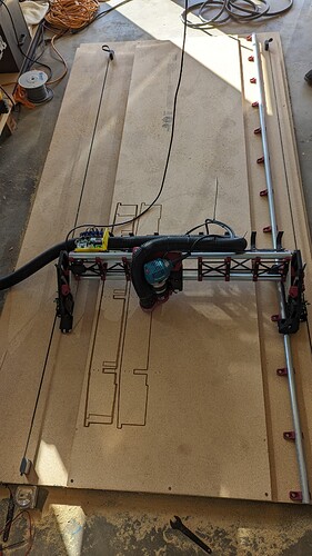

Was trying to get my LR3 build moving this weekend, and found the LDO steppers I’m using (42STH48-2804AC) are considerably more thirsty than the ones that come in the kit. It wouldn’t even home at the drive current in the stock LR3 config. Found I need about 1.5A drive and 1A hold for everything but the y access, which took a bit more…I ended up at 2.4A to get them to not skip steps during a cut.
In the process I also found that the jackpot will drive BTT TMC2226 steppers with no problem at 2.4A for at least a 2 hr cut. Only change needed was to update the sense resistor value in the config (0.15 for the 2226s).
Also, lesson learned: hot rod 3d printer steppers do not necessarily male good cnc router steppers.
Debating on doing more research and trying different steppers, or go the boring route and get a set from the v1e store :wink:

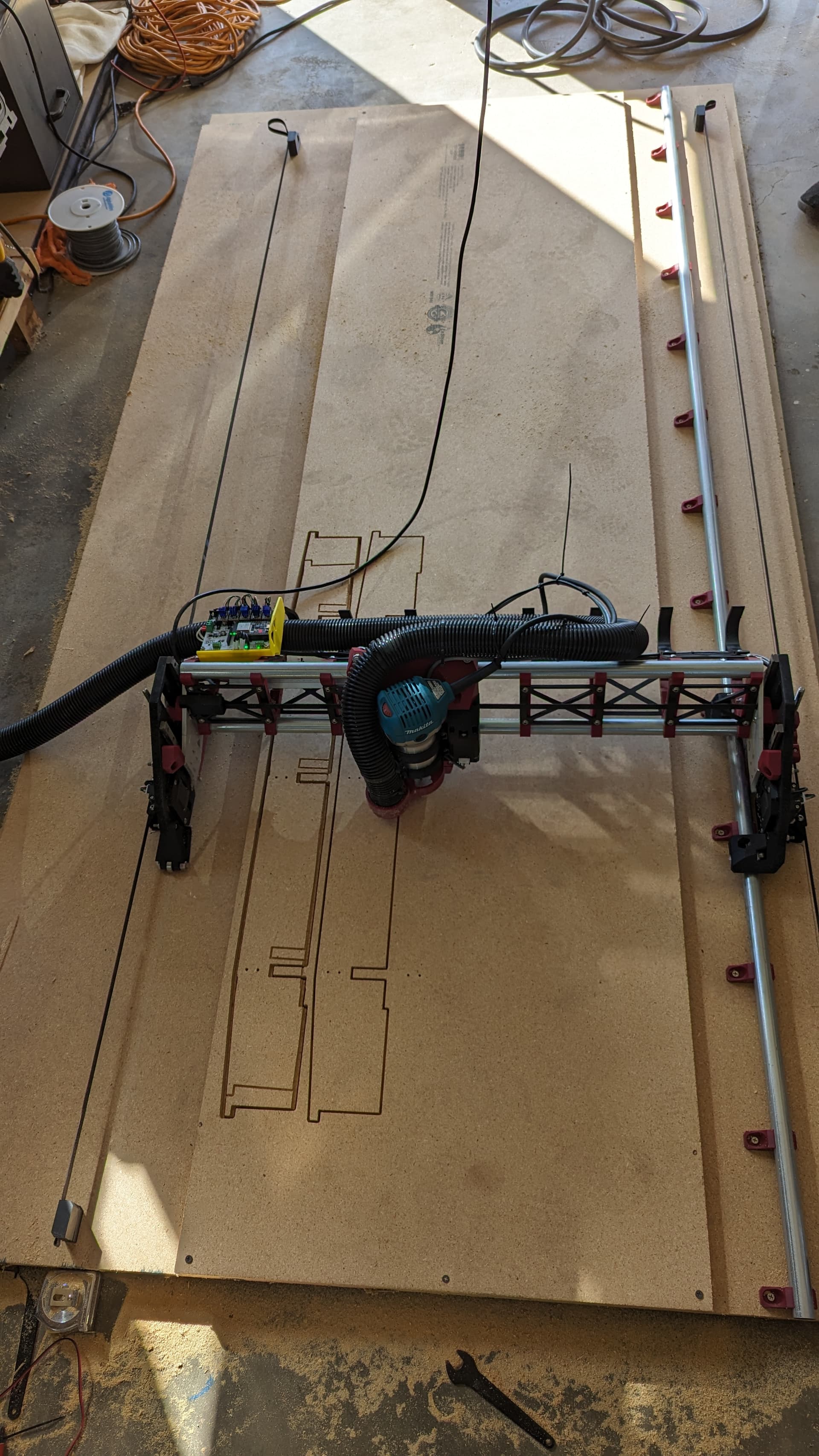

Figured I should add a pic…
Cut on the left is where I tuned in the y stepper current to get it to stop skipping steps.

It is not clear to me what the issue is but something is wrong. What cutting and rapid speeds did you use
It seemed really high to me too, but couldn’t find anything else wrong. I was figuring they used a larger sized motor coil wire to accommodate the currebt, so it had fewer turns and required higher current to run. I’m running the default speed for travel and I ended up cutting at 25mm/s @3mm depth with an 1/8 single flute into low density fiber board. I had reduced the speed all the way down to about 10mm/s at one point, but that seemed to make it worse.
I think I’m going to try to swap in the skr board I have this weekend and see if I have the same torque issues with that. That should narrow it down to the board and settings vs the mechanical bits and wiring.

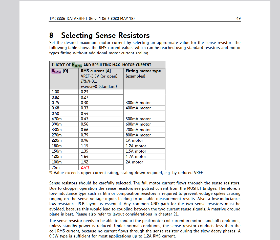

I just took a look at the data sheets for the TMC’s that 150M Rsense is worse than the 110M for your use case. I have been learning a lot here.
So in your case setting it to 2.5V you get about 1.5A out. With the 2209 you would get ~1.8A Perfectly sized for our steppers, Nema 17 84OZ/in Steppers – V1 Engineering Inc, far too low for your steppers.
I think it is in your best interest to replace your steppers, and use 2209 drivers.
OR…if you can replace your resistors with 90-100M resistors.
I’m not sure why the BTT tmc2226s come with bigger sense resistors, unless it’s some kind of hack to make them otherwise compatible with 2209 profiles.
I think I am going to go with different steppers, but my harness has jst connectors on it so I might go with different ones to avoid re-wiring the whole thing.
No matching resistors would make them a 1 to 1 plug in swap. It was just a poor choice by Biqu. I have told them this, maybe they will revise them.
Swapped out the steppers the other day and can confirm that was the problem. I’m running them at 1 amp and they have significantly more torque than the LDO “super power” steppers did at 2 amps. The only reason I’m not running them at stock config current is that I needed to get a part knocked out before leaving for vacation and didn’t want to risk skipping steps mid-program.
I also noticed while I was still running the LDO steppers that the 2226s appear to be able to handle more current than the 2209s. I was running Y on 2226s at 2.2A and it would finish an entire program without issue. The X-axis (2209) was running at 2A and I had a few occurrences during longer programs where the X-axis would seem to overheat and shut down mid-travel and come down and start cutting about an inch short of where it should have.
That is a higher setting but less output current because of the sense resistor difference. A quick way to verify is to test the stepper temp after running.
