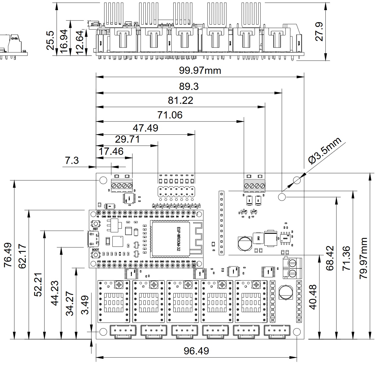

I know this isn’t exactly what you’re looking but maybe it’ll be helpful.
From https://www.pcbway.com/project/shareproject/Jackpot_CNC_Controller_e268f424.html
Thanks, yeah I found this too, I was hoping for a step or stl file to use in Fusion.
You could try opening the design drawing from here which will open it in EasyEDA from which you might be able to export it.

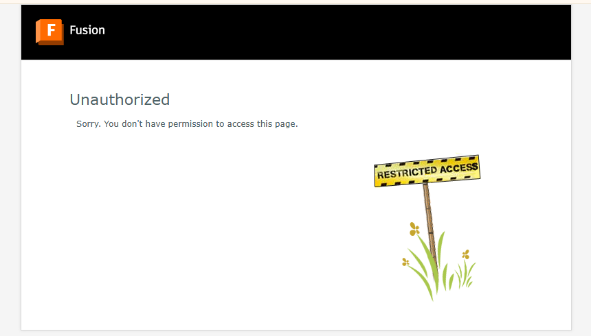

Ironically that page has the broken link to either the fusion file or stl/step model at the bottom.
  • CAD/Step link
    But it requires authorization. So, there must be someone with the actual model out there.

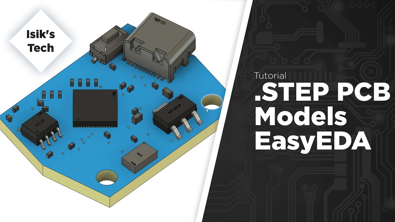

So I took another look at this and found this youtube:
which shows how to get the model out of the easyeda online system.
Thanks for pointing me in the right direction.

I think you have to use the easyeda desktop version if I am not mistaken to get a good model out of it, that is exactly what I did, the fusion model is just an import of that. Hopefully they actually made that work in the online version, that would save a step.
It works with the online version but you have to jump through some hoops. You need to export from the standard version and then import that into the pro version (registration required). Then from there you can export a step file for import into whatever you like, it worked great in fusion.
