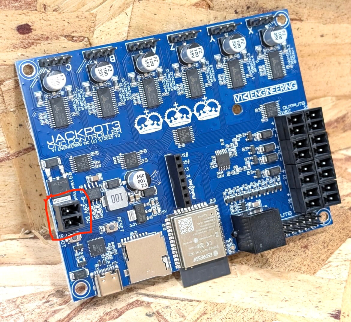

My question: what kind of plug is needed to crimp my 24v power supply to so it will fit the socket outline below? Some kind of JST-XX socket I am sure but could not find a visual match.

The board comes with 5 of those plugs. You just strip the wire back some and the plug has a screw terminal on it. It is highly suggested to put a ferrule on the end of the wires.
If you want to post your config.cfg I know there are plenty here that can help you make the changes to move the Z stepper to C and get you back running with your current Jackpot board.
The connector for that comes with the jackpot. You cut the wires for your power supply, strip them, preferably crimp on ferrules.
Then screw them into the screw compression terminals on the connector that is supplied with the jackpot.

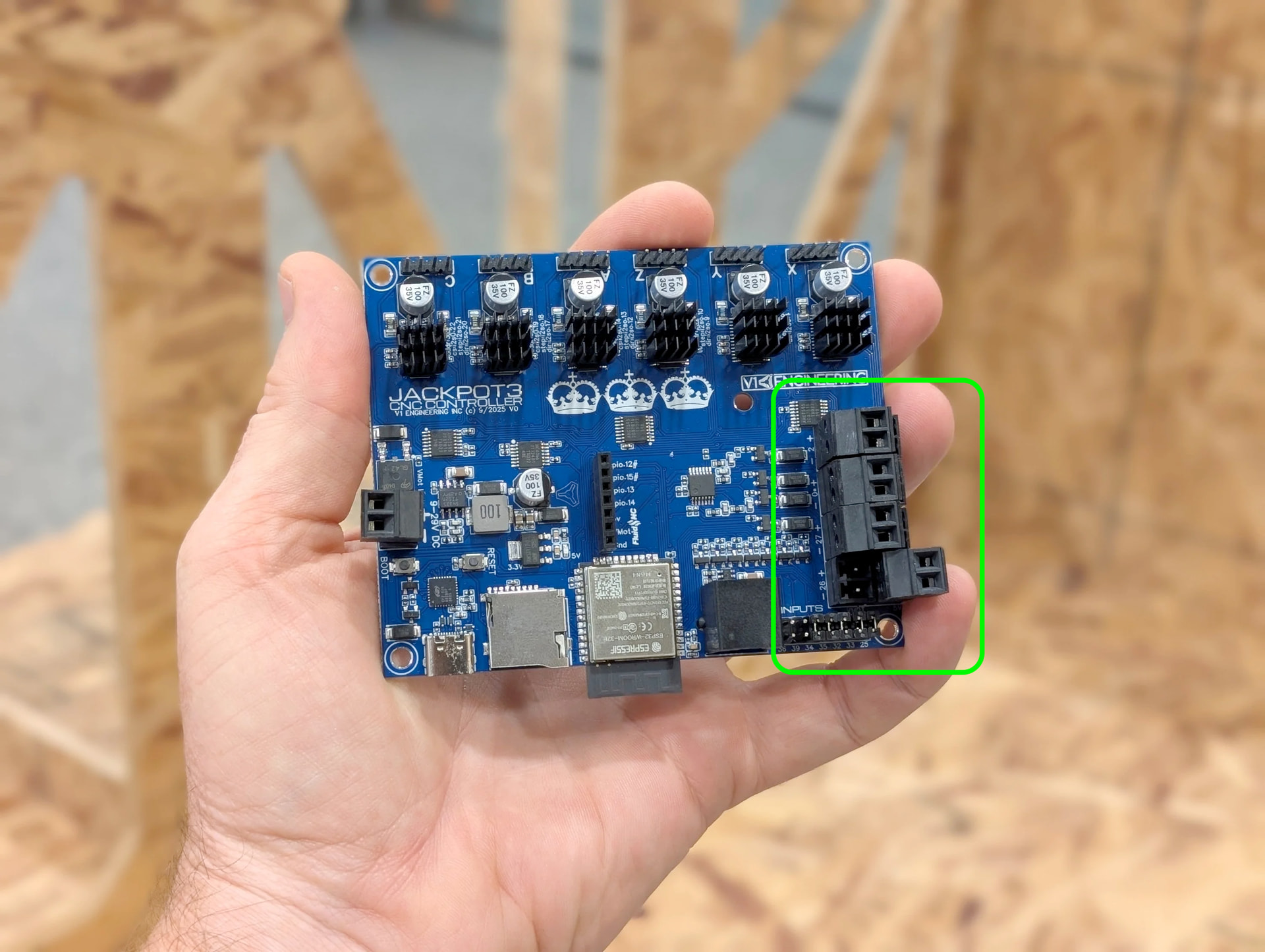

Hey Jonathan, I am actually about to use some of 24v VMOT and some of the 5V outputs for accessories such as 24v relay and 24v LED strip.
Still curious about the best connector plug to connect into those outputs. I bought some JST-VH 3.96 but it doesn’t seem like they work. Are people just using 1P female duponts?
If you mean use the VMOT power to run things through the IOT relay- DON"T pull it off the Jackpot. Use terminal blocks or solder / crimp to pick off VMOT power before it goes into the Jackpot.
Your Jackpot V3 board should have come with the suitable connectors in the box with the board.
You can see them below as-installed:

Also I am surprised but I did not receive any of those connectors with my jackpot3. Do you know what they’re called so I can buy some?
