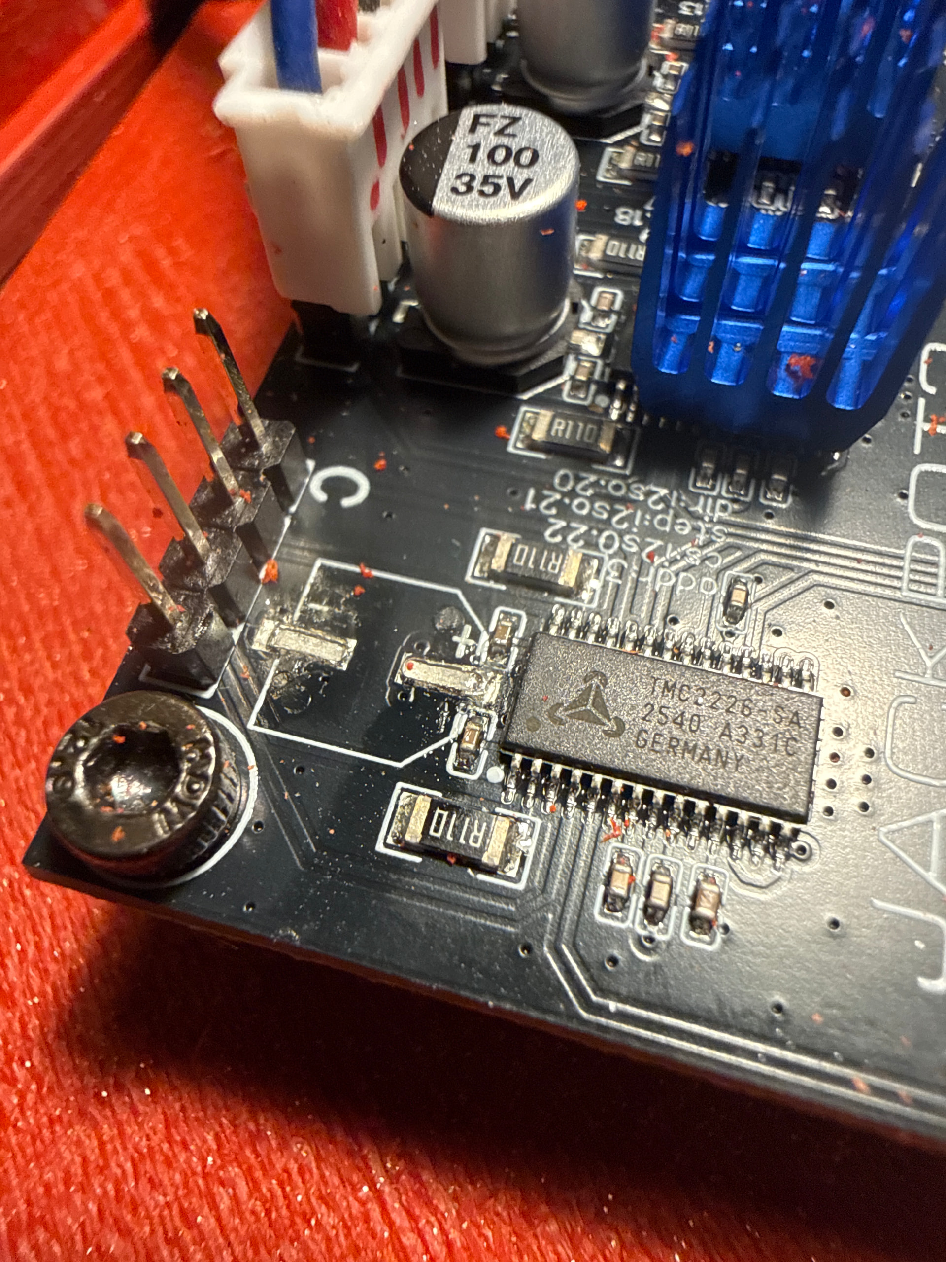

I somehow knocked off the capacitor for connector C on my brand new Jackpot 3. I am not using connector C for my MPCNC. Should I mess with trying to re-solder the capacitor? Or will it be fine as long as I don’t use that connection?
Thx for the poop emoji. Any one else have any help to offer?
@vicious1 you have any input on this?
Absolutely fine without it. If you ever need the C port, you will need to replace it though.
wow, it didn’t even pull the traces out!
I bet there’s a story to be told. Wild.
Not sure what happened. Just noticed it had fallen off… Maybe it wasn’t soldered well to begin with. Thx everyone. I’ll power it up this evening.
