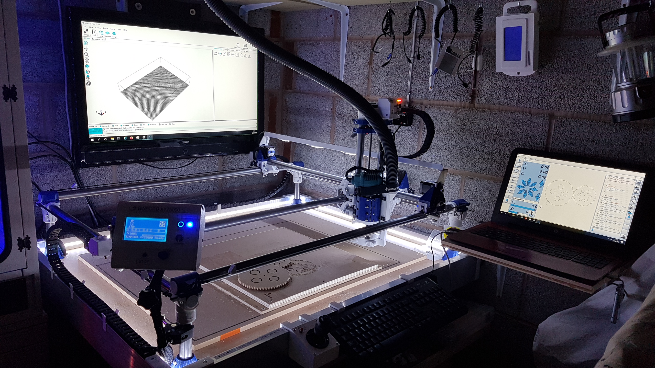

Got an old 32" TV out the loft… makes a great large slave monitor for Repetier :ok_hand:
Also got my Joystick installed. I do like the clip mounting system on the side (same as the keyboard). I can just place it where I want.
My joystick is the same as everyone else’s I think. Usual X, Y and twist Z (took some fiddling to get the ranges correct).
You press and hold the red button to enable it (didn’t want any knocked joystick movement errors).
Just making a simple circuit to allow the top joystick button to reset origin (X=0, Y=0, Z=0). Think that will be a handy function. I think it will be press and hold for two seconds to set origin.

I also like the idea of a push to use button. The Joystick is used infrequently enough that it seems like a reasonable approach. Having it be movable and holdable also makes it usable if you need to move around the machine while adjusting position. Especially if you have a large machine like mine that covers a 3’ x 5’ dining table.
Well, I have more than enough ways to move this thing around!
I can press the red button (LED illuminates), and drive it pretty rapidly around the worktop with proportional speed.
It’s great for lining up the start of your cut.
Then, when I add the reset origins function, I think it will be very handy.
