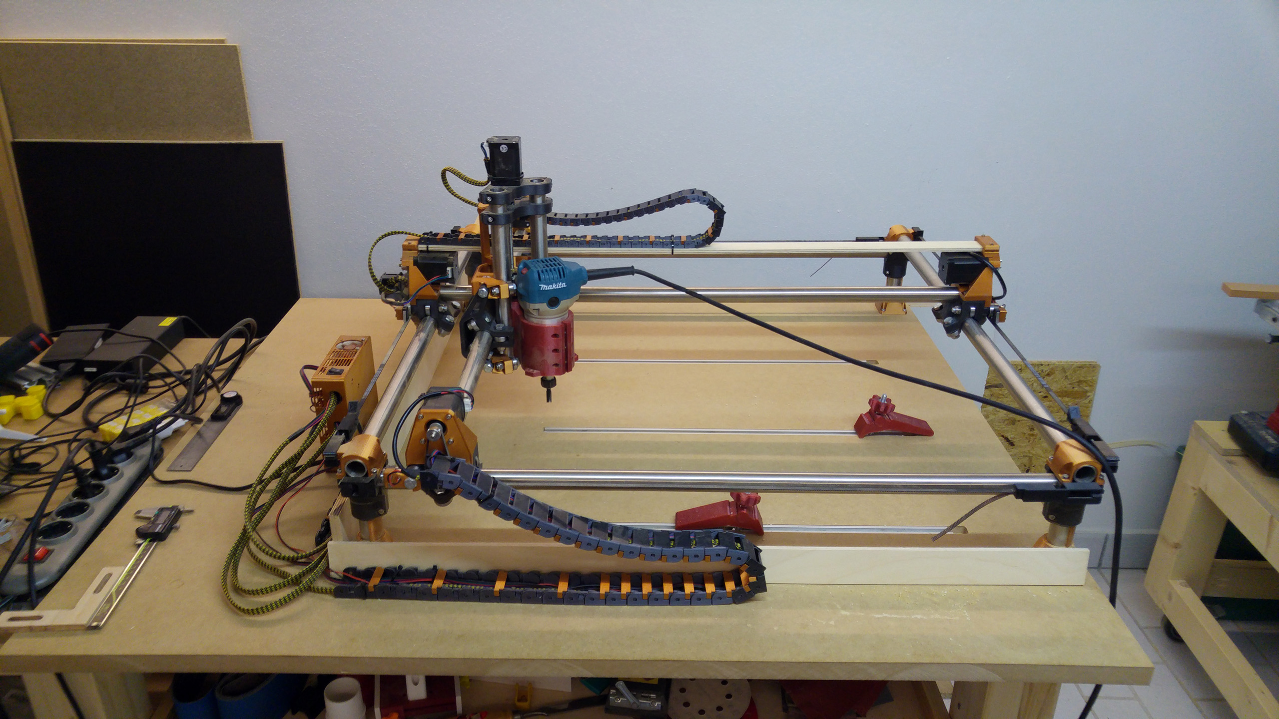

This is my first dive into the world of CNC milling. Super happy with the MPCNC so far, but still lots of things to learn and tweak.
Pics:
I currently have a working area of 600x600mm. I’m thinking about shortening the y axis to something like 450mm though. This is also the reason why I haven’t cut the MDF base to size yet. I’m still undecided on final dimensions.
I use M8 t-track slots to clamp down my stock. I’m going to add a couple more tracks so I can more easily reach smaller stock with the clamps.
I mounted my router directly to the z-axis tubes, without using the tool mount.
This allowed me to push it a little closer to the gantry.
To be honest, the difference in distance is so low that I wouldn’t do it again. It seemed like a good idea at the time, but I doubt there’s any benefit.
First cuts in plywood!
I had to stop the first cut (on the left) due to chatter and the y axis drifting. After further inspection I noticed that I had forgotten to tighten down some of the bolts on the underside of the gantry…
The second cut worked much better! :slight_smile:
There was some tear out, presumably because I was using an 8mm router bit. Unfortunately that’s the smallest router bit I own. 1/8’’ end mills are still on the way.
Auto squaring rocks! 90° right off the bat.
X and Y axis steps/mm need some minor tweaking, but this a superb starting point.

Some minor issues I ran into during my build:
  • Using thick zip ties to mount the belts is a bad idea. They will never stretch out completely under load. Because of this they flex quite a bit during axis movement. Normal zip ties work much better. I ended up going with printed belt tensioners.
  • Forgetting to tighten down some of the bolts after assembly…
  • I can’t get 2 of the bearings on the XYZ parts to press against the z-axis tubes properly. I will make a post about this in Troubleshooting after I’ve verified that all bolts are reasonably tightened.
Since I already owned the duet and the makita router, this was a very inexpensive build. This is such an awesome yet cheap design. :slight_smile:

Did some first test cuts in hardwood (beech) today.
Of course my phone ran out of battery before I could record any of the faster/deeper cuts.
Ended up cutting at ~20.000rpm, 1800 mm/min, 5mm depth of cut on a 1/8’’ single flute china end mill. (chip load of 0.09mm)
I stopped pushing it further because I started to notice some flexing… no chatter though. :slight_smile:
Some thoughts on the flexing issue:
  • The er11a adapter I use adds an extra 50mm of height to the entire assembly. That can't be helpful, but it is stiffer than I expected.
  • Further tightening the belts helped. They seem to really like the high tension.
  • My belt mounts/tensioners can stretch ever so slightly. They were hastily designed; all the force resides on the threads of an m3 screw... Definitely worth revisiting them.
  • I'm fairly certain the main culprit are my XYZ Burly parts... Looking at them closely, I noticed they only have 2 perimeters, yet I intended to print all parts with 4 perimeters and follow the infill recommendations. I must have printed them with my default settings by accident, which are 2 perimeters at 15% infill... Going to reprint those with proper settings.
