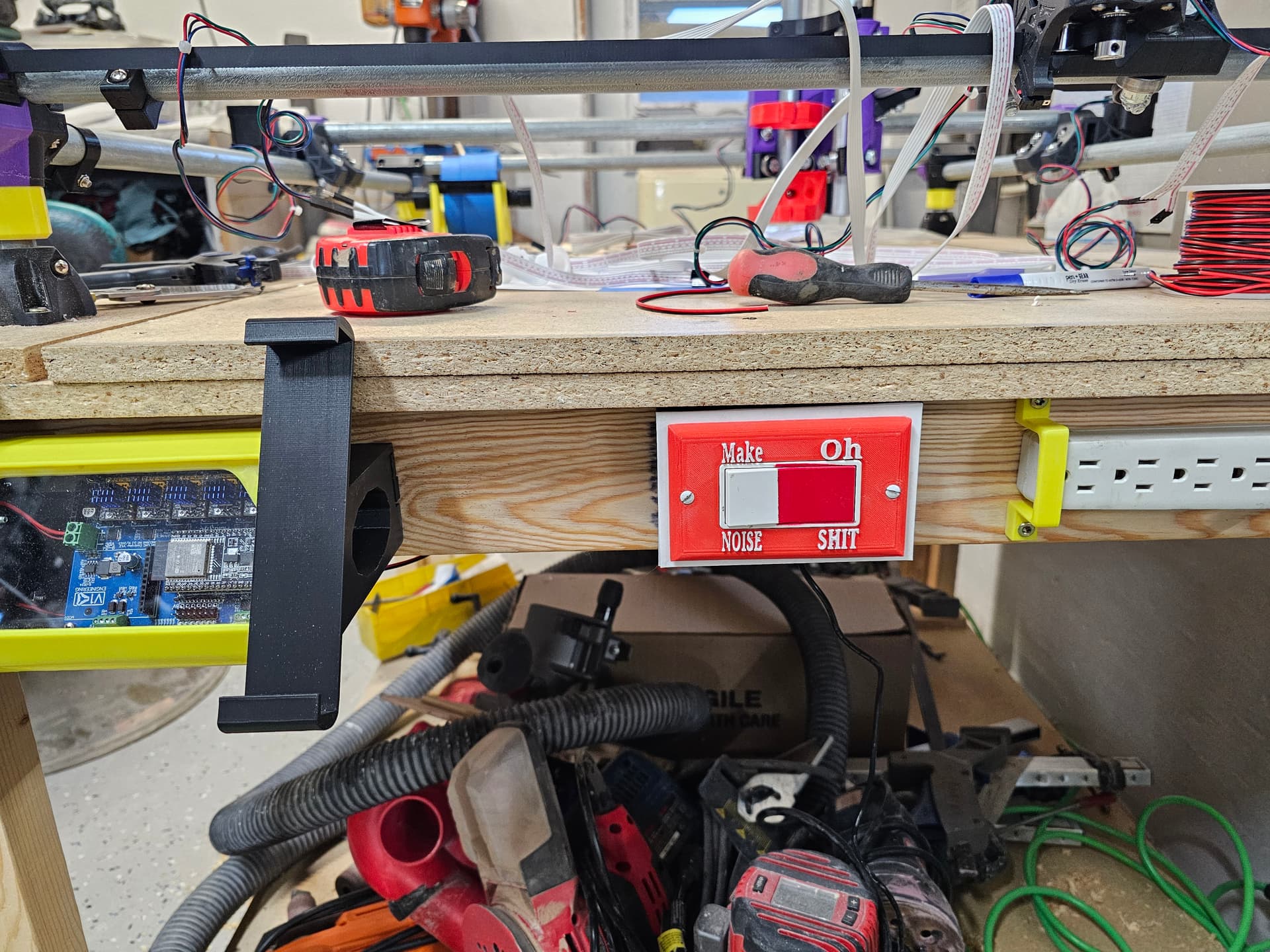

I’m still waiting on the lead screw to show up, pretty much the only hard bit I’m missing. I missed that i ordered from China and apparently theyre walking it here. And i missed that the wiring kit didn’t come with the end stop wiring, so ordered that. No biggie but the extra shipping charge sucks. Once they’re in I’ll run and secure all the wiring. 20 years ago i started my 1st build and gave up before it was done. So I’m leaps and bounds further along, much simpler now.
But i duct taped a pen to my machine and actually ran it last night, nice to see it actually moving.
And put together the control mount and made a couple emergency stops. I have 1 mounted on either side of the table im likely to be on.

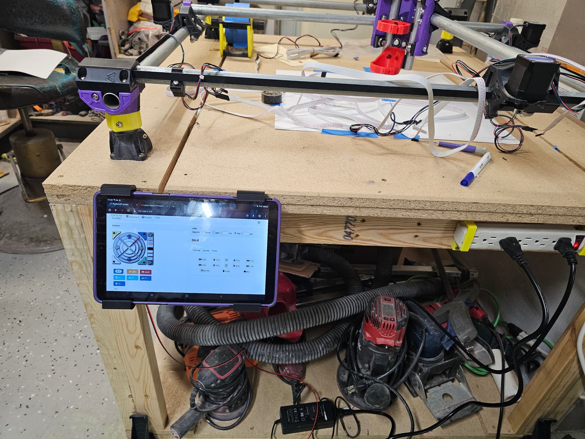

What is that control software your running on your tablet? That looks to be an Android tablet, yes?
That looks like FluidNC’s webUI.
It’s the built in fluidnc interface. I haven’t played with it much yet, it seems to be missing a way to set the origins except by turning it on and it sets 0 where-ever it happens to be. I found it on the ‘tablet’ tab but not the dashboard. I haven’t played around with it much yet though. It’s such a needed option I can’t imagine that it’s not actually there.
Most of us do it with our starting gcode so it is never forgotten.
If you want to add it just make a new macro button with the command, G92 X0 Y0 Z0
Found it. It’s a small button but it’s there.
I need to learn actual gcode commands and how to make macros. I’ve not needed them on the shop machine but there’s 2 or 3 i would like to do on mine.
Sorry, I forgot about it. When we get to the V3 of the UI you can read the buttons much much better.
Copy one of the numbered ones that are there and re-number it. Use a text editor to change the gcode in there. Then use the macro maker to name and give an icon to it. Give it a shot and I can help better if you get stuck.
You will see all the files in the system folder, you can upload and download. A macro is the numbered file and a record of it in the macro file.
