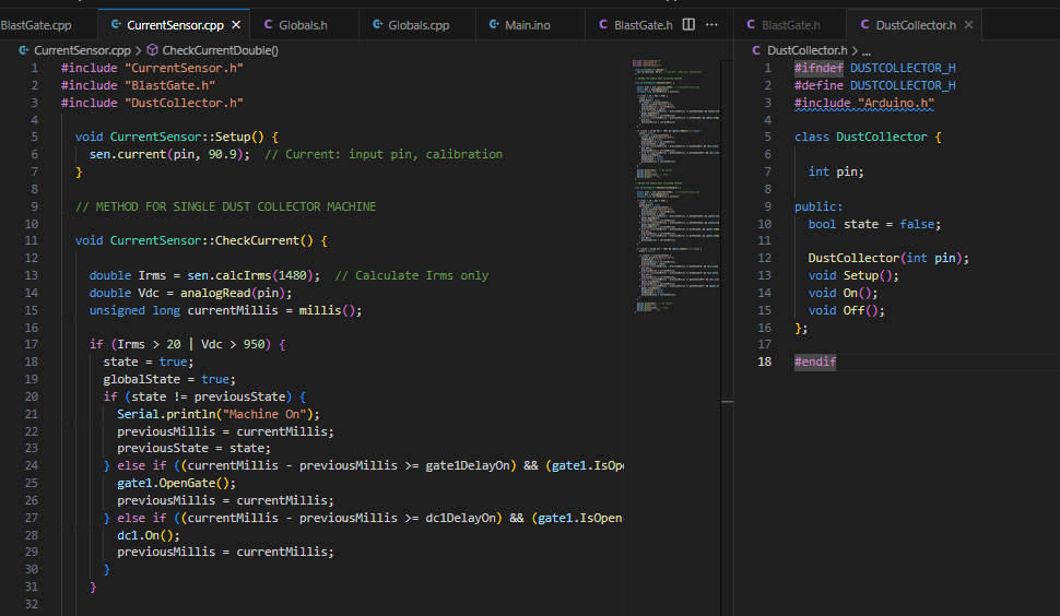

Having a small issue with the CT clamp right now that I cant seem to pinpoint. I’m wondering if I used the wrong burden resistor. I swear I’ve read so much about how to hook that up over the last few days I’ve gone numb. Some places say that CT clamp has one built in and other say it doesn’t. I went with it doesn’t and got it calibrated this morning to real close to my fluke amp clamp. But every once in a while it will spike up the current and If I catch it then I throw the fluke on there and the current isn’t there. Fluke showing .03A and ESP showing .15A
It very well could be that I ordered the wrong CT clamp. This thing is for up to 100 amps. So as small as I’m trying to read may just be out of its range. I’m going to run it here in a little while and see what the max current is during a cut and order a smaller one that’s closer in range for what I’m using. Ill find somewhere else to use this 100 amp one.

This was actually the start of a much larger plan. And the first step to see if it was even possible. Now the next step is to print out some new ball valve style blast gates I found and then set them up with servo motors. Add more CT clamps to the other main dust collection machines (2nd LR3, Table Saw, Chop Saw and Spindle Sander) and automate the entire system. I want to walk up to the table saw, turn it on and have the dust collection open the blast gate and turn on all by its self. And when I turn off the saw have it run for ~30 seconds longer to clear the piping and then shut off and close the blast gate. That’s my end goal anyways lol. I need to get one of these gates printed up and start looking at mounting the servo and all that. See what its all going to actually take to get working.

I started writing the code for it based on some things I pieced together online, but I decided that I’m not using current sensors to automate it. I’m just going to put a toggle switch at each station to manually turn it when I need. I just could see myself needing to use the suction at my miter saw station for something else temporarily and not being able to because the saw wasn’t running, so I figured I would just simplify it.
The LR3 is the only one I intend to automate turning it on when the job is running.
I haven’t tried actually running the code I’ve written yet though :slight_smile:
