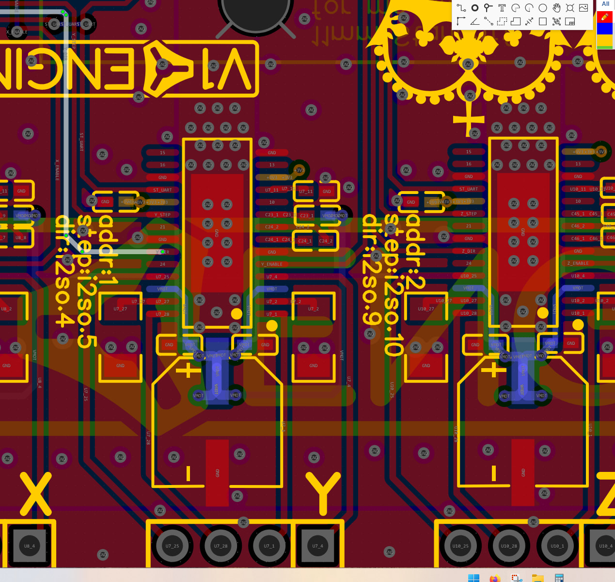

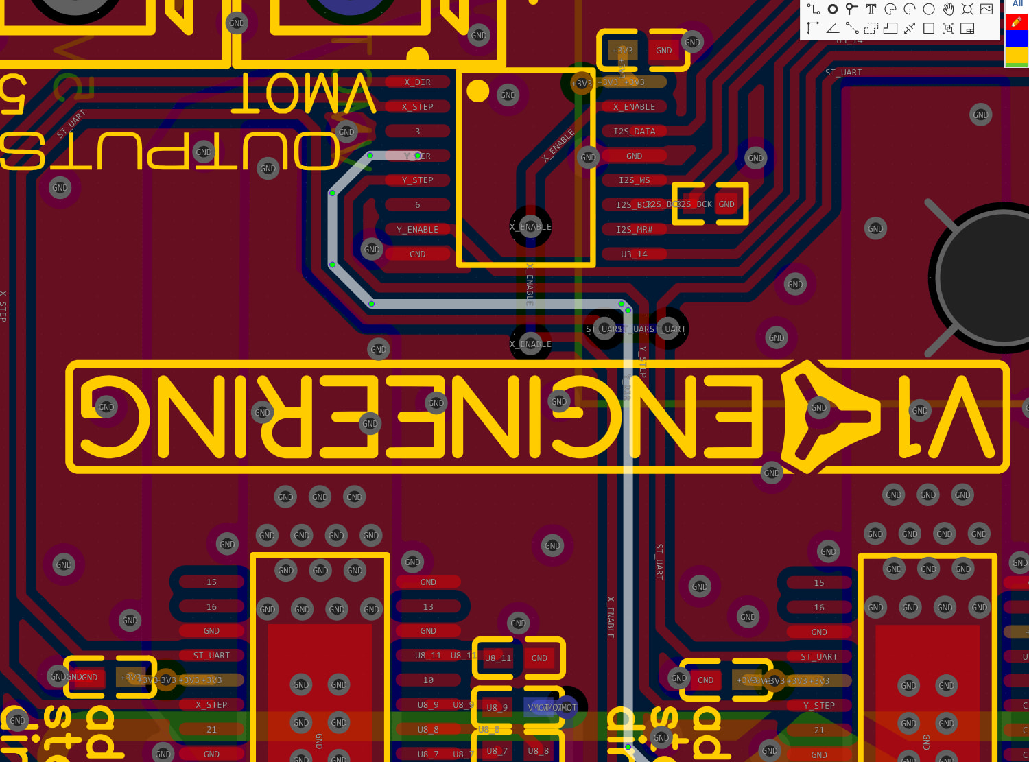

First step, that a real close look at this pin,
This is the pin that tells it to change directions. If there is anything on it at the driver or the other chip it won’t switch. Maybe there is just something sitting on the pins.
If not, I highly suggest, re-flashing the board. Jackpot firmware.
From there we can do an exchange or just swap that driver to the “C” port, that is why we have a spare. That gets you going the fastest, and if you ever find a use for a 6th stepper we can revisit.
