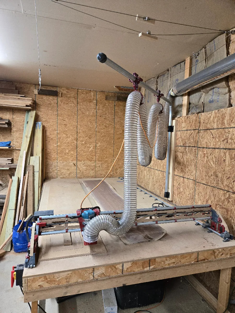

I think I figured out what was going on the dust collection setup seems to be creating some additional drag on the machine when it moving. I disconnected the dust collection and everything seems to work as it should. I was running the cantilever system shown below (not my picture but the same system) with a 4" dust hose. Now that I have unhooked it, i have successfully cut three programs and they return to my predrilled indexing holes with no issues. I’m not sure if the hose is to heavy, the cantilever pipe is binding, the trolly is binding, or if my 900 cfm dust collector is to much suction and pulling the core over towards it.
