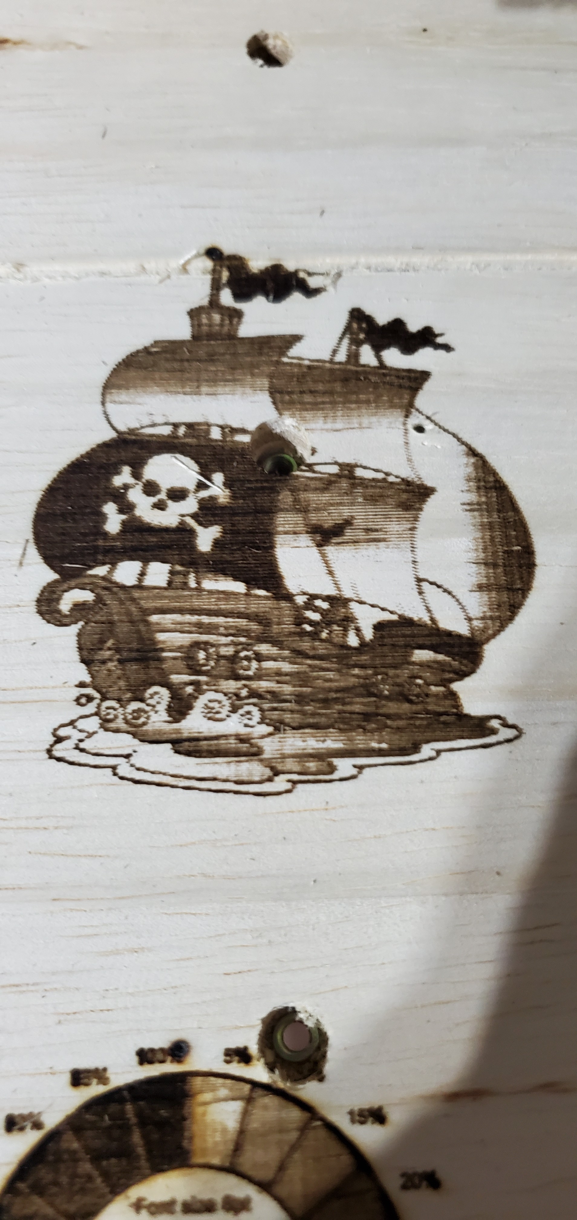

I will definitely look into inline S commands within the move commands with the laser. Ultimately grayscale raster images are what I’m after.
You can process greyscale images two ways, you can either use a constant laser power and ‘dither’ your image to produce a picture of dots that the laser can use or you can scan the laser across your output material and vary the laser power to produce various levels of ‘burn’.

Anywho, this is the build I have M106 controlling the laser.
This is what I am currently working with that just seems to have the issues with stepper noise.
Update: tested with Ryan’s Test gcode. Turned up this.
Update 2: more more things tweaked.
Update 3: Almost there!
