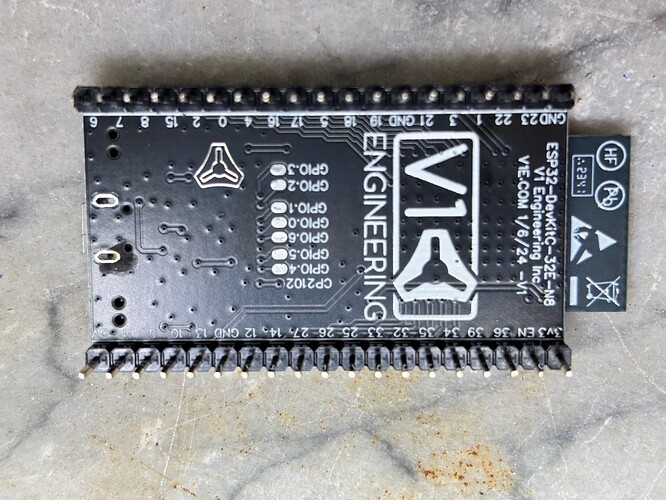

Can you provide pictures of the front and back of your spare ESP-32?
I’ll have to go back and find that pull-up resistor mod and I’ll try it. Couldn’t hurt.
Here is the Front of my ESP-32:
And back:

I’ve now encountered a variety of ESP-32 dev boards. USB-C variants, genuine V1, Generic (sold by V1), generic (Sold by amazon).
Some DO need the pullup mod even off a Jackpot if you want to avoid pushing the BOOT button to laod firmware.
One dev board sent to me for analysis wouldn’t load, it’d been installed backwards on a jackpot. It wasn’t “dead” but it also wasn’t alive in that it wouldn’t flash. I’ll eventually replace the 3V3 regulator and see if it recovers.
You have a genuine V1 ESP-32 Dev board. As @jeyeager notes, this one SHOULDN’T need a pullup mod unless something odd has happened to it.
If your board won’t load with BOOT held in and directly connected to a PC, then I’m starting to wonder if it’s seen its way into a jackpot wrong way round. That’s the only way I know to make them unloadable over USB (Save for breaking off the USB connector).

As I wait for a new ESP32 board arrive from Ryan, I was thinking if I have something wrong with my Jackpot board (v1 with a resistor between the boot gpio0 and the 3.3v pin) then that might explain why my ESPs are getting VERY hot and not working.
If I do not have the ESP plugged in and give the Jackpot 24v should there be 3.3 volts at the 3.3v pin of the where the ESP would be? (And the same for the 5v pin?)
No.
The ESP-32 makes its’ own 3V3 on board from the Jackpot 5V power.
The test I think you should do is to measure the 5V power on the (empty) ESP-32 connector when the Jackpot is powered up from you external power supply. The Jackpot is responsible for generating that 5V source which is what the ESP-32 uses to make its’ onboard 3V3.
Ok. Thanks MakerJim. Just did that test and I get 5 volts. So the board is good from that respect. I’m just scratching my head to figure out what I’m doing that is causing me to ‘burn up’ these ESPs. Once the new one comes in, I’ll just put FluidNC on it with the WEBUI (I did go with v3 due to some of the layout changes that I liked and used better than v2) and leave it alone.
