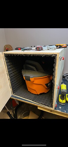

Hi. Plan to use this for my LR4. I made a shop vac enclosure purely for sound suppression. It’s worked well for a year. It’s made of plywood, and sound deadening foam.

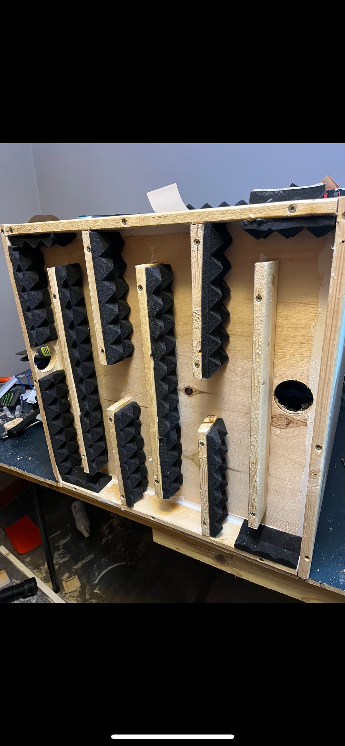

Has some casters so it rolls. And theres a hole where the exhausts goes through these baffles and then out into atmosphere. The baffles are now covered by a plywood sheet obviously.
Is this dangerous at all? I’m thinking it may overheat and cause a fire? Dangerous or fine? Thanks

Shop vacs generally cool themselves with the exhausted air. They can overheat when they can’t get enough intake air, which is why they’re a poor choice for a vaccuum hold-down bed. As long as you are allowing the hot air from the outlet to escape, even through your “muffler” you should be fine. Caveat: any time you restrict air flow through the shop vac, you run a risk of overheating. That setup can allow (for example) the shop vac to fill with dangerously flammable wood chips, and then start to strain with air flow, which you may not hear due to noise reduction. This can allow the motor to reach the flash point of the wood chips (or the paper air filter) and there’s your fire. Of course.tje same might happen with my vac, while I’m wearing ear defenders.

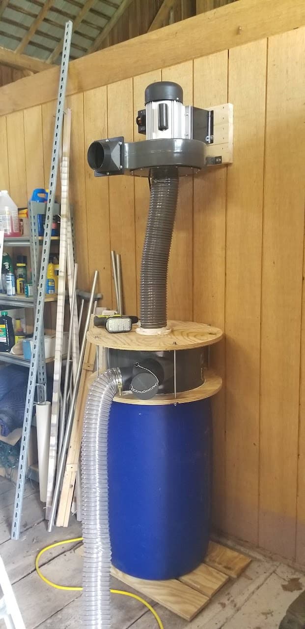

I run mine inside a box /silencer too. It runs a little hot yes but +1y and it still runs hard. (I use mine without filter but running 2 dust separators)

the rigid vacs have their own motor fan, so if the box can’t get fresh air, then it’s just recirculating the same hot air over and over.
I ran one of those for my lowrider when I had a barn. Worked great. They’re still loud, but it’s a different sound.
I prefer the dust collector. I have a smaller Jet, but will switch to the HF at some point. I’ve been happy with the amount of dust it collects at the shoe, especially with the 2.5” hose rather than the old shop vac hose. I’m not sure its actually any quieter.
But the sound is quite a bit lower pitch. This allows me to hear the cutting sound better. I do think there is a lot to learn when the sound changes. Potentially if I act quickly I can save the cut with a timely change to a sharper bit or other intervention.

Yikes. Well the outlet to the rigid goes through the baffles and out to the atmosphere. and of course, the inlet comes from the suction. Are you saying there is a dedicated fan on the rigid that has an inlet and outlet independent of the suction and exhaust that will be contained in the boundaries of this box I have built?

Yea, pretty much any modern shop vac that costs more than $50 will have a separate cooling fan for the motor. Otherwise you’re just blasting the motor/bearings with dirty air.
Oh got it. So it’s basically standard now. Good to know. Well, I’ll take a temp reading next time after some usage and see what it is. Maybe contact the manufacture and see what they think. Of course theyll say dont do that! hahah
