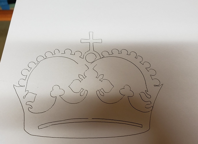

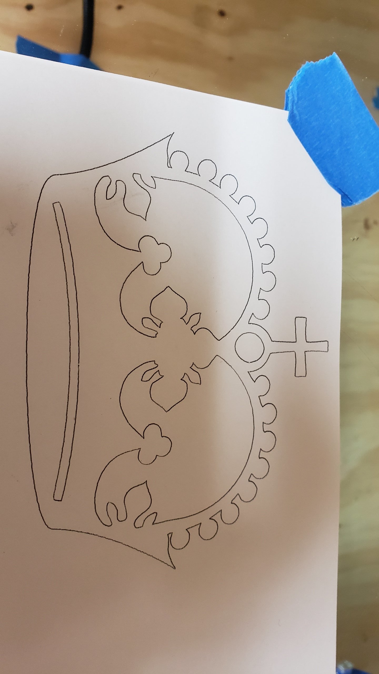

Is this crown test good enough?

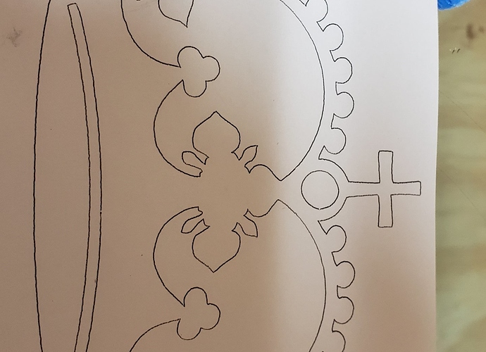

I just printed the crown test with a sharpie. I noticed a couple spots where the marker seems to be a little off, but I’m not sure if that’s because the marker is moving a little bit because the pen holder is somewhat flimsy, or if I need to calibrate more. What do you think? I printed the crown twice and the results were exactly the same.

Lets see the pen mounted up.
Dang. Too late. I already took the pen off. I’ll put it back on later tonight and run another print.

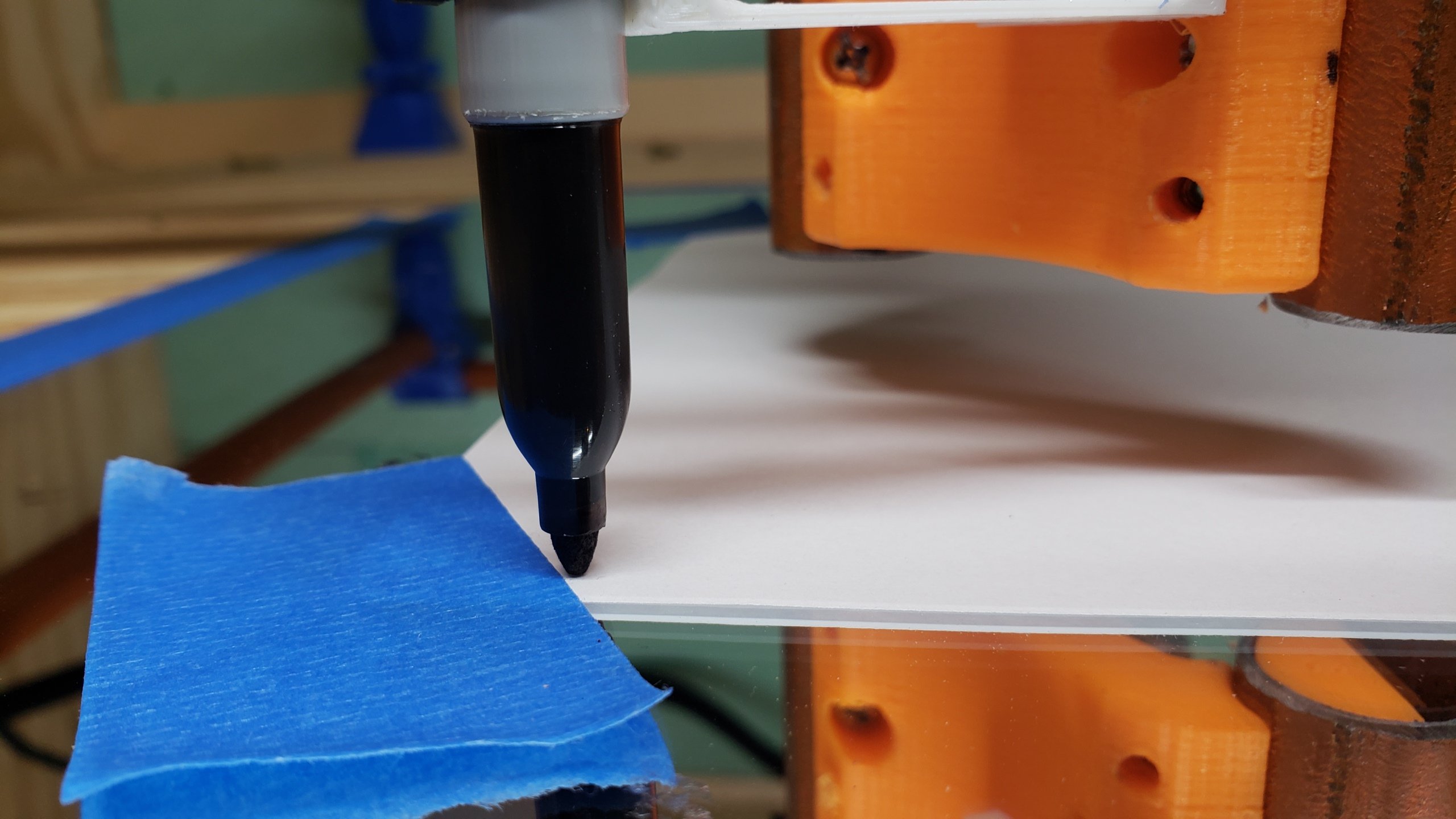

Yeah, something is definitely not right. Here’s a video of the entire print…
https://photos.app.goo.gl/zRmziM9fB4V2736M8

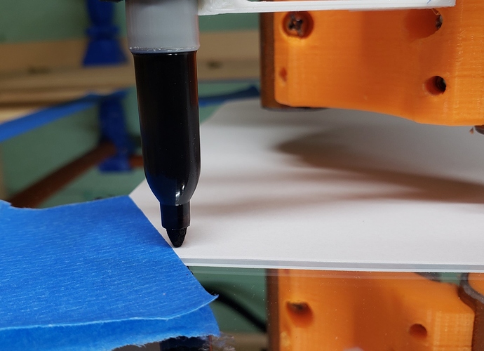

Here’s the pen at origin…
[attachment file=81569]

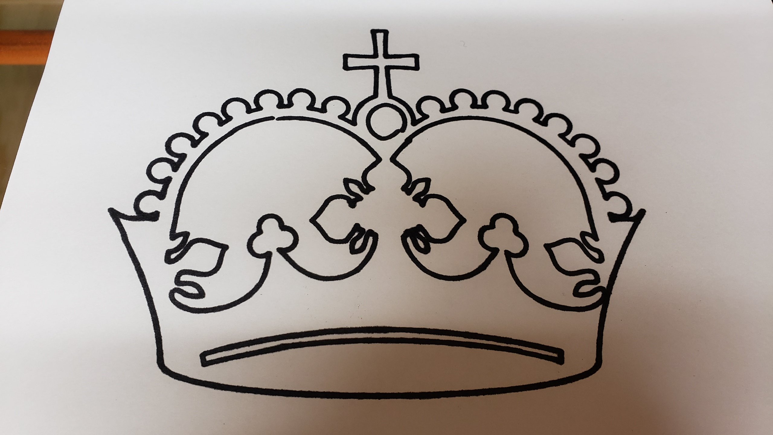

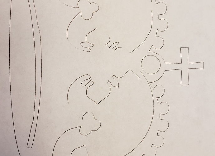

Here’s the final drawing…
[attachment file=81568]
It looks crooked to me.

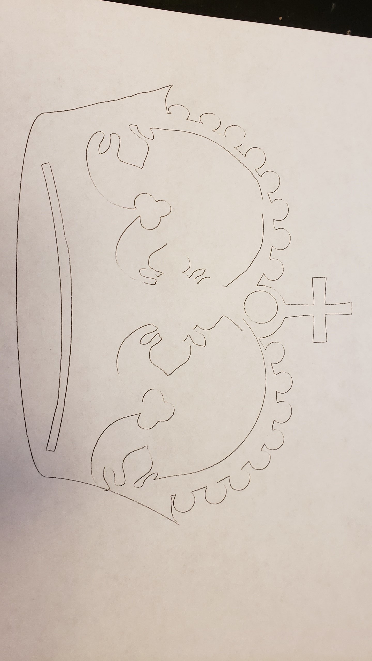

Try a ballpoint pen.

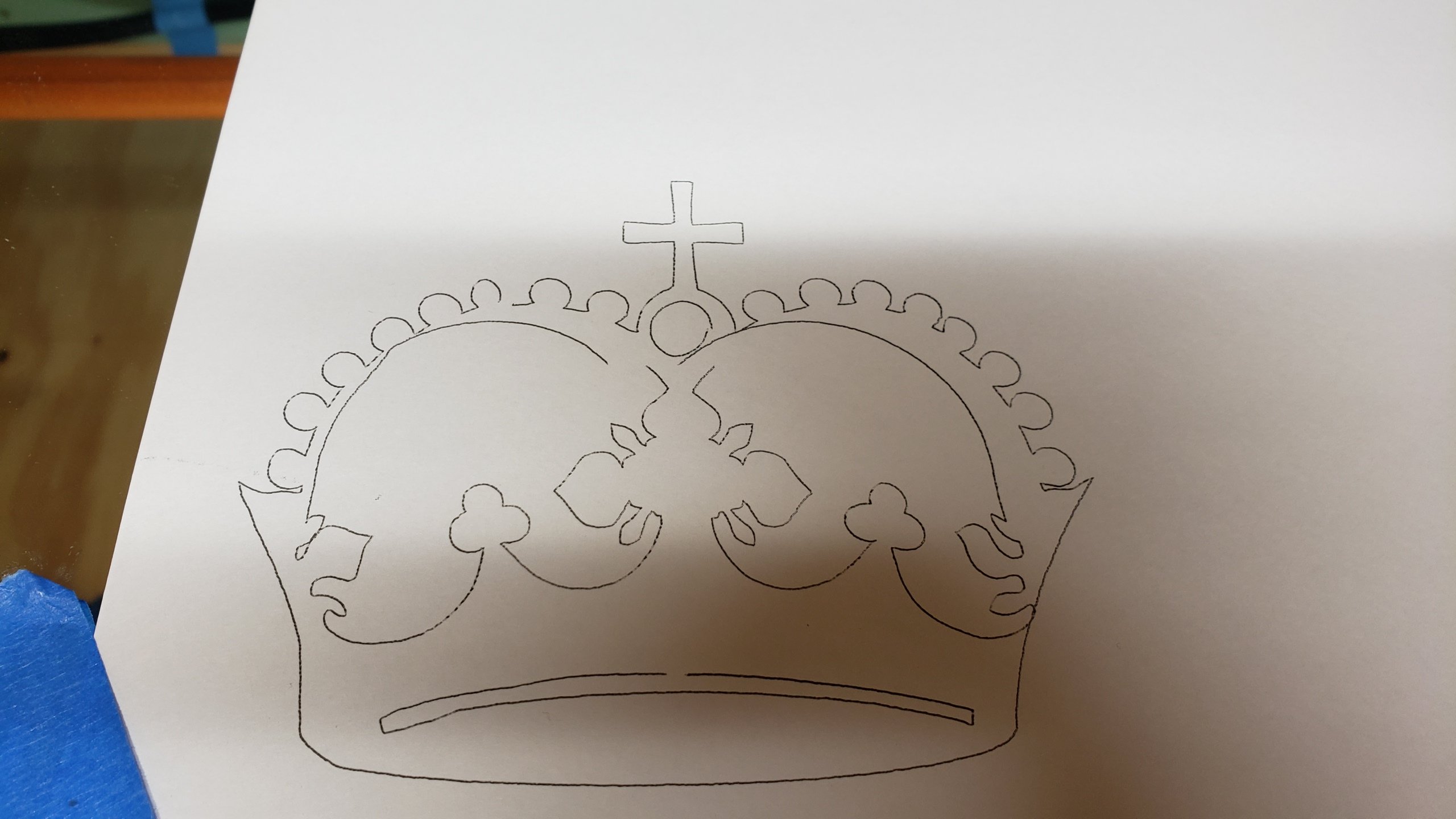

The only ball point pen I could find was kinda crappy, but something is definitely off with the drawing…
[attachment file=81594]

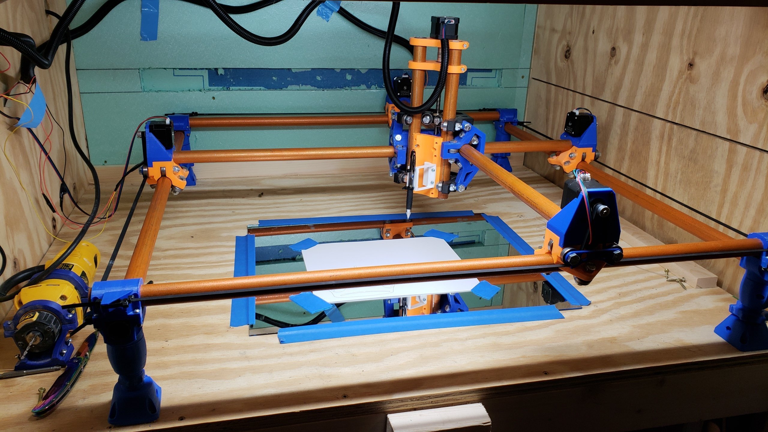

How about a few more pictures of your build. All I could see in the last one was the tip of a pen.
You are using MY gcode correct?

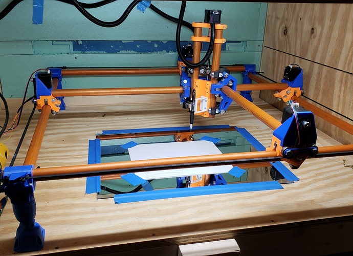

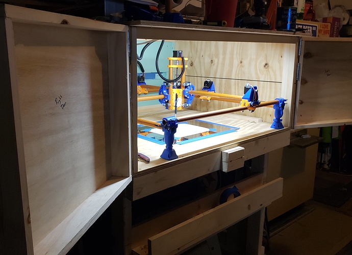

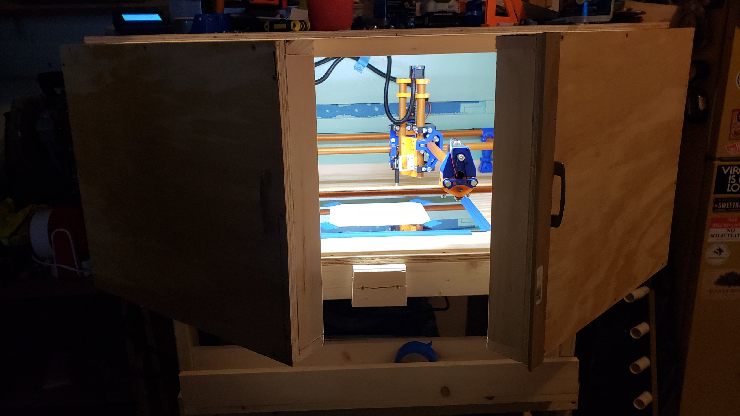

Here’s the build…
[attachment file=81607]

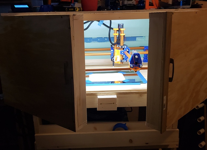

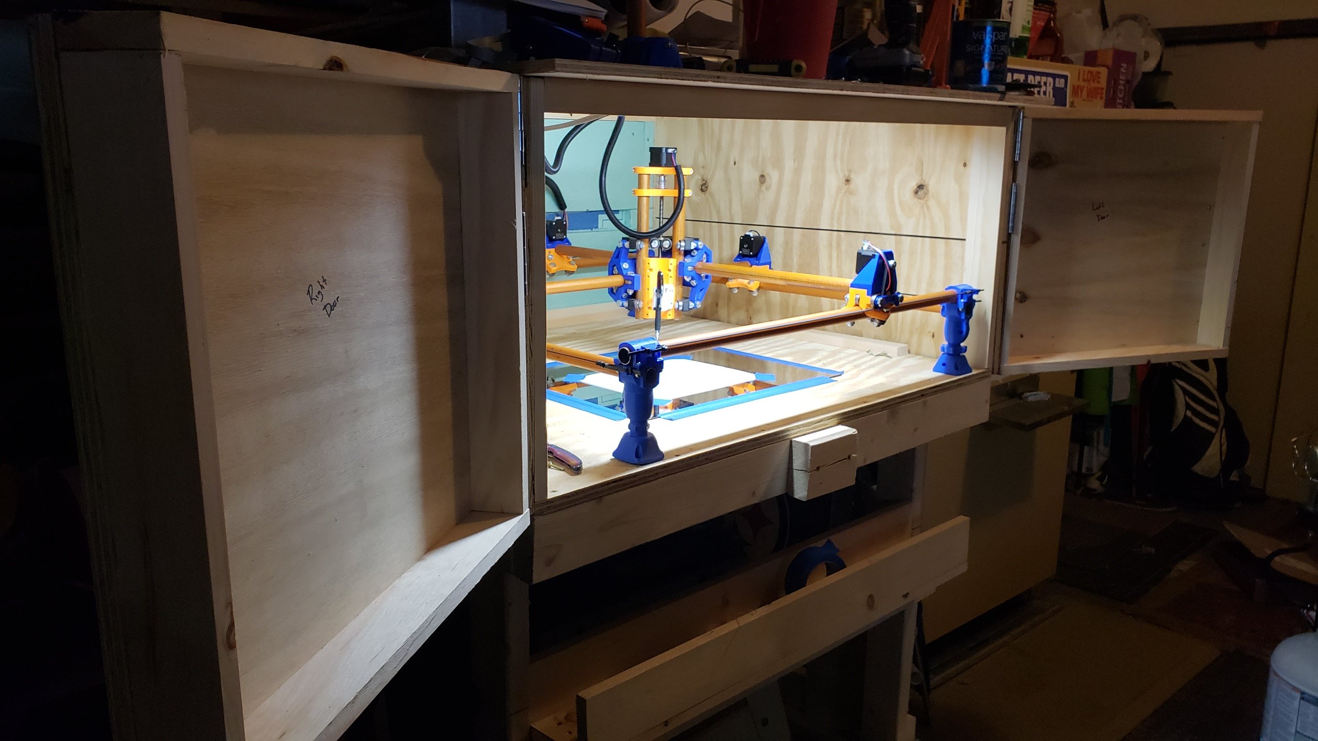

I built an enclosure, which isn’t quite finished, but I’m getting there…
[attachment file=81610]
[attachment file=81609]

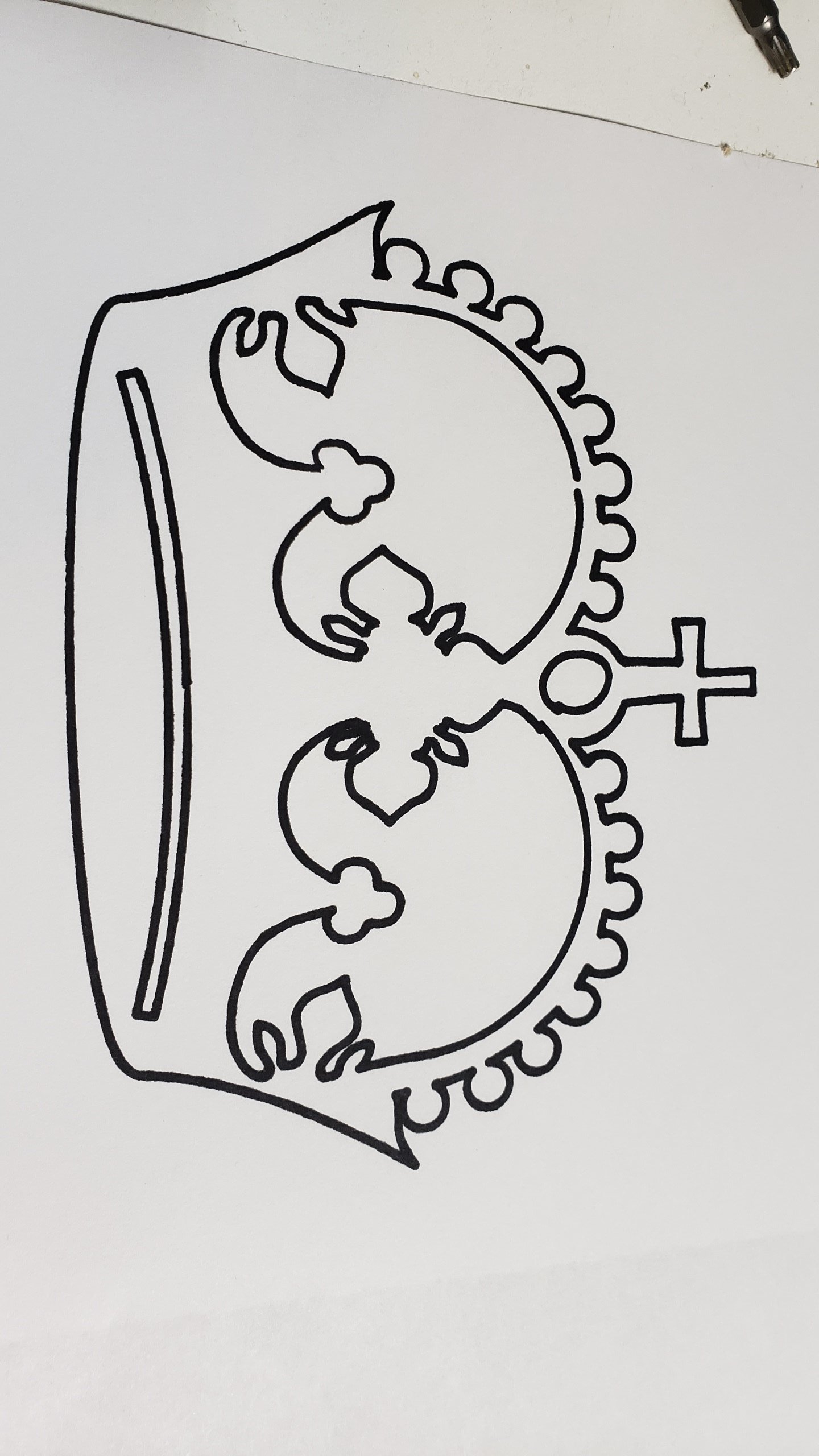

I was creating my own gcode with ESTLCAM, but I just printed another one with your gcode. It’s worse :frowning:
[attachment file=81608]
The only issue I see is the feet/legs. 3D printed legs are kinda iffy but the feet do not look to be attached and if they are they are not on well enough. All starts with a solid foundation.
Surprisingly, those legs are solid. I printed them at 75% infill and they don’t budge at all, so I’m pretty confident that’s not the problem. Good call on securing the legs though. I pulled up some of the screws when I was building the enclosure and left a few of them out. But, after putting the screws back in the leg bases, it’s still printing a bit crooked. So, I decided to check the squareness of the build. Sure enough, I’m 1/2" off. I don’t know how I screwed that up because I measured for squareness at least 10 times before. But, it is what it is.
Now my question is… what’s the best way to re-square now that the whole thing is together? I removed all of the leg base screws and loosened the screws that tighten then corner pipes, but that doesn’t seem to do the trick. Do I need to mess with the gantry? That would totally suck because the enclosure really limits my access to it.
That should do it.

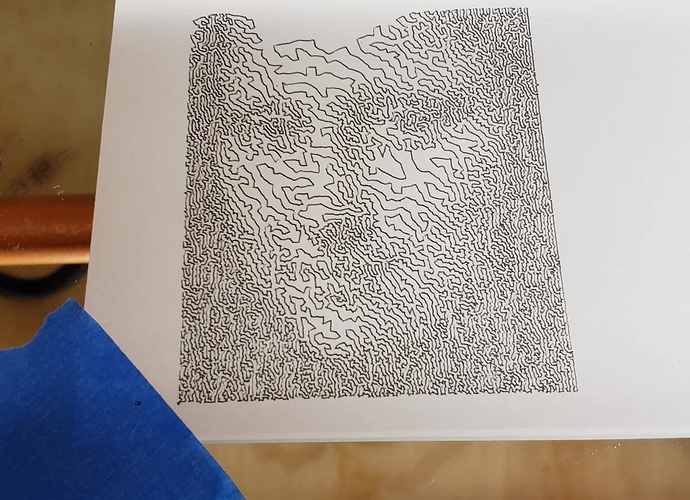

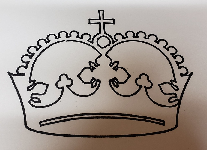

I think I figured it out! Turns out one of my stepper motors was bad. I replaced the motor and here’s the result…
[attachment file=81672]
Winner?
Definitely much better

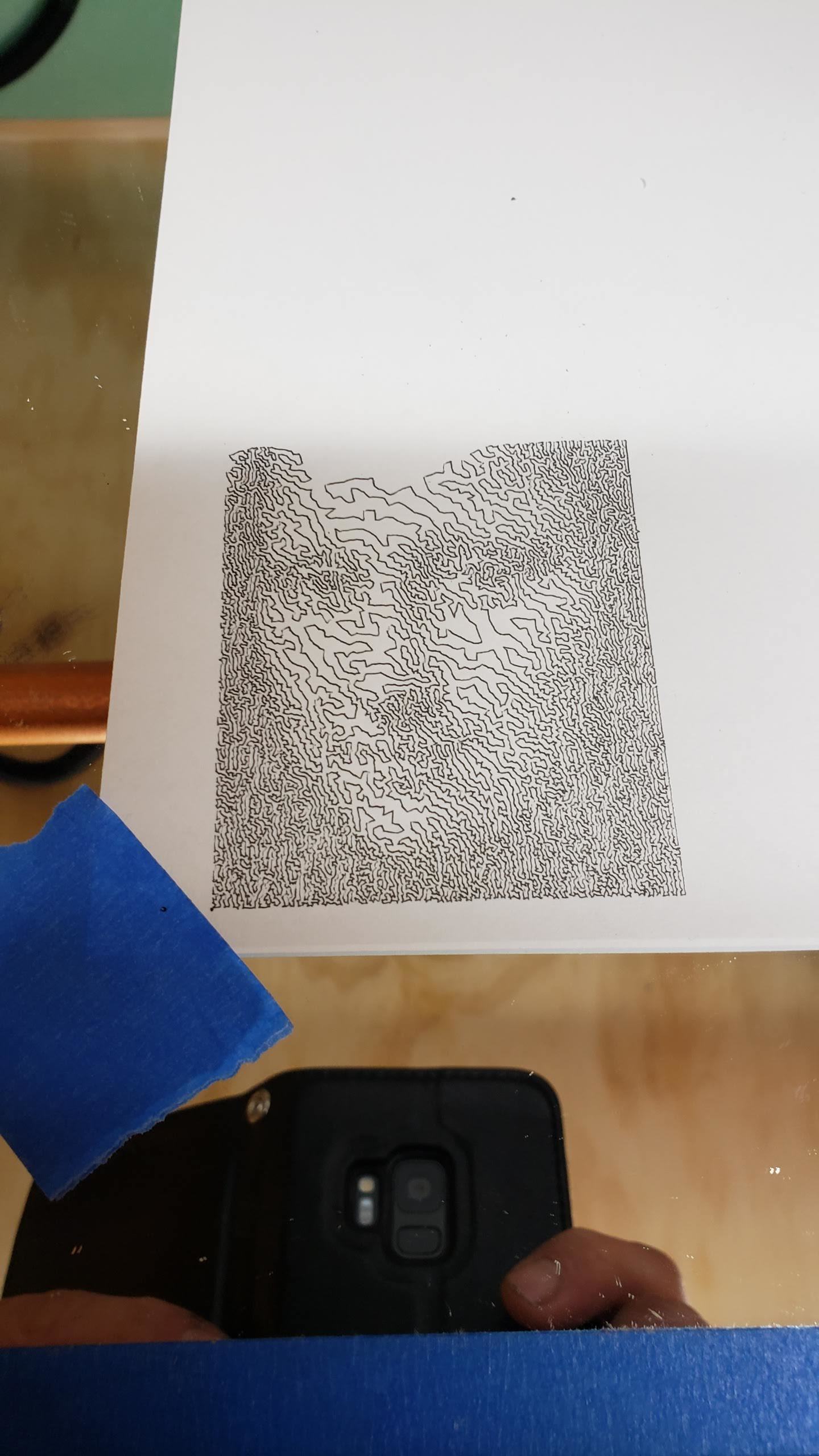

I upgraded from the crown the the Mona Lisa :slight_smile:
https://www.youtube.com/embed/X69RiUqtjlY
[attachment file=81853]
Much better. I suggest cutting or drawing a 3" square or circle, and also a rectangle or square as large as your machine can make and see how far off they are in X, Y and diagional dimensions.
