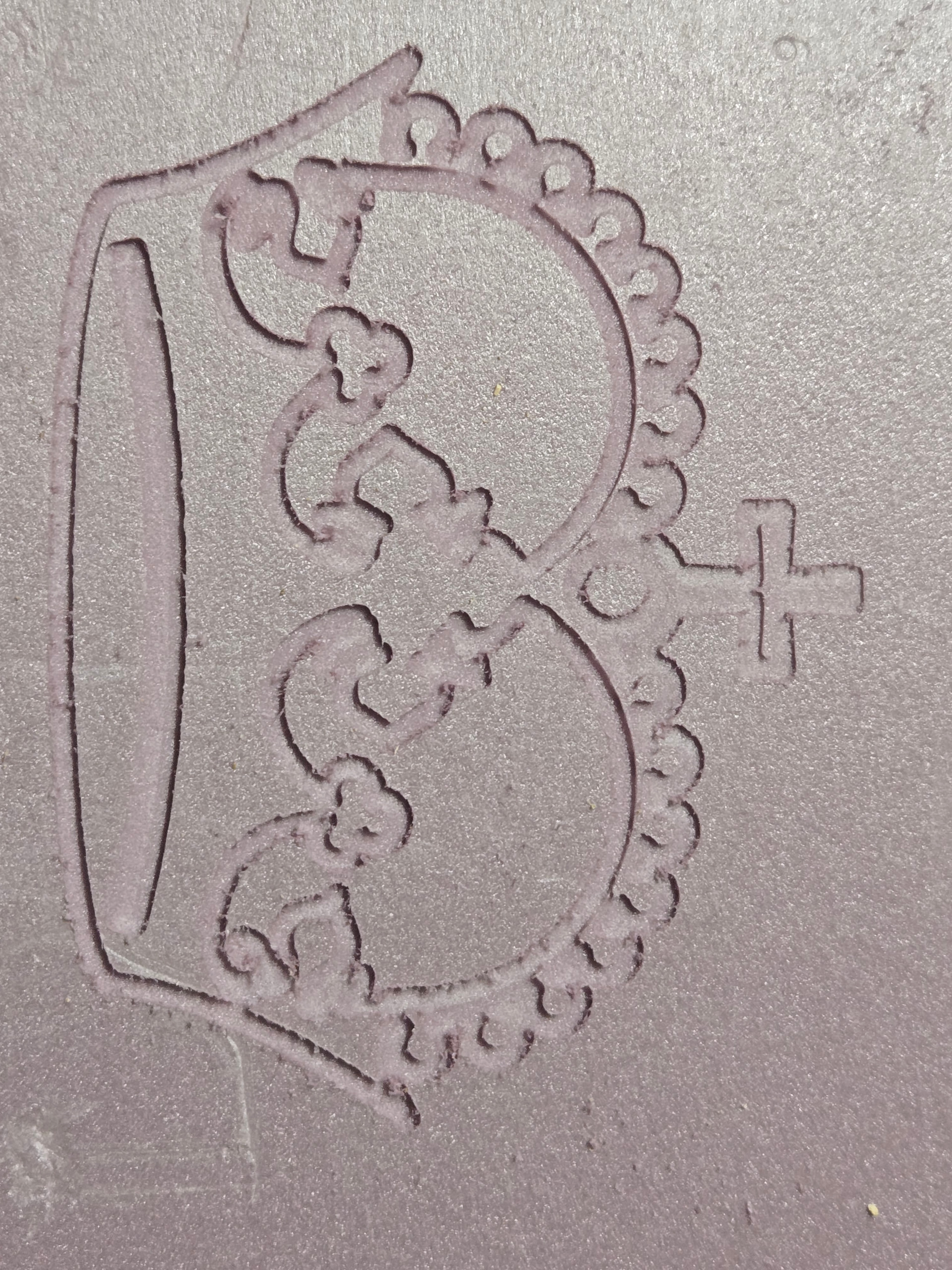

Is this a Trimming issue?

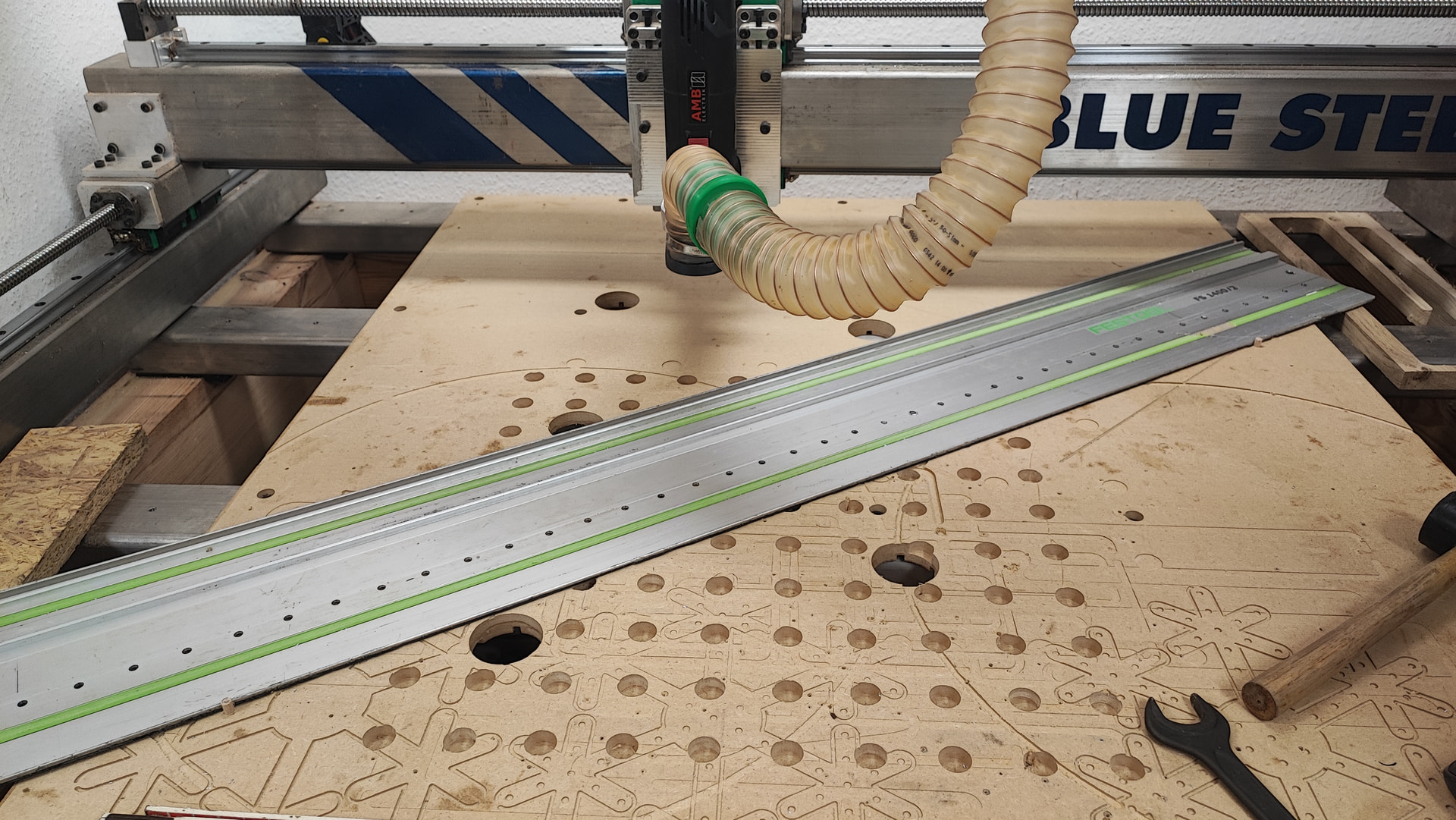

I told you what to do with the piece of foam, you basically do the same with the whole spoilboard. You put a piece of 18mm MDF in the size of your cutting area on your baseboard and then plane it.
After that you have a surface that fits your machine. Don’t move the Z endstops afterwards!
You can see it here: the MDF with the holes is my spoilboard, planed down with the CNC.

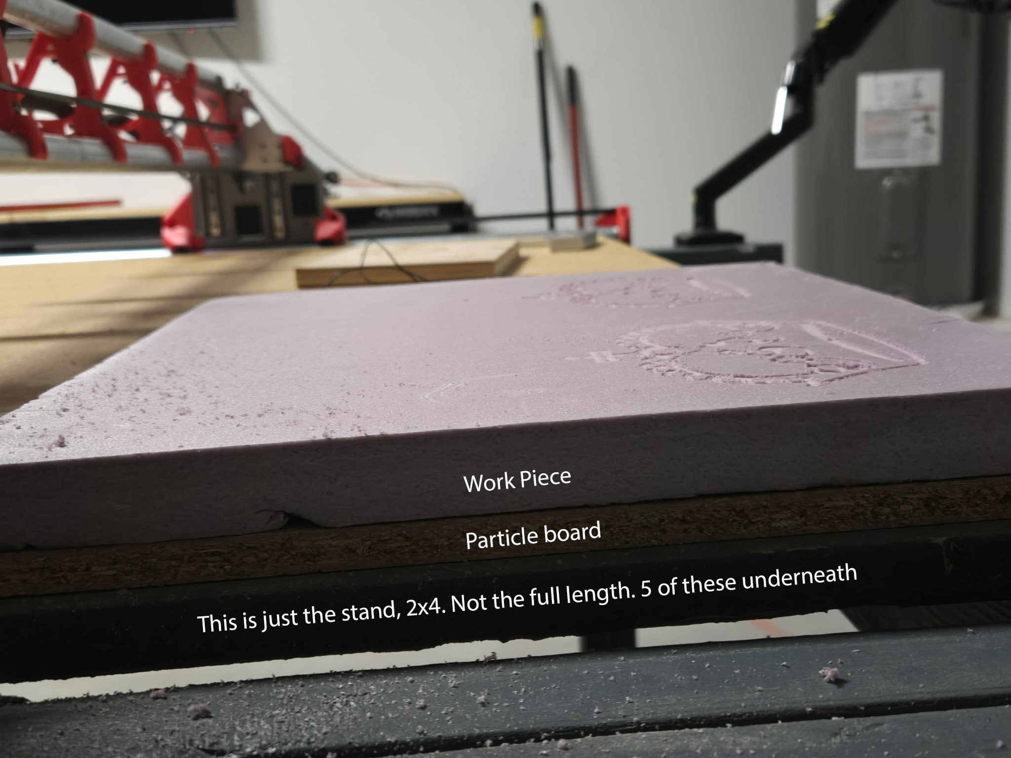

Yep that’s a lot of gap! That’s similar to how mine looked and I also couldn’t carve anything. For my table, the table top sits on top of a frame made from 2x4s. I added shims and cards to any gaps between the table top and the 2x4 frame.
I basically did it for a bit, checked for flatness, and continued until the light gap was less than 1 mm in height. In my experience, I had to be underneath the table and push up against it to give some room for the shims to slide into place. Keep in mind you’re adjusting on a mm scale so you probably won’t even feel the table top flex when you push on it, but you’ll be able to squeeze a couple more playing cards in there.
I’d 110% do this before trying to surface anything. Table needs to be flat for anything else to have a good chance of success IMO.
@Tokoloshe I read this as I put “baseboard” down first, then a 18, MDF on top of it and pane it. Then my work piece on top of the 18mm MDF (that’s just been leveled)
I bought this from 3rd party and they have just some particle board down and I’m putting my work piece on top of it.
If it was me, I would surface (flatten) the particle board, then put the MDF on top of that as a spoil board, with the work piece on top of the spoil board.
But putting the spoil board on top of the particle board and surfacing the MDF would work as well

I think i made progress!! My wife and I removed the particle board and come to find out, there is a base board under it thats part of the frame/table. So, we flipped the board over and squared it up, but did not need to surface it I don’t believe. I checked it in like 20 places and it seems good.
We added the foam back to the home area and did 2 perfect runs, :clap: :clap: :clap:

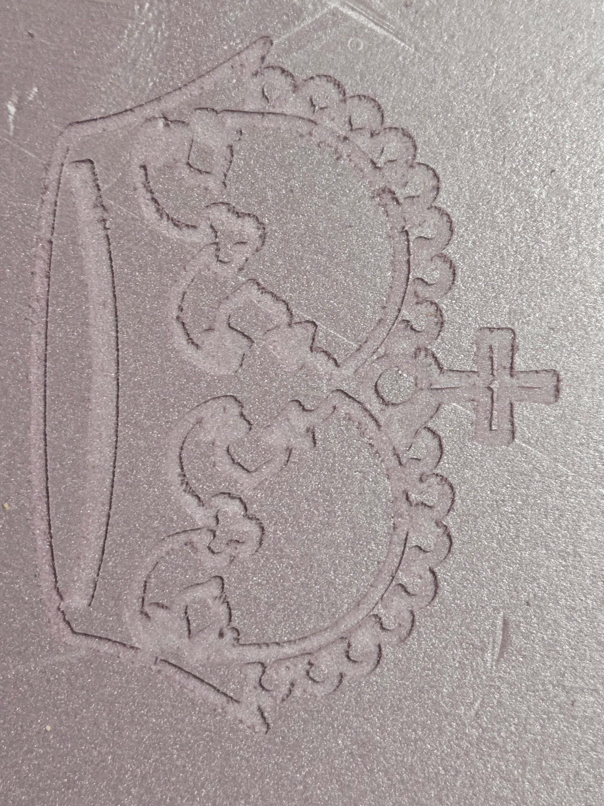

Sad news, when we put some used wood down to test again, it came back uneven. :cry:

Pictures of the foam (2x)
