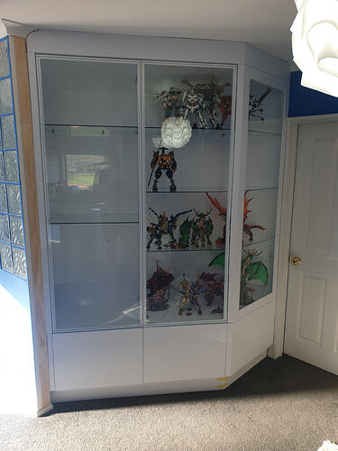

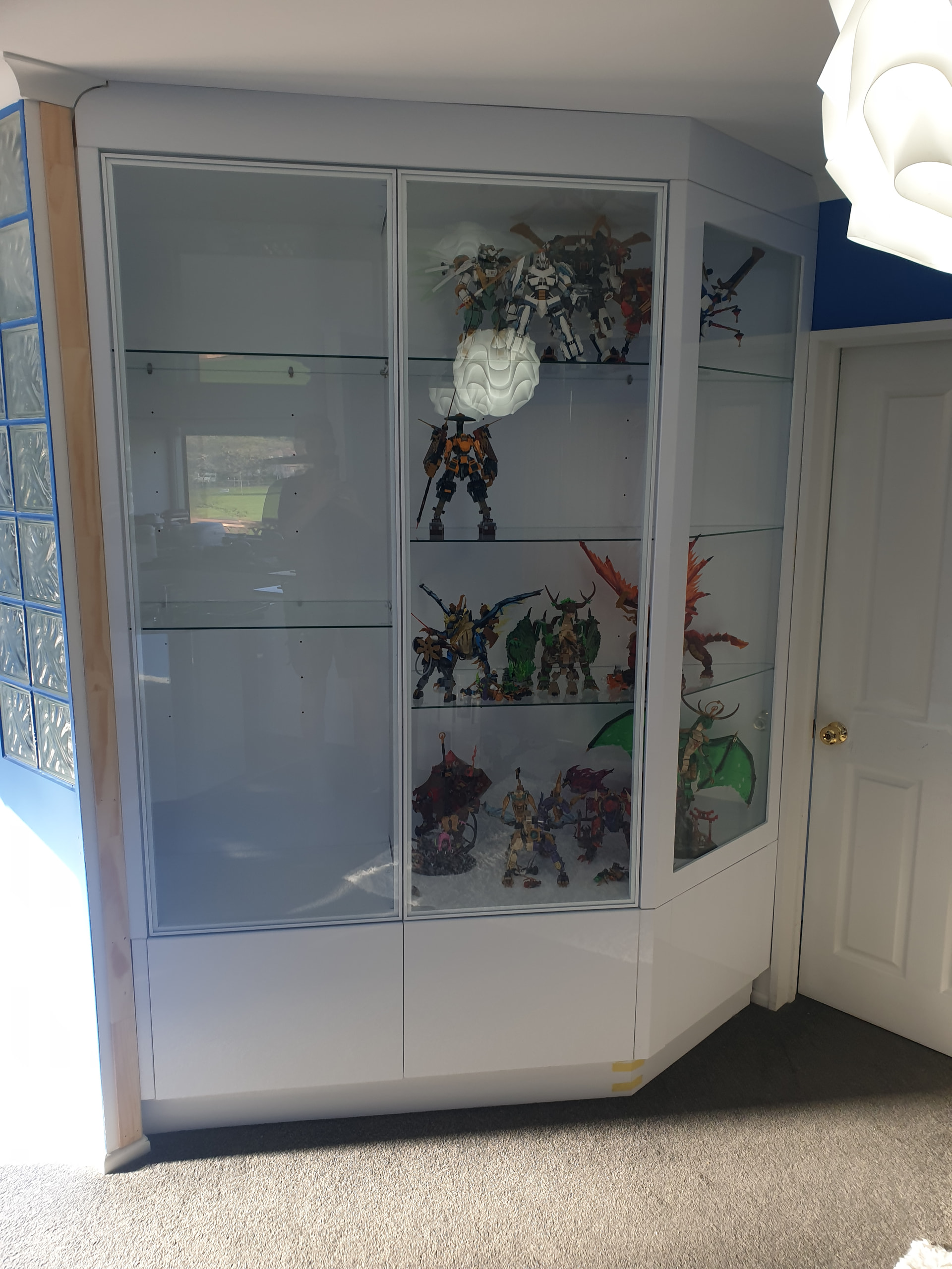

this is a cabinet i just finished for a customer

Man, this looks insanely good… Wow…
Wow that’s super impressive thankyou

thanks so much , it was one of those projects that became a luv hate one,
