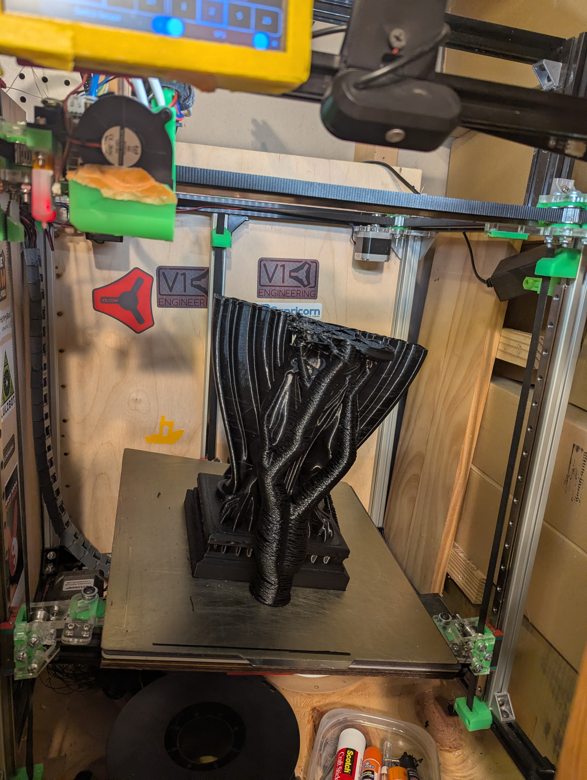

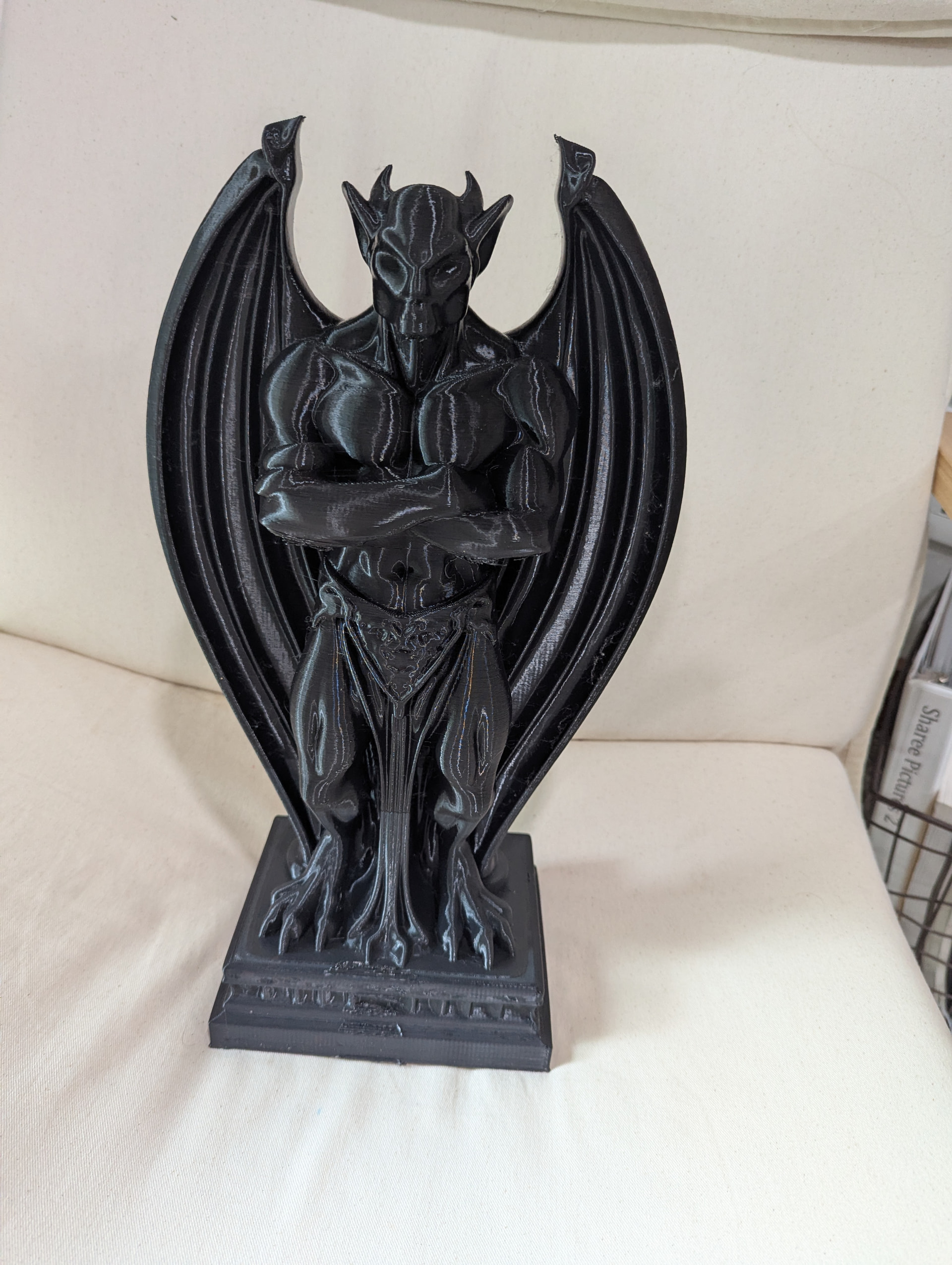

My lr4 just works now. It has not always been like that. My mp3dp printers (both) are like your lr4 experience, though i have had seasons of long runs on those. Fix one thing, break another… I printed this thing first try last week:
The extruder gear jammed and this picture above was taken after cleaning spaghetti (orange tape quiets a harmonic at high speed).
I finished the top after the 5th try and glued it on. Moral of the story: grit, tenacity, persistence may be required to get through it, but you will get it dialed in. The machine has good bones. Most of the issues can all be attributed to build quality of components I selected. Keep at it!
