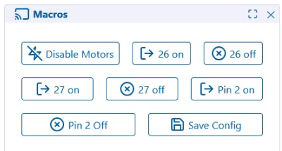

Ok so I got the iot to trigger but its just for a split second. How do I keep it on?
Its like hitting the pin 27 on macro doesn’t stay on

So, when touching 27 on, it just comes on for a second and then goes off? Sounds like the board isn’t holding the power. I am on a Jackpot 2 and it works fine.
Colin_S
(Colin S)
February 18, 2026, 7:55pm
11
Ya, I click them macro button and I hear the vacum start up for a second and then turn off. Same with the light on the IOT relay for indicating when the relay is pulled in.

Does it change anything if you have nothing plugged into the outlets?
Watch the terminal to see if there is any errors

Sorry for wasting your all’s time. It was my fault. Had the power to the board plugged into the nomally on outlet. It works now. Sorry!
