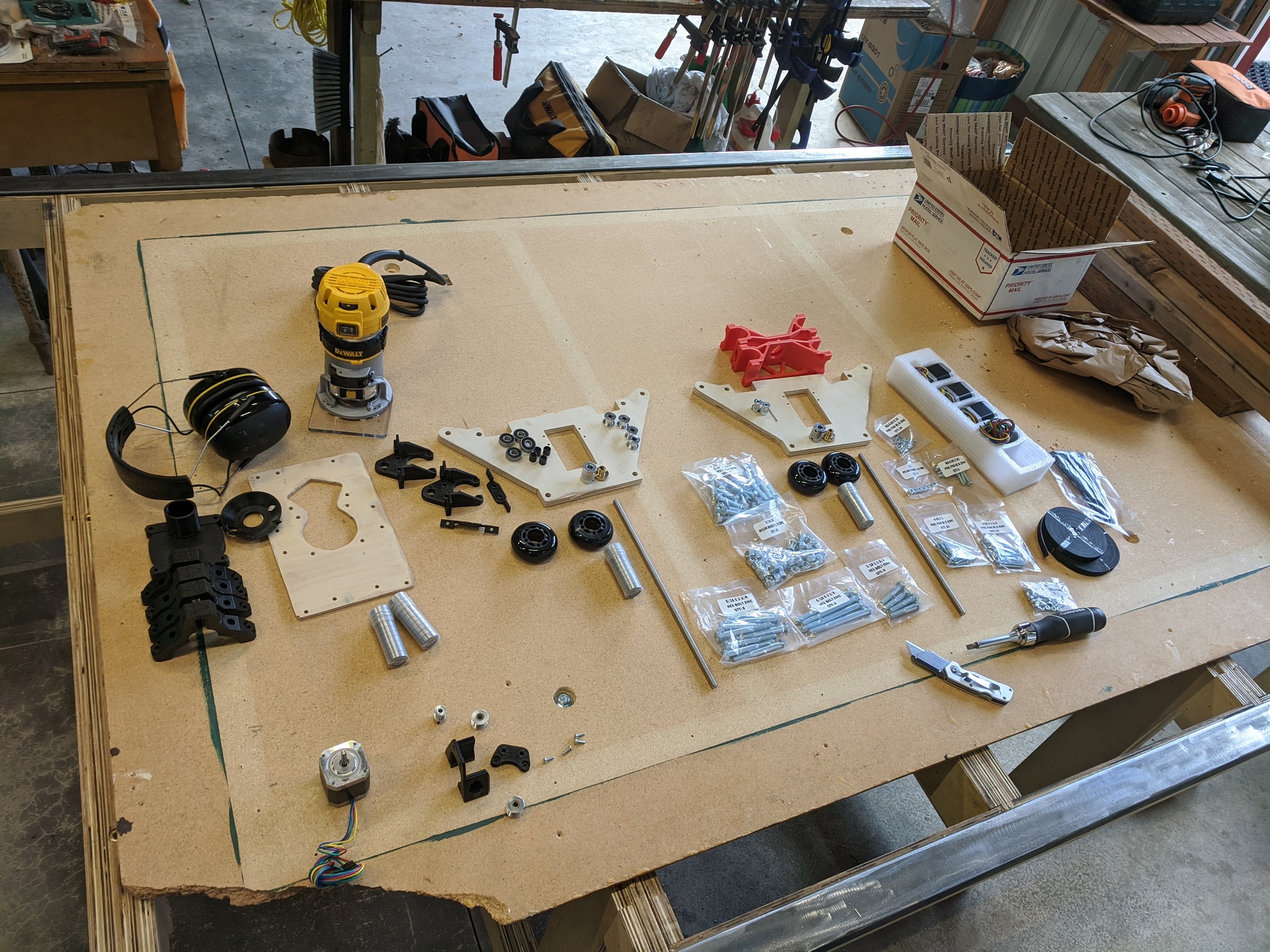

I am using 5/16 threaded inserts to attach the spoil board to the frame. The idea here was that attaching in the end grain of the plywood was likely to cause issues from repeated screw/unscrewing, also as a way to level the spoil board if needed. Each X-axis span has three inserts.
This was my test piece, and has the best detail:
I was starting to get excited and stopped taking progress pictures. Each side rail is ‘capped’ with 2 inch angle iron. This gives a solid (and continuous) top and side surface. These rails are leveled and squared as much as I can get it. Over all there is only a ~5 mm difference between the rail widths from front to back. I was pretty happy with that result.
You can see the rails installed as I started to assemble the gantry.
Almost ready to test:
I purchased longer lead screws and additions belt to accommodate the larger table, but I didn’t really think about the stepper cabling, that is going to need to be modified, things are a little too tight for my preference.
