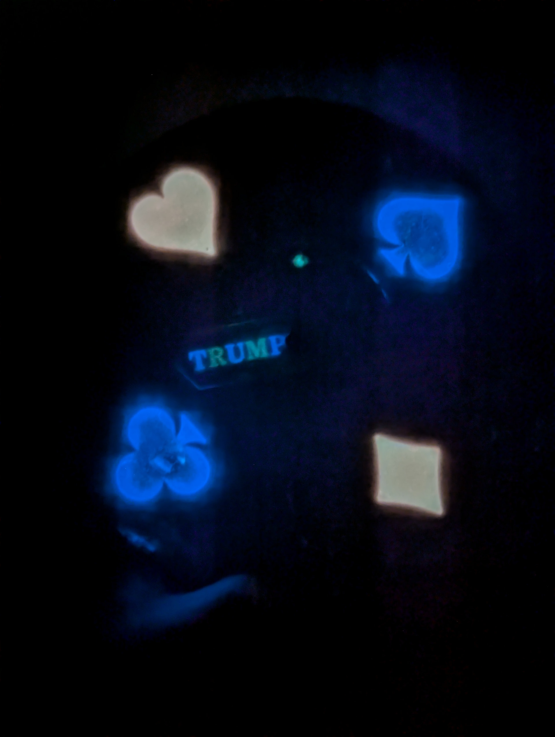

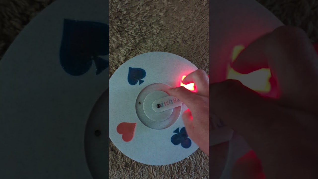

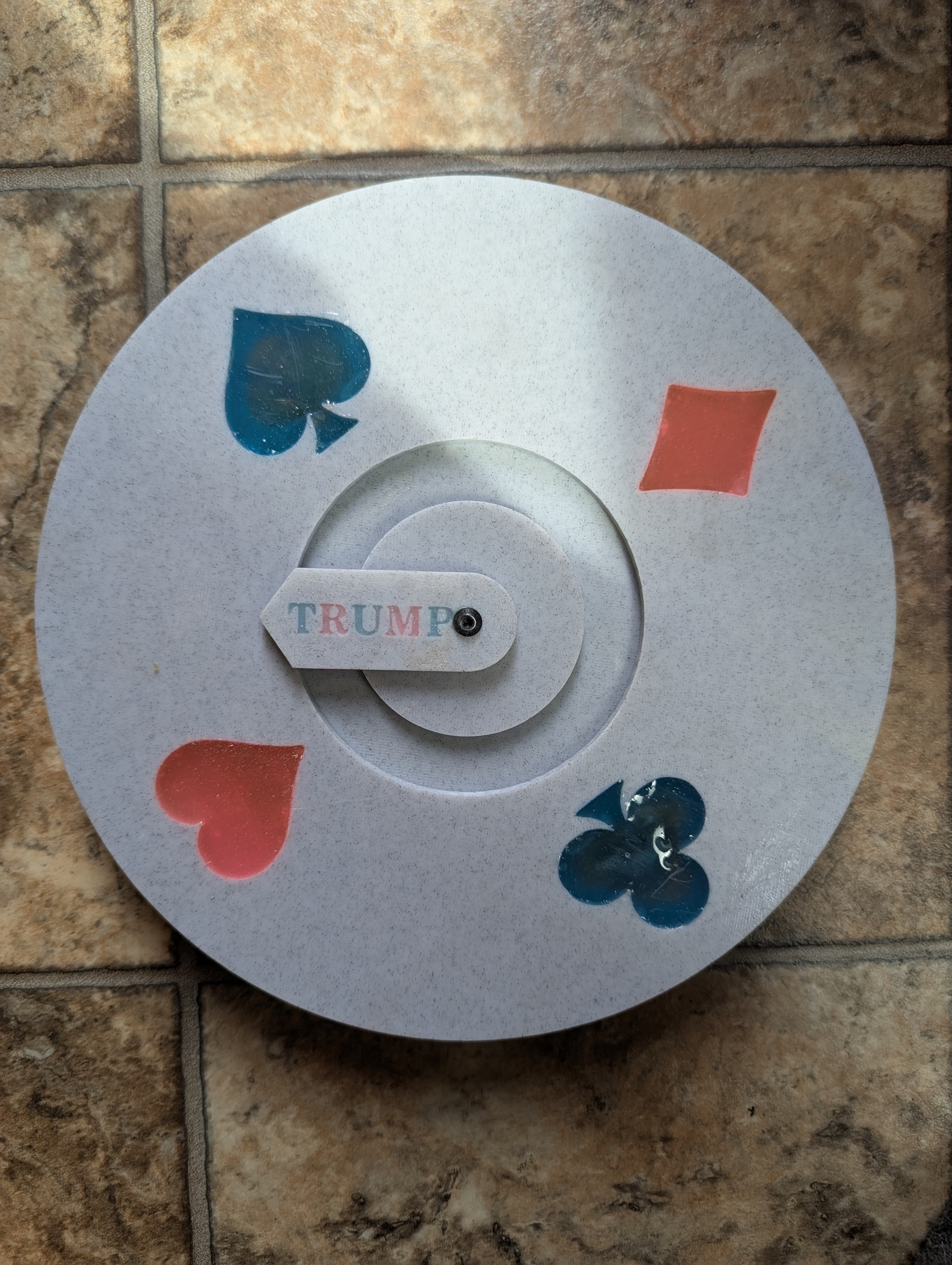

I didn’t use any V1 CNC machines in this design but it only happened because of the ideas, knowledge, and help that float around in this forum.
The awesomeness of Ryan’s designs and the cool mods people model on top of that inspired me to start using fusion 360 more often. One member mentioned user defined parametric variables (or something similar) which made revising models so much easier and therefore more likely to try in the first place. So I designed all the case, lid, and indicator from scratch.

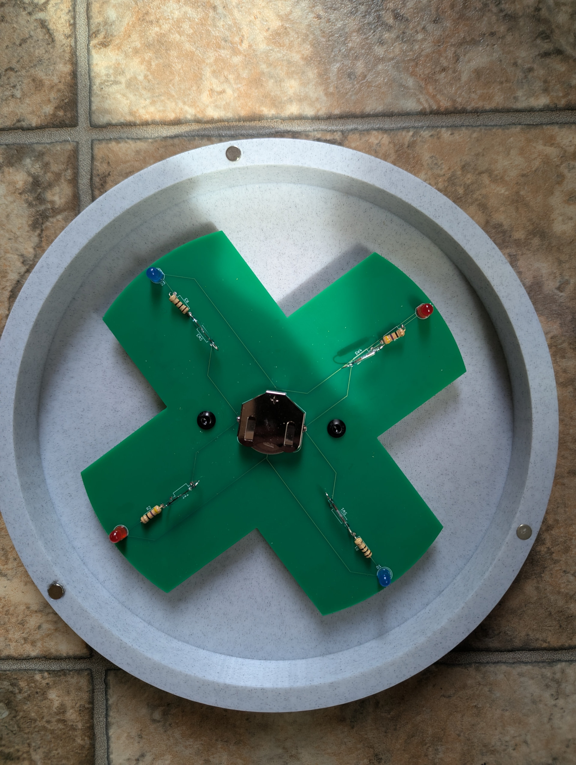

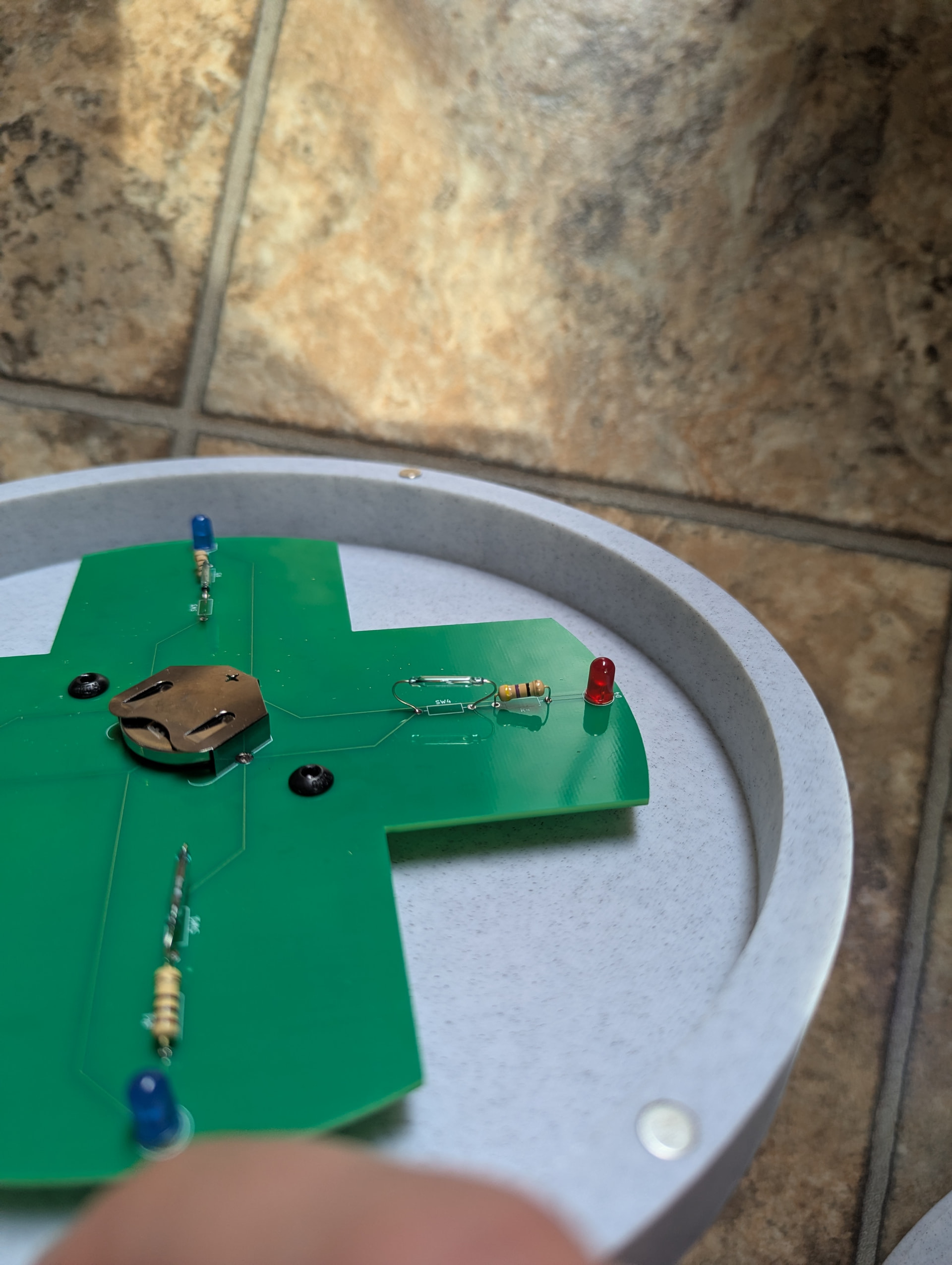

Various people talking about designing circuit boards made it seem like a feasible task. I downloaded Kicad and watched an hours worth of videos to get my first design ordered from JCPl.
Soldered it all up, badly, and pounded in the magnets to see it all work!
A bit bigger than I was expecting but I have the tools to make it smaller if I wish quite easily. Thanks for all the inspiration!
Reed switches on the circuit board (picked too short of a component but it works), LEDs, resistor, and cr2450 battery. Magnets for the lid snap and in the twirly indicator to activate the switches.
