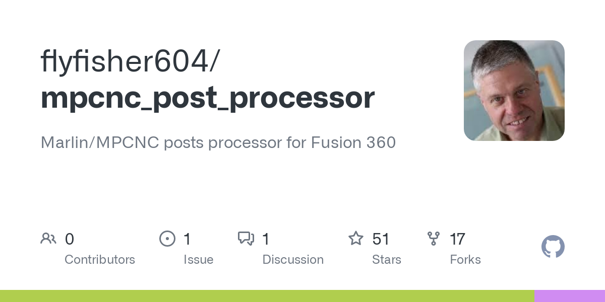

Now that I can toggle my router on with “M106 P2 S1” I’d like to automate things and put that into my Gcode files. Does anyone know how I can have the post processor add the M106/M107 lines into my Gcode?
I’m using the Flyfisher604 post processor from here:
Thanks in advance!

For Fusion 360 and the referenced postprocessor, you must put your code in text files, then you reference those files in this section of the postprocessor:
Start and Stop commands much each have their own file. You can author these files in any text editor including Notepad. There is one catch (at least when I set my files up). These files must be in the same folder/directory where you save your g-code files. These fields will not take paths. I have two places where I save files…a subdirectory on my desktop computer, and directly on the SD card I use to run CNC jobs. I have to have a pair of files in each place, and I have to remember to edit all four files when I want changes.
Repetier-Host has its own Start GCode and End GCode sections, so if you are using Repetier-Host to send files to your control board, I would recommend adding the commands there rather than Fusion 360. I use a SD card, so I must use the external files.
Tip: You must have a newline at the end of the last line in any Marlin g-code file. If you don’t, the last line will not be processed.
I’m surprised the “S1” in your “M106 P2 S1” works. I would recommend changing it to “S255”. The S parameter is a PWM value in the range of 0 to 255.
Edit: You might want to test if the Extern files now accept a path. This postprocessor has been substantially rewritten since I set up my Fusion 360 process.

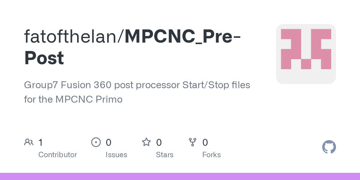

Robert, I thought I’d follow up on our conversation about the start/end files and outline my process in case anyone else was curious. I did create start and end gcode files and entered them into the Group 7 settings. It took a couple of iterations to do what I needed it to do, but it’s working quite well now. I put the files on Github if anyone needs them:
Thanks again for the help!
