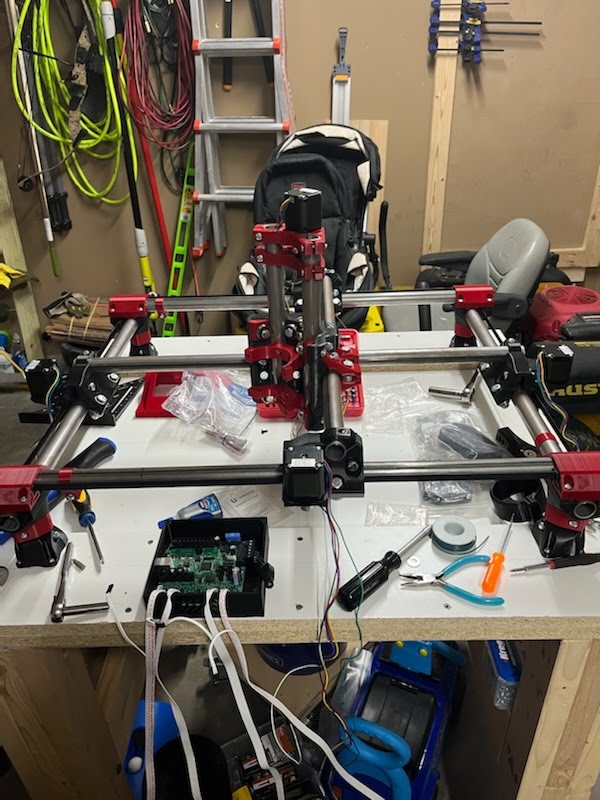

Here is some of my wiring setup. I just got the LCD to work.

The wiring harness’ are setup according to the picture:
X1 = front X stepper
Y1 = left Y stepper
X2/E0 = back X stepper
Y2/E1 = right Y stepper

You have helped tremendously! I went through and did a continuity check on all wires. Went to check each axis and movement and finally saw one side worked (x axis). The y axis didn’t work. I turned it off and switched the plugs around to check and when I did that the y axis didn’t chatter like the other times, but the x axis chattered. The y axis was backwards at that point.
From all this I realized the plugs to the board don’t sit correctly. So I plugged them in and taped them to the table so they wouldn’t move. They were then straight up and down to the board. This seemed to be the problem the whole time.
I will have to find the right connector to plug the steppers into the board.
