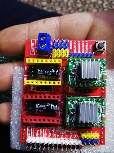

Hello my friend, I hope you are fine, my friend. I have a panel mach3 and a cnc a4988 shield. I want to connect it as it did, but I could not understand the delivery method because of the difference in yields. So, I ask you, my dear friend, to send me the connection diagram between the two panels if possible. Part of the photovoltaic production line I would be very ripe for you

I have given you the wiring on your other posting Qasim
XP to X STEP
XD to X DIR
YP to Y STEP
YD to Y DIR
ZP to Z STEP
ZD to Z DIR
Connect ENABLE, MS1, MS2 and MS3 to VDD on the A4988. connect SLEEP to RESET, connect the stepper motor to 1A, 1B, 2A and 2B, connect your 8 to 35V supply to VMOT and GND and a 5V supply to VDD and GND as per this diagram.

Hi Mr. Mike, thank you very much, but I have a question. Is Xd the same as Xdir and Xp itself Xclk
I would read that as
Uno shield Mach 3
X step = XCLK
X dir = XDIR
Y step = YCLK
Ydir = YDIR
Z step = ZCLK
Z dir = ZDIR…and so on.
