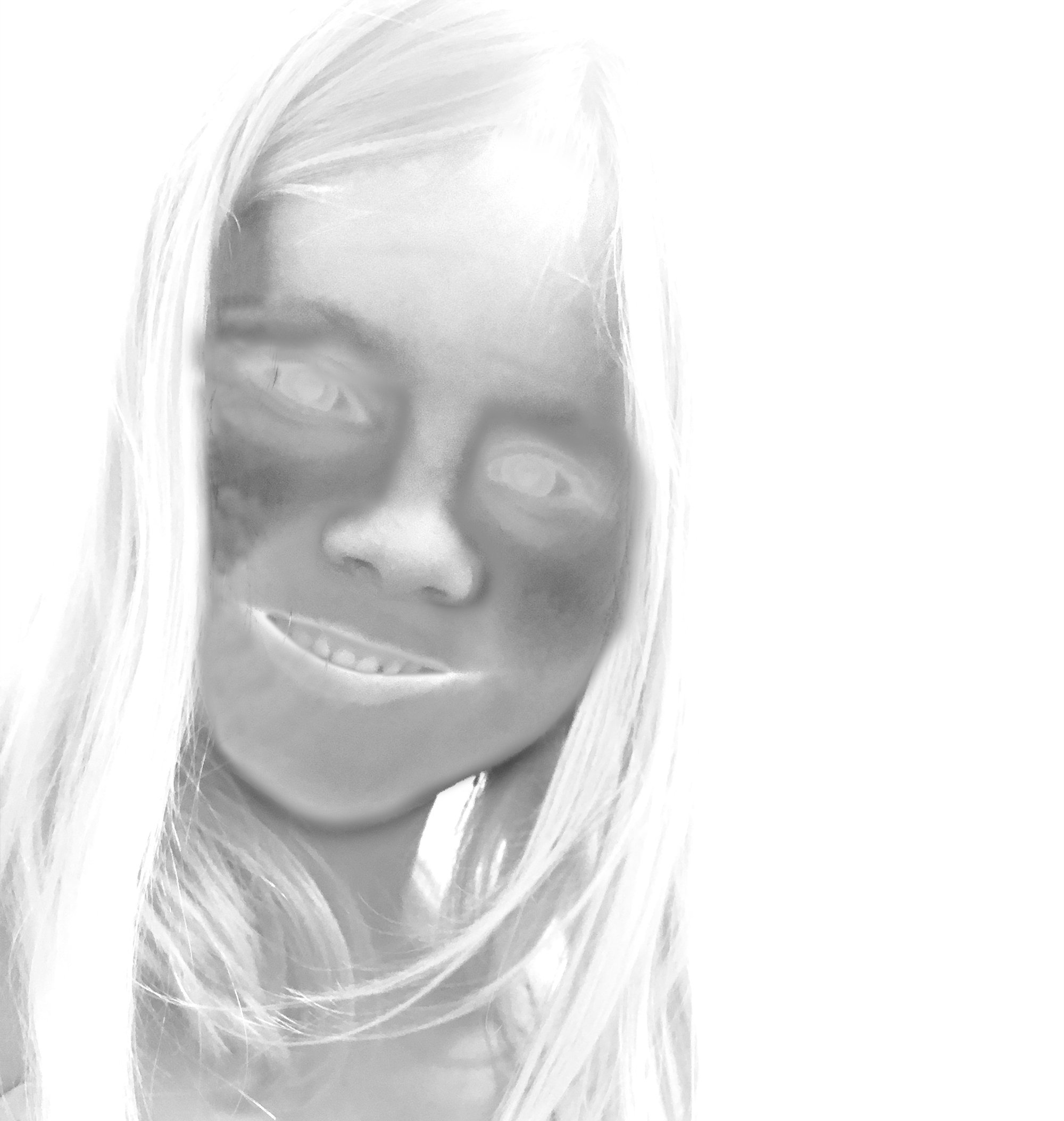

I'm on a mission......images like this without ArtCAM
I don’t really know what ArtCAM does/did but I’m sure it was more than just making images like the one below. However, I’ve found a load of sample images prepared like this (depth maps) and tested a bunch of them in ESTLCam and they work beautifully for 3D carves. However, I feel like I’ve exhausted my search for a magic "click this button and voila you have a depth map or 3d carve that will give you solid positive caving results. I’ve found oodles of the greyscale image based pixel height ones which are great…if you want a lithophane. I don’t, and the lithophane ones give you mountains where you do not need mountains - people’s teeth for example. Because they are white they shoot to the highest height. Add some dark lips and you have a bird beak, not teeth. Not even a really good starting point IMO.
Has anyone here found a good method for positive 3d carves that don’t involve thousands of dollars spent on software? I’ll keep reporting to this thread how I make out otherwise. I definitely possess the skills to create imagery like this on my own - but I’m thinking there has to be a better way than manually. Maybe I’ll figure it out.

Thanks! There is/was a function in Photoshop to create bump and normal maps but they still aren’t quite right. It’s specifically a depth map that we need for the “Photo to Code” functions. The difference is that blacks that are already halfway up the z depth can’t be blacks any longer - they need to be the 50% grey at the darkest point of that part of the image. I might be able to use the levels inPhotoshop after meticulously cutting up the subject into bits and pieces to set the max black/white for each layer of the image as I determine it.

It seems to function much the same as the others (where teeth and whites of eyes would jump to the material surface). I’ve built a sample ramp graphic that I think clarifies what I already understood and that is that I need to decide in Photoshop what layer of my image stays near the material surface and the details within that must fall within range of the depth reach of just that layer +/- one or two steps up or down. If for example the eyes go to black in the corners I need to bring that up to the upper end of the greyscale (20-40% I’m guessing).
Which means I literally need to cut photos into individual elements (eyes, nose, cheeks, hair etc…). Still working on this…
I wish I could find a better preview method but I’m making my way through. Parts of this image have been blown out, parts flipped to negative, parts within brought back to positive but blown out more still…

Ah crap…and now that I focus on the “next area to look into” I see her checks need to be flipped back to the positive…What did I say earlier? If it were easy everyone would be doing it? hahaha…sigh
Well, it’s not far off but it’s not terribly close either. The eye and cheek masses look okay - need to find a way to get better detail in the eyes. A finer bit or a third pass with some drawn details just a step or two darker than the surrounding greys. The lips did just what they were supposed to do - unfortunately not what my brain was thinking but definitely how the image was set up. Kinda impressed how the stray strands of hair crossing the face popped up and held.
This is 15cm x 15cm. Roughing pass took only 25 min - would have been quicker without the margin applied. Finish pass is only going to take about an hour. 1/8” ball mills.

The problem is depth maps are generated from actual 3d models, not 2d images. Most applications that create cut paths from 2d images are making them for lithophanes, which look weird when not backlit. For a lithophane, the darker parts will be thicker, lighter parts thinner, so less light, more light gets through the material.
I figure I’m still way shy of the mid point here in terms of effort - the aim being finding a way to do it without having to 3d model the photograph. While that would be the easiest way to get the file I need for the cut, the modelling process is not easy. For me at least…and I’ve been at it a while - just never had to model human faces - we could always get away with just loading an image onto the model.
