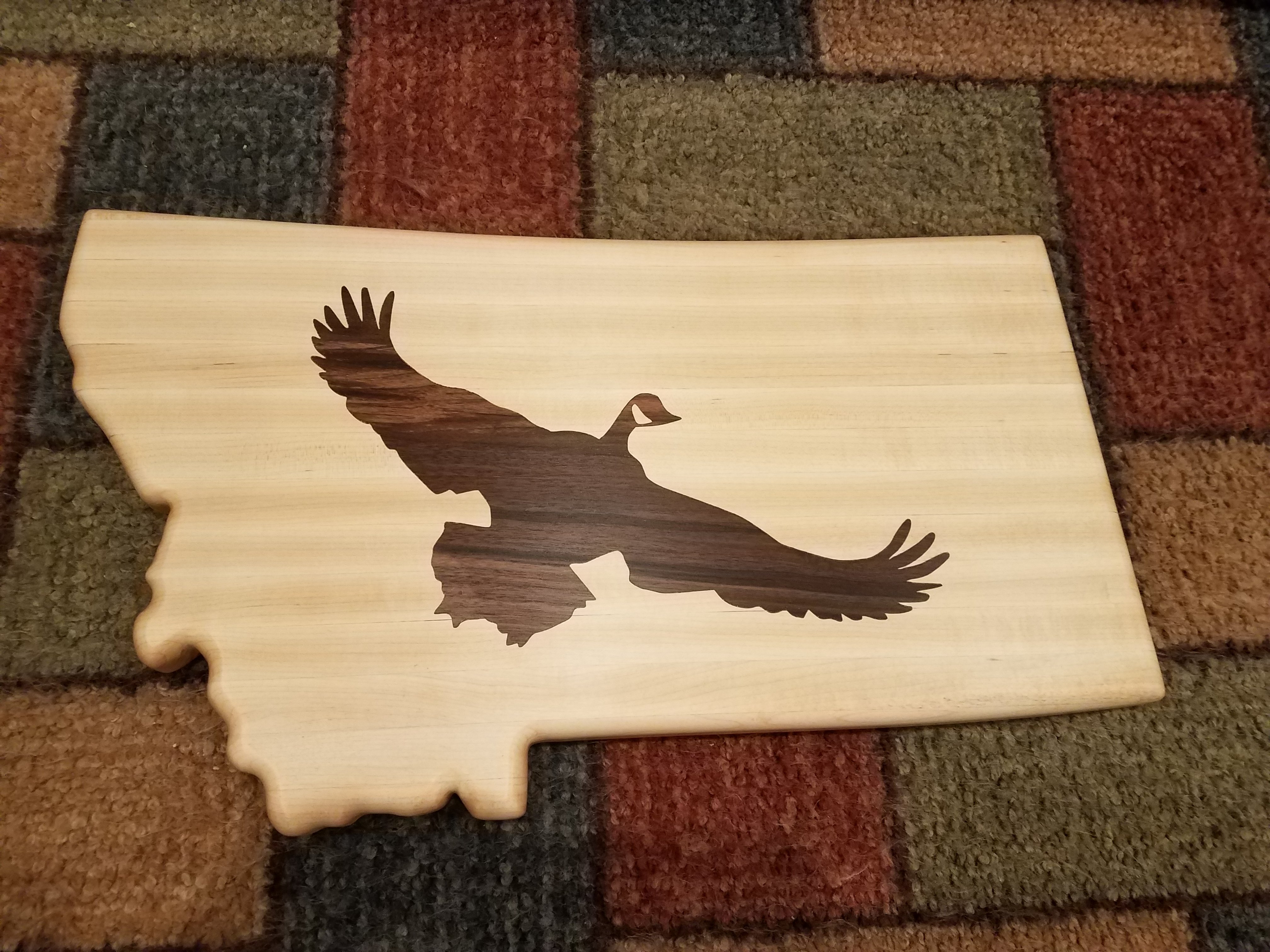

Being a beginner I would suggest keeping it simple to start with. Touch plates, end stops and dohickies are great ideas but not necessary to begin with and can be too much to take on all at once. Each moving part or connector is one more possible problem. Build a basic machine, figure it out then upgrade if you think you need to. There is a lot of cool things happening to this machine here but I think these people enjoy tinkering with the machine more they enjoy woodwork.
I run a basic MPCNC and can cut 6mm deep inlays tight enough that I need to press the two pieces together. I use a piece of foil tape and multimeter if I need a touch plate.
My biggest hurdle was finding and learning a program to create cut files, I found inkscape to have a wealth of tutorials on YouTube. These tutorials are geared towards graphic design but teach the basic fundamentals of using the program.
