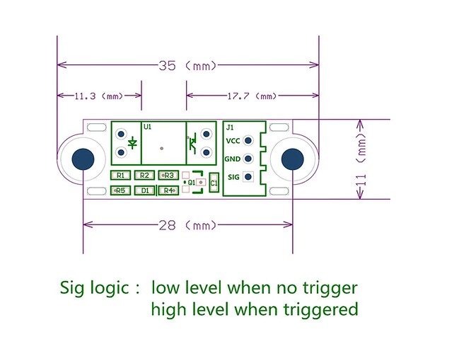

The optical stops, I had to get from Amazon:
MakerHawk 6pcs Optical Endstop with 1M cable Optical Switch Sensor Photoelectric Light Control Optical Limit Switch Module for 3D Printer
About this item
  • VCC: 2.7V to 5V.
  • The trigger is sensitive and quiet.
  • With high repeatability and no mechanical collision.
  • Using optically transmissive principles of design, no loss, no noise with a longer life.
  • SIG logic: output low level when there is no trigger and high level when there is trigger.How to trigger the photoelectric: Use the stopper to trigger the limit when it moves to the middle of the red contact groove (it is recommended not to use a transparent material stopper)
The Pinout looks identical to the one that is linked from the page where I purchased the control board.
It is def a Bart Dring Pen Laser board.
That would be these?
https://www.amazon.com/MakerHawk-Optical-Endstop-Photoelectric-Control/dp/B07PMW2QMT
And if so, the only documentation seems to be:

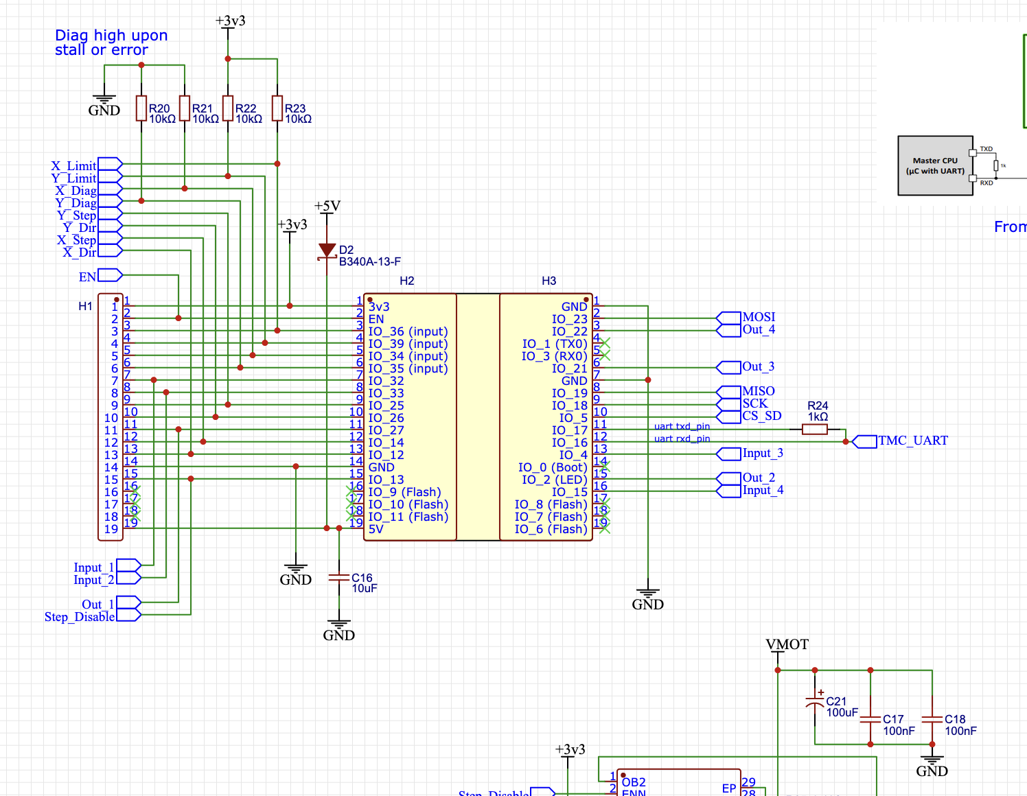

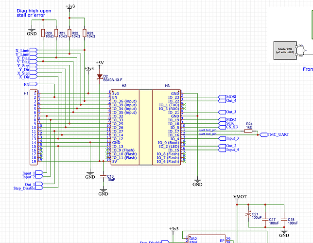

Looking at the schematics for the Bart Dring Pen/Laser board, the X and Y limit GPIO inputs are pulled up to +3.3V.
So, I wouldn’t hook these optical endstops directly up to +5V for Vcc. I don’t see a 3.3V output on any of the pen/laser connectors- so this needs a little thought. Perhaps a series resistor (something like 10K ohms) might work. I need to think about that.
For reference- this section of pen/laser schematic:
confirmed, that’s the ones. I’ll stand by for thoughts on the end stops.

Honestly, I would just connect them to 5V. The “right” way to do it is to use a logic level converter. But in my experience, the esp is pretty robust to this kind of thing. If it were to put anything at risk, it would be the ESP, which is a pretty cheap part. I have enough on hand that I would risk the $5-10 ESP instead of buying some $5-10 logic level converters (until I killed one, then I would protect the second).

I’d connect the endstops Vcc to +5V (Maybe with a 1K series resistor), and then connect the signal pin to the endstop inputs through a 10K or maybe a 1K series current limiting resistor.
Less likely to blow up and ESP-32.

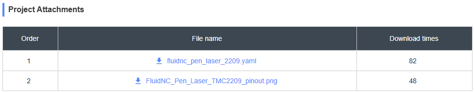

When I was poking around, I saw that the FluidNC Pen/Laser CNC Controller TMC2209 from Bart Dring on Tindie links to this source FluidNC Pen Laser TMC2209 Drivers - EasyEDA open source hardware lab (oshwlab.com).
which includes this yaml file:
fluidnc_pen_laser_2209.zip (1.0 KB)
