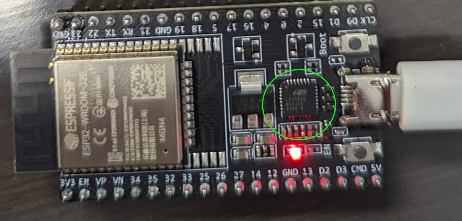

I'm curious and learning, how do I load the software onto the control board?
The easiest way is to first identify what chip you have on the ESP32. Tell us exactly what labeling on the USB/UART chip says. It will either be something like CH340 or CP-2102.
It’s the chip I’ve circled in your photograph from above.
If it is the silicon labs (CP210X family, then you likely need this driver
https://www.silabs.com/documents/public/software/CP210x_Universal_Windows_Driver.zip
from this page that @Dreyfus linked/mentioned up above.
If instead, it says CH340, then you need a different driver. (I suspect you don’t have the CH340)

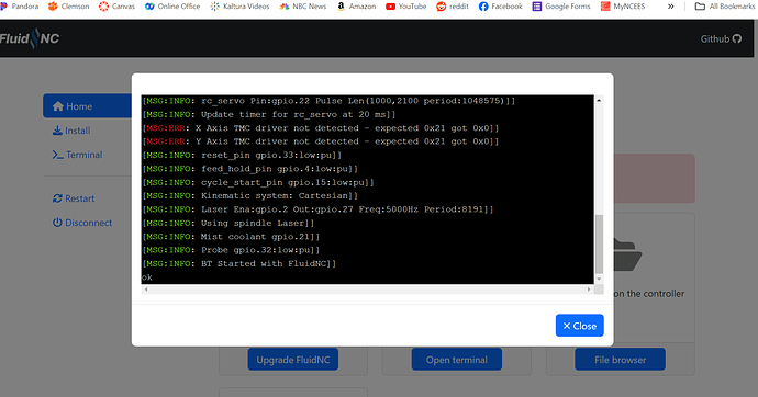

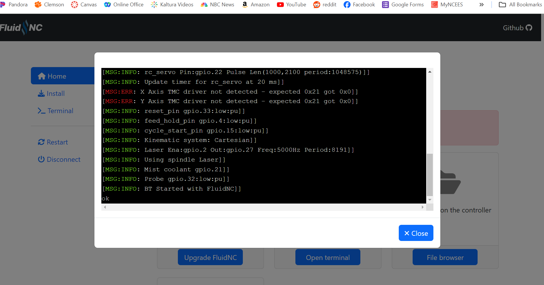

massive improvement, it installed. Got a report:
You’re well on your way now.

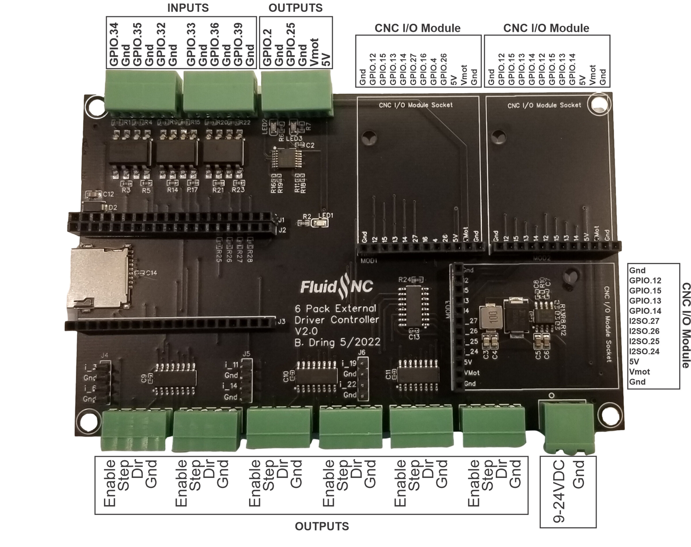

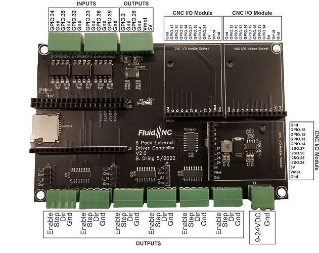

We might need some help from @jeffeb3 or other ZenXY experts as your Bart Dring 6 pack is a little different than the PenLaser or Jackpot boards.

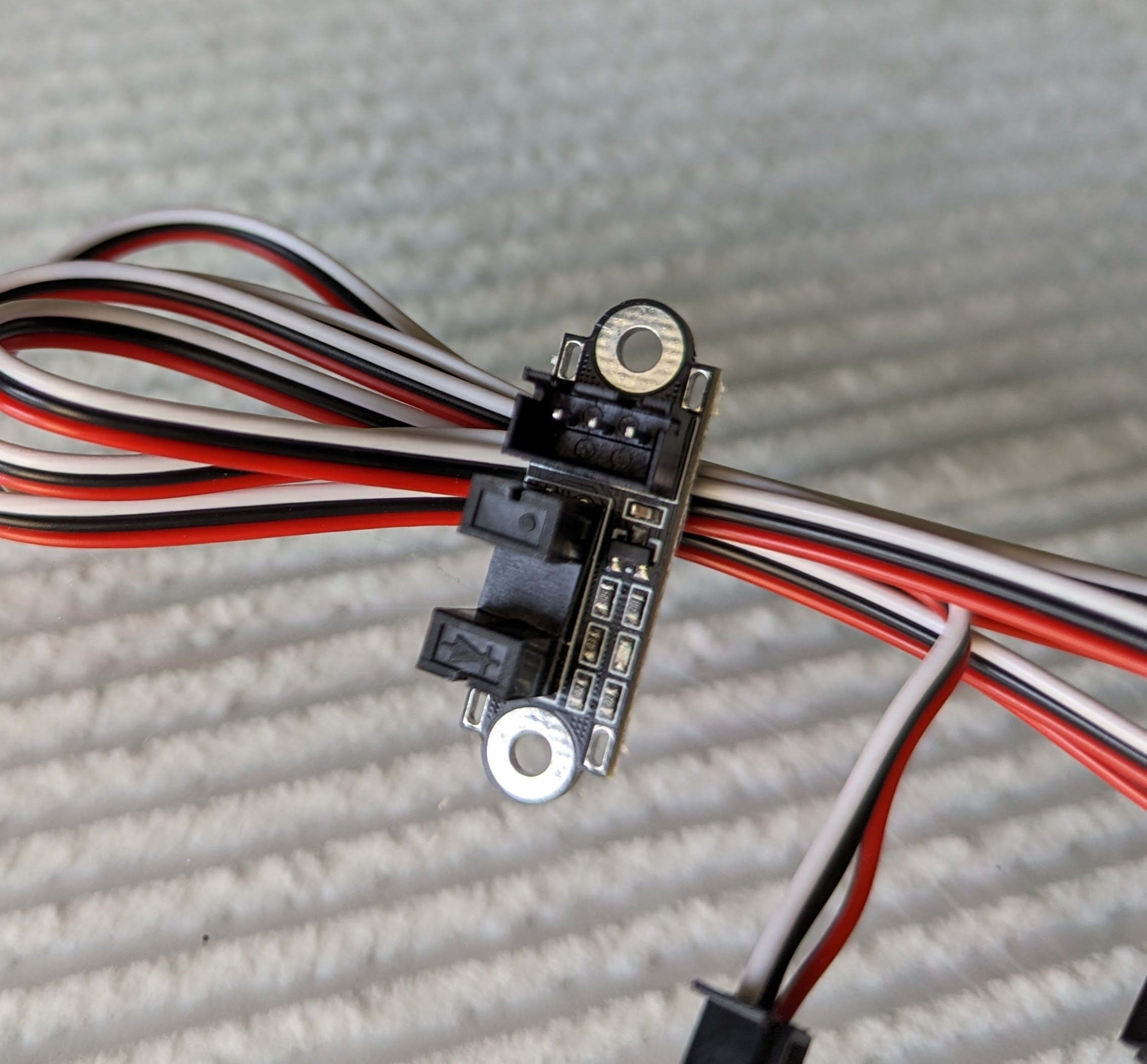

If you have any idea which pins the two optical stops should be connected to, can you point me in the right direction?
Optical stops, or just microswitch endstops?
Optical endstops are a bit more tricky as they usually need power for the LEDs.
If they’re mechanical endstops, I’d suggest the GPIOs on the 6 pack. I’d start with the top left corner and work in. Don’t hook endstops up until we confirm how to connect them correctly to a 6-pack.
Also, which optical endstops are you using? Have a model, link, or picture?
The Zen has flags and mounts for optical endstops.
How do you normally wire those up to jackpots or penlaser boards?
I haven’t tried the jackpot. But I believe I wired the 5V separately. Or maybe it was 3.3V? I’d have to look it up.

I checked the V1 store and there isn’t any data sheet or wiring data for the endstop that Ryan sells
It does note that VCC can be 2.7 up to 5V for that part, which is nice.
I would propose picking up 5V and Gnd from the output connector on Bart’s board , making a “Y” with ferrules so two wires would come from 5V and two wires from Gnd on the outputs connector.
I’d run separate wires for that 5V and GND individually over to each optical edstop VCC and Gnd.
The 3rd optical endstop pin on each endstop would then get run over to inputs. I’d use GPIO.34 for one endstop and GPIO.35 for the next.
To make any further progress on this, I need the data sheet for whatever optical endstop @LosTyger is using in the ZenXY build. That would allow me to confirm the notes above.
Definitely worth finding out the right info and updating the docs.
The reason I thought 3.3V might be better is I bet the optical endstop outputs Vcc. I’m not sure if the endstop pin on the jackpot is supposed to have 5V input. The esp is 3.3V. but it is pretty tough. I’m not sure if there is a resistor or other protection on the endstop input.
Got it. In the case of Bart’s 6 pack above, these look like buffered inputs- so that should be OK.
I need to confirm this.

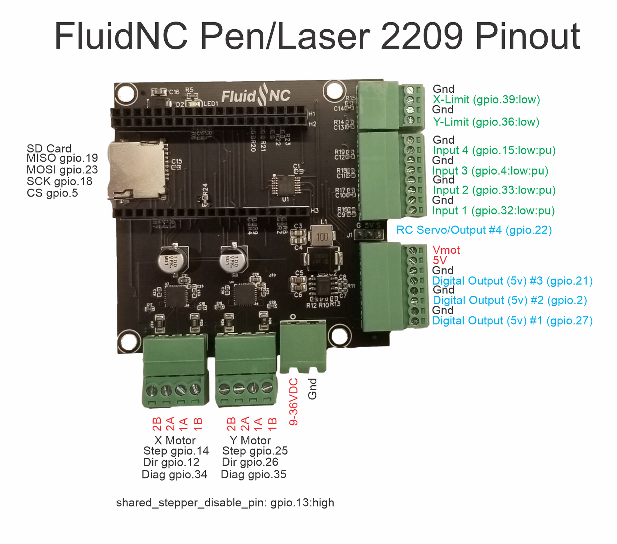

@LosTyger - The picture you posted above- that’s not a 6 pack board, I think it’s a pen laser board.
Can you confirm that for me? I need to be sure I’m giving you good information about how to hook up your optical endstops.
Edit: Still want to confirm- but it does look like the Bart Dring pen/laser board.
IO map would be as shown below:
Picture above is correct.
